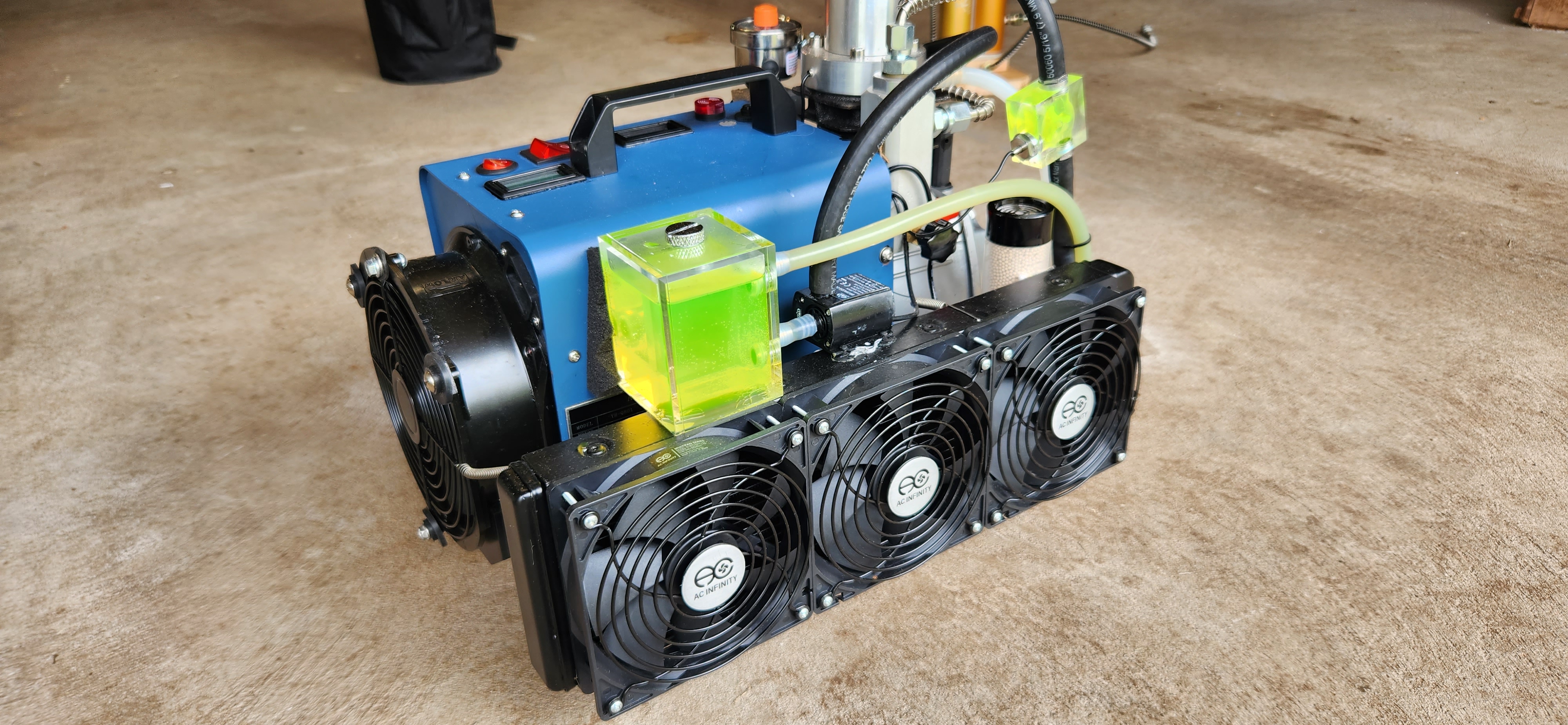

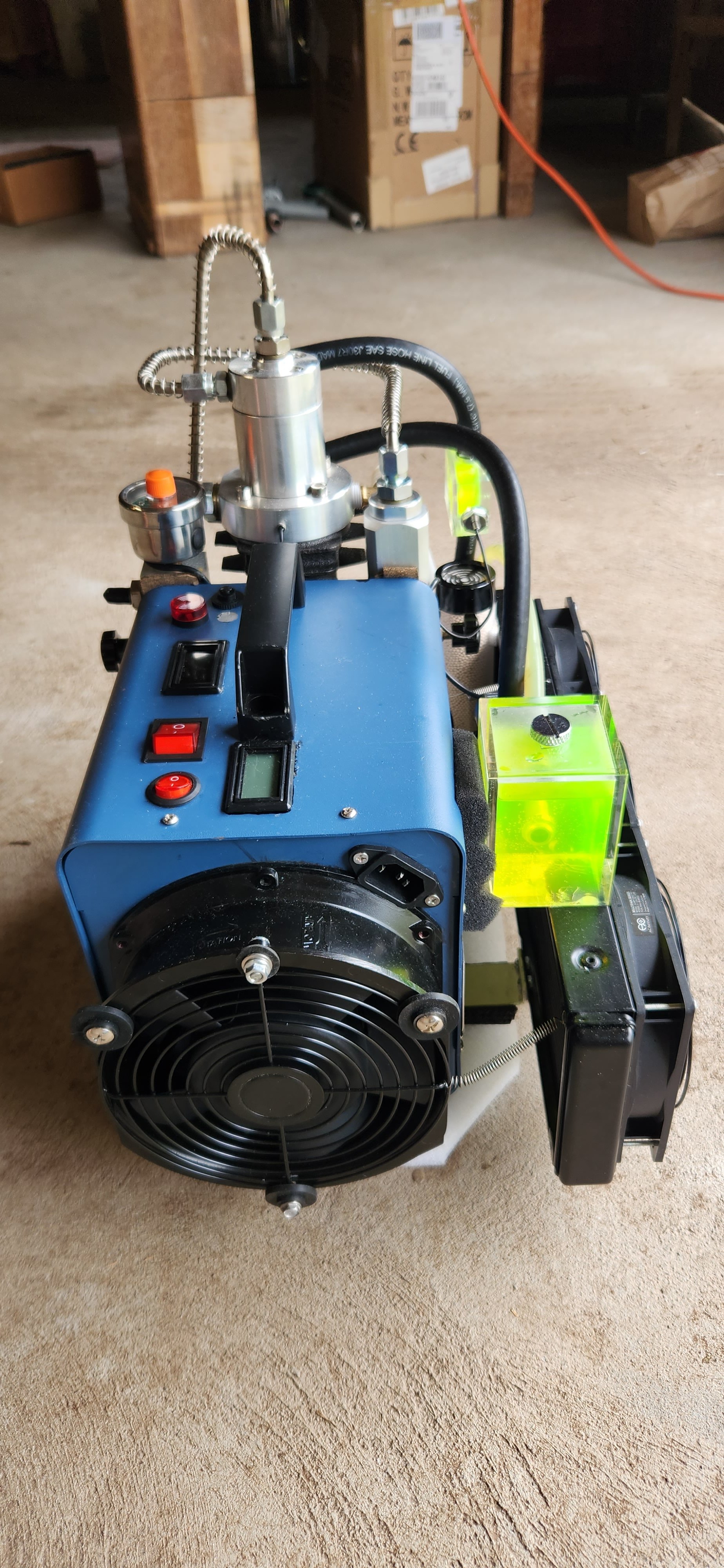

I just refilled my 45 minute SCBA bottle from 3200 psi to an indicated 300 bar today with my YH. It ran for 20 minutes. The head temperature jumped up over 50 C in the first 5 minutes but never went above 61 C. I did not use any ice or change the water. I have a computer radiator on the water, however, with a couple small fans on it and also a fan on the YH motor. Ambient in the area of the house where I keep the YH was about 30 C. I keep the YH bucket closed and I do not change the water. It has water wetter in it.

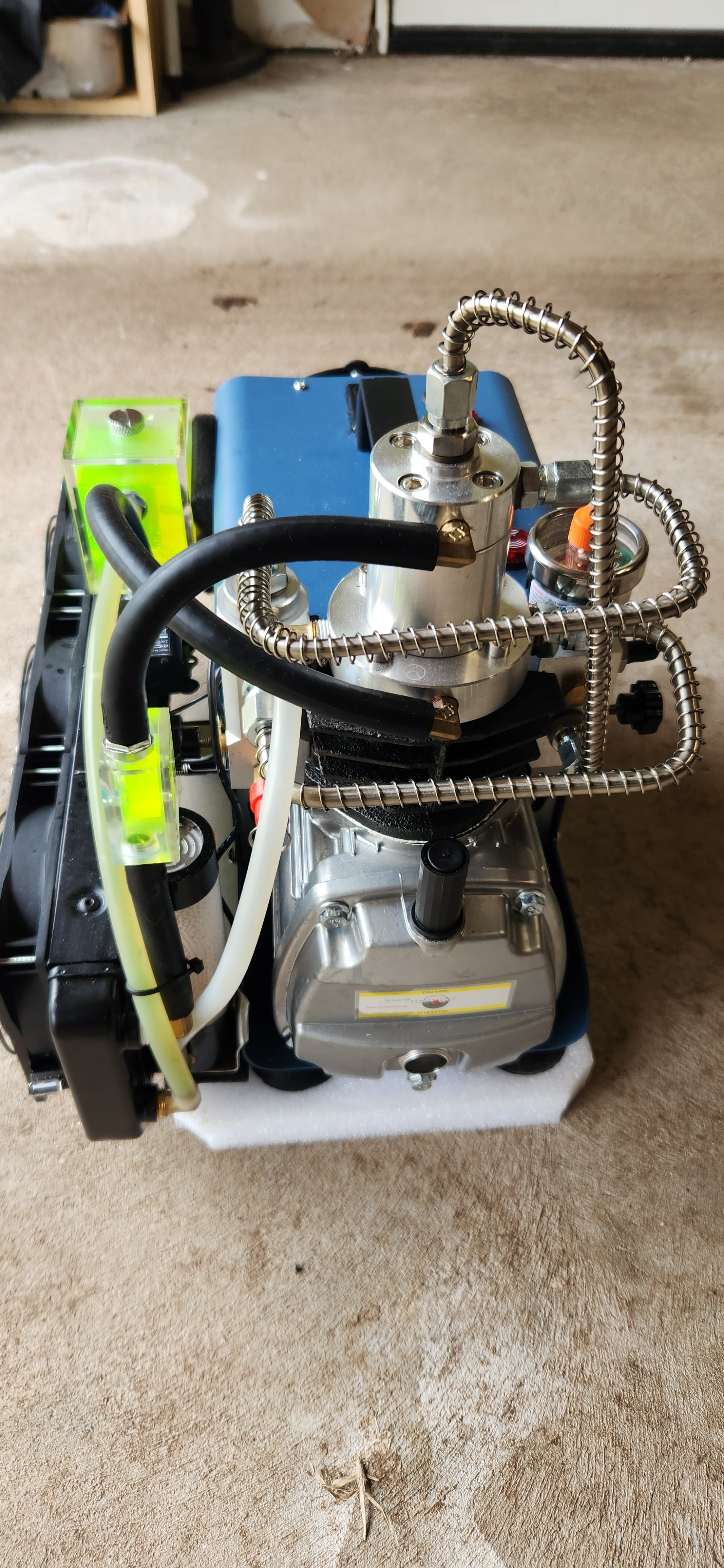

I know it’s been done before by others, but I wound my final steel pressure line tightly with copper wire to act as a “heat sink” for the hot zones.
It made the end go from “burn your skin hot” to just relatively warm to the touch near the pump output block.
I wound it before the compression fitting went out on me, so I ordered a whole new line set. I will be wrapping all of them when the thing goes back together and post my results.
