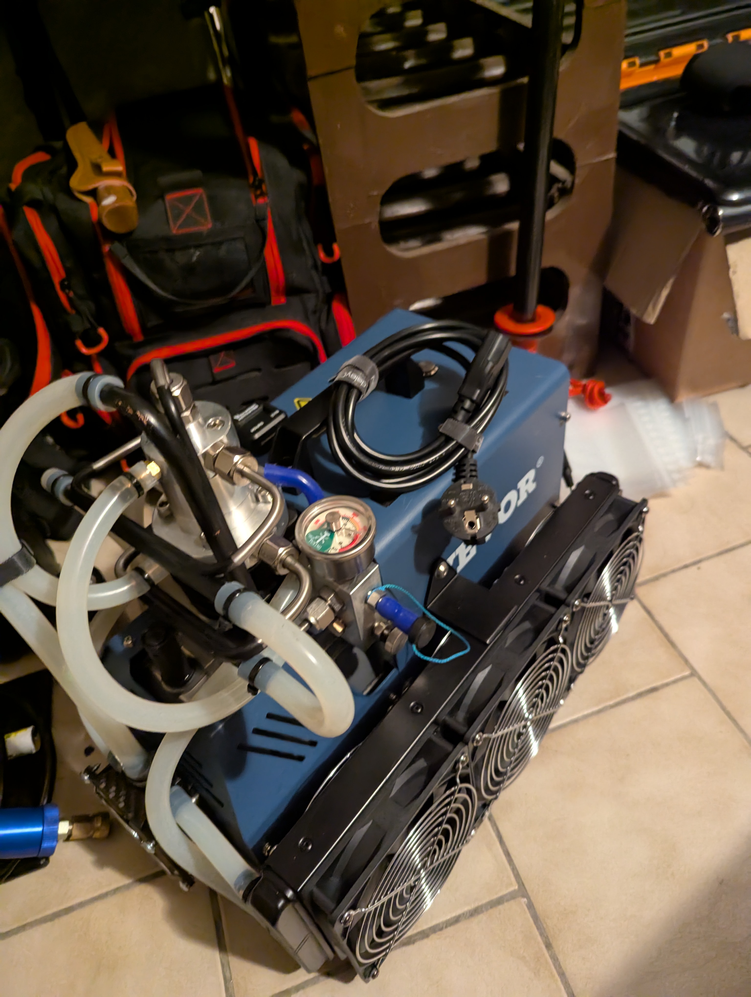

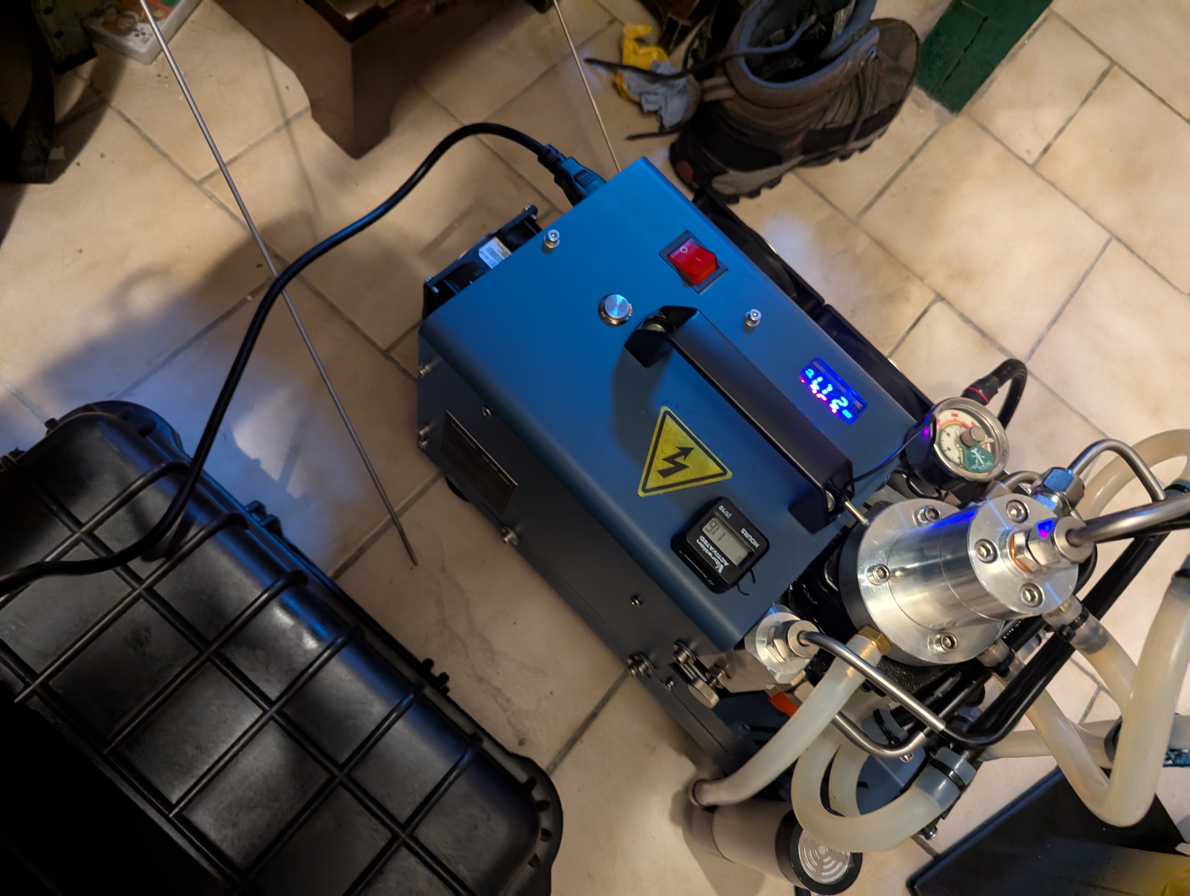

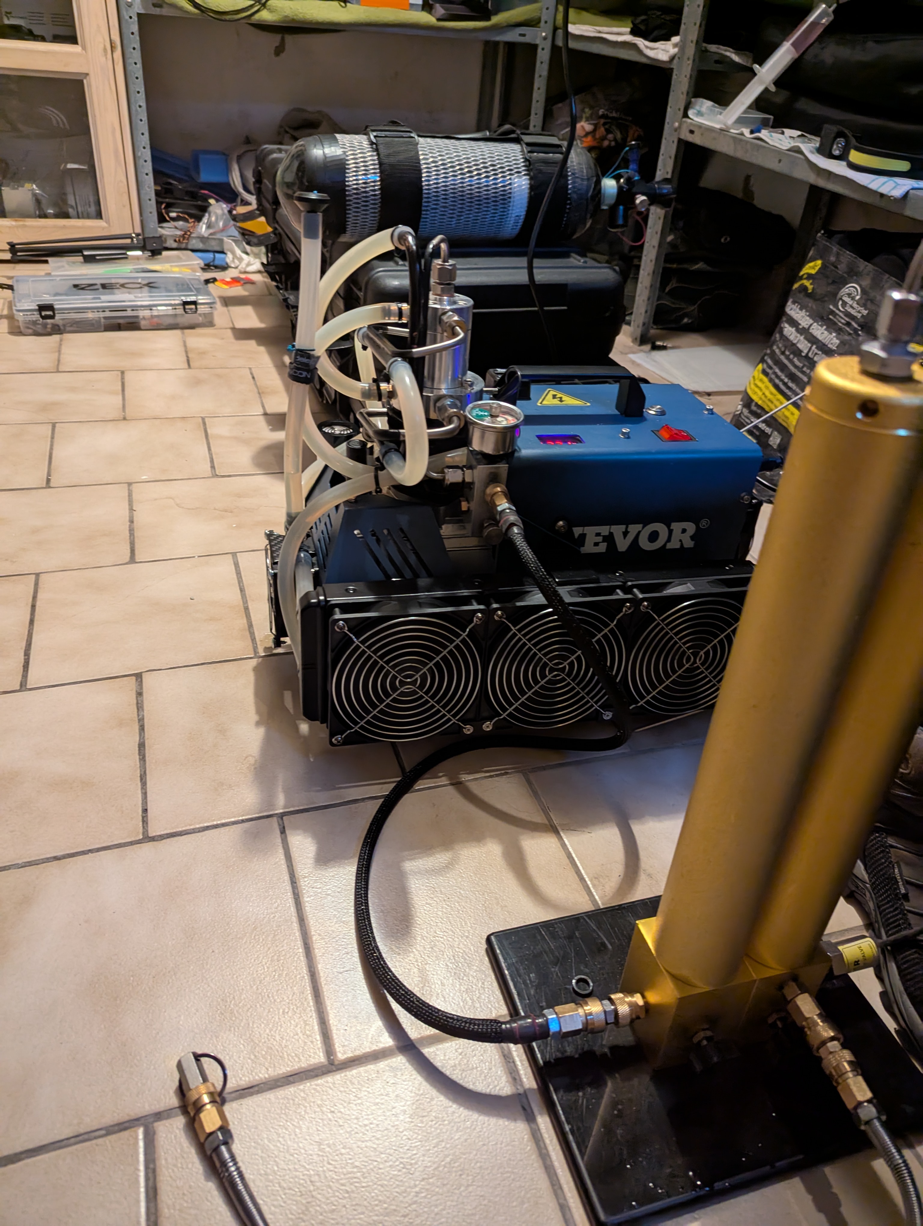

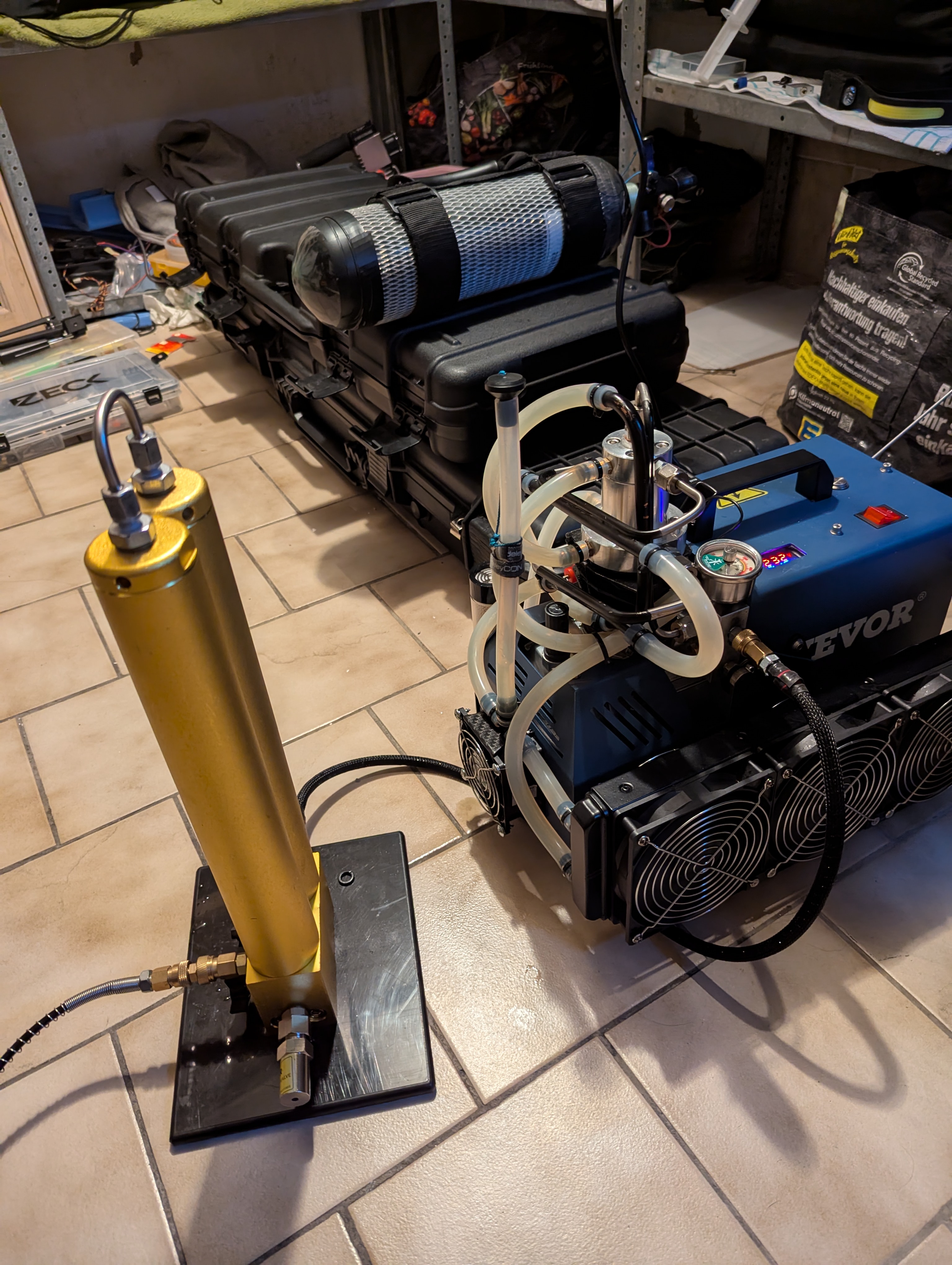

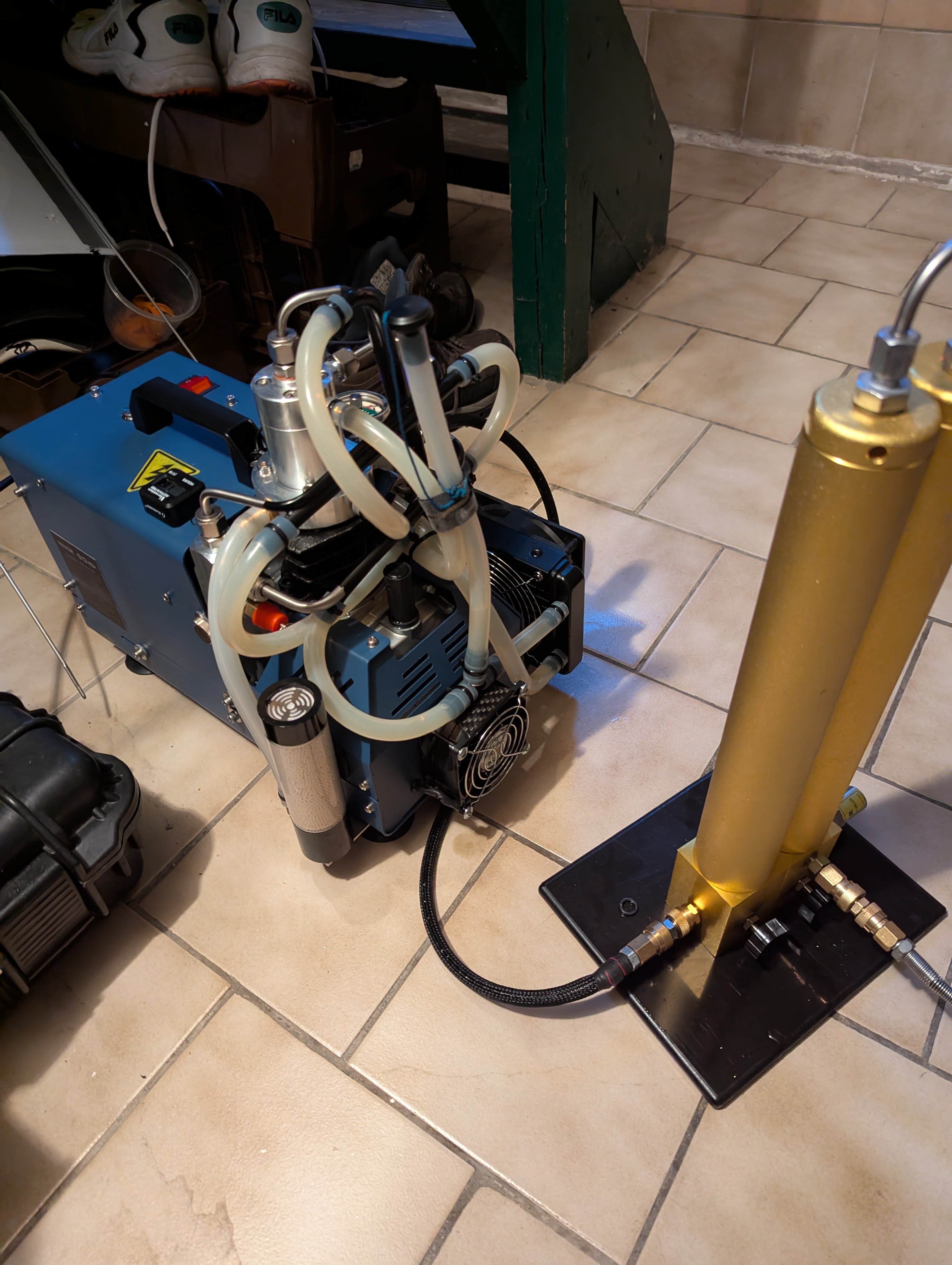

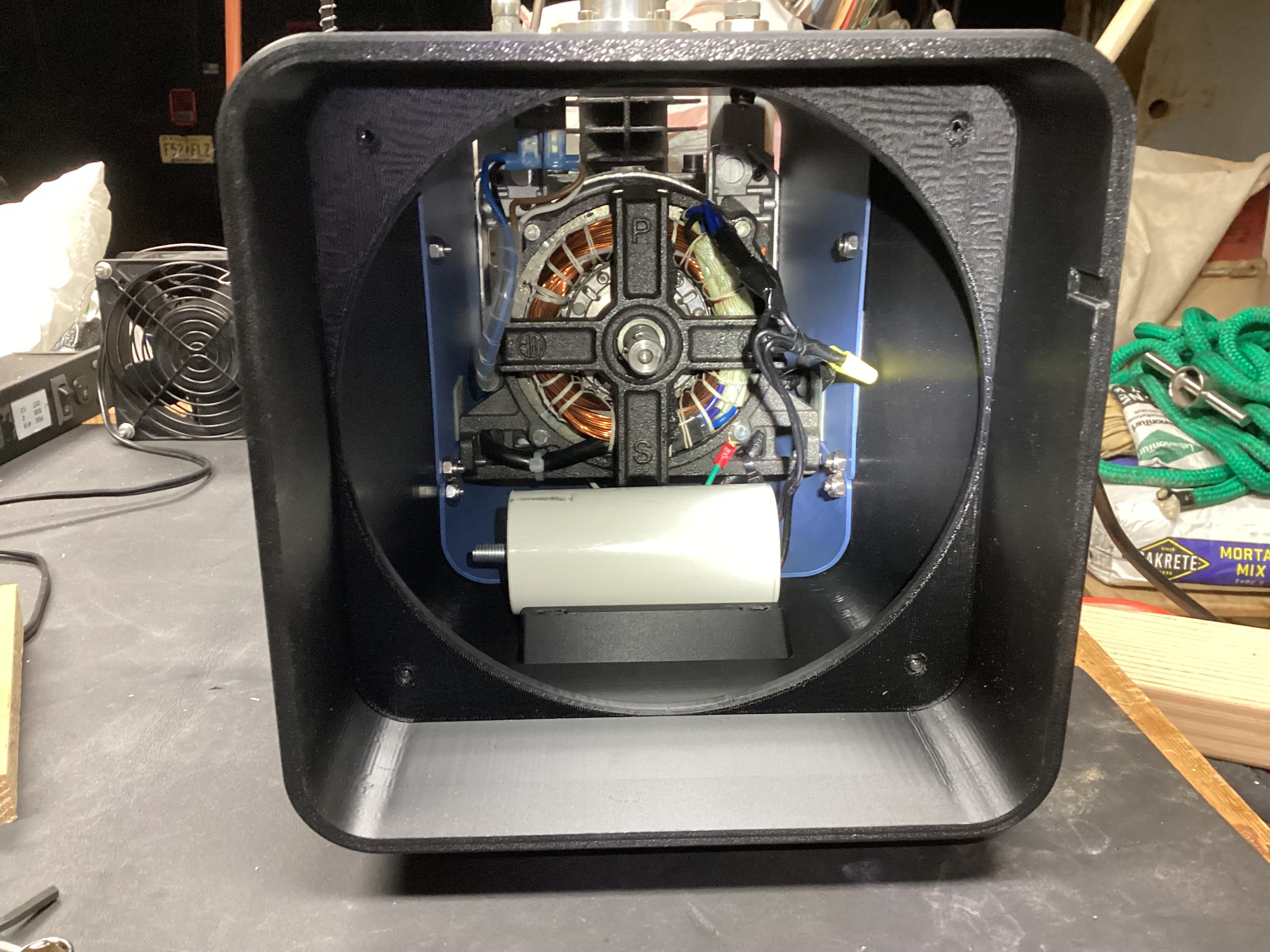

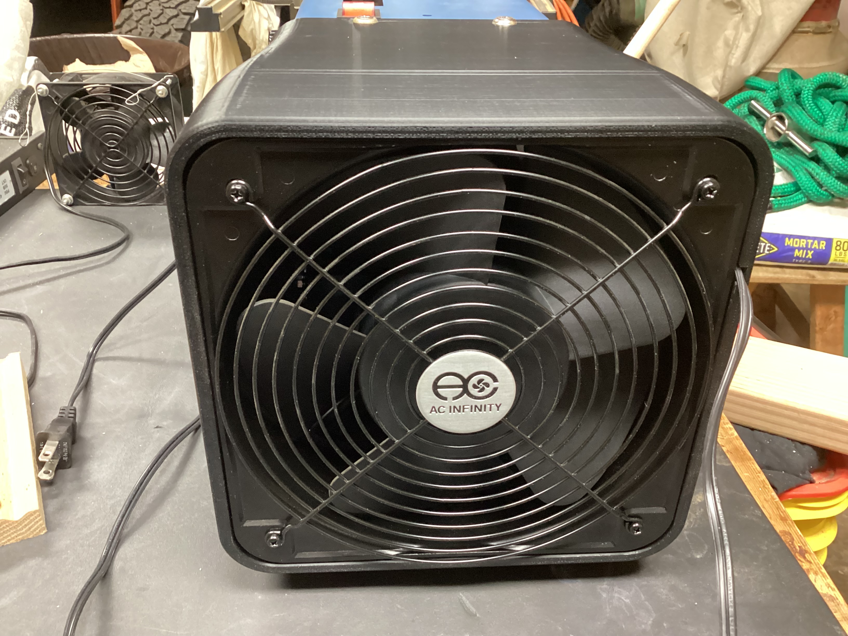

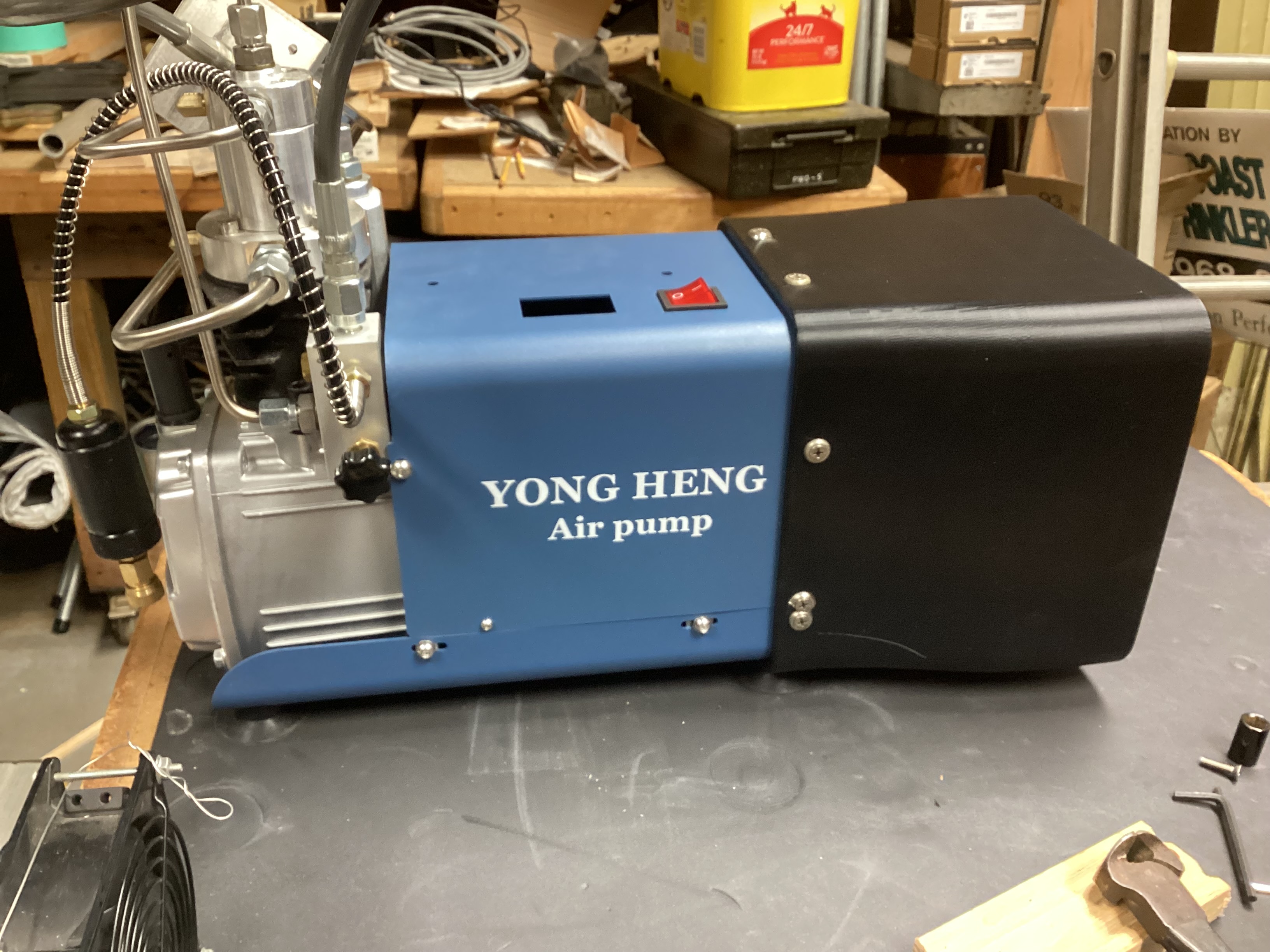

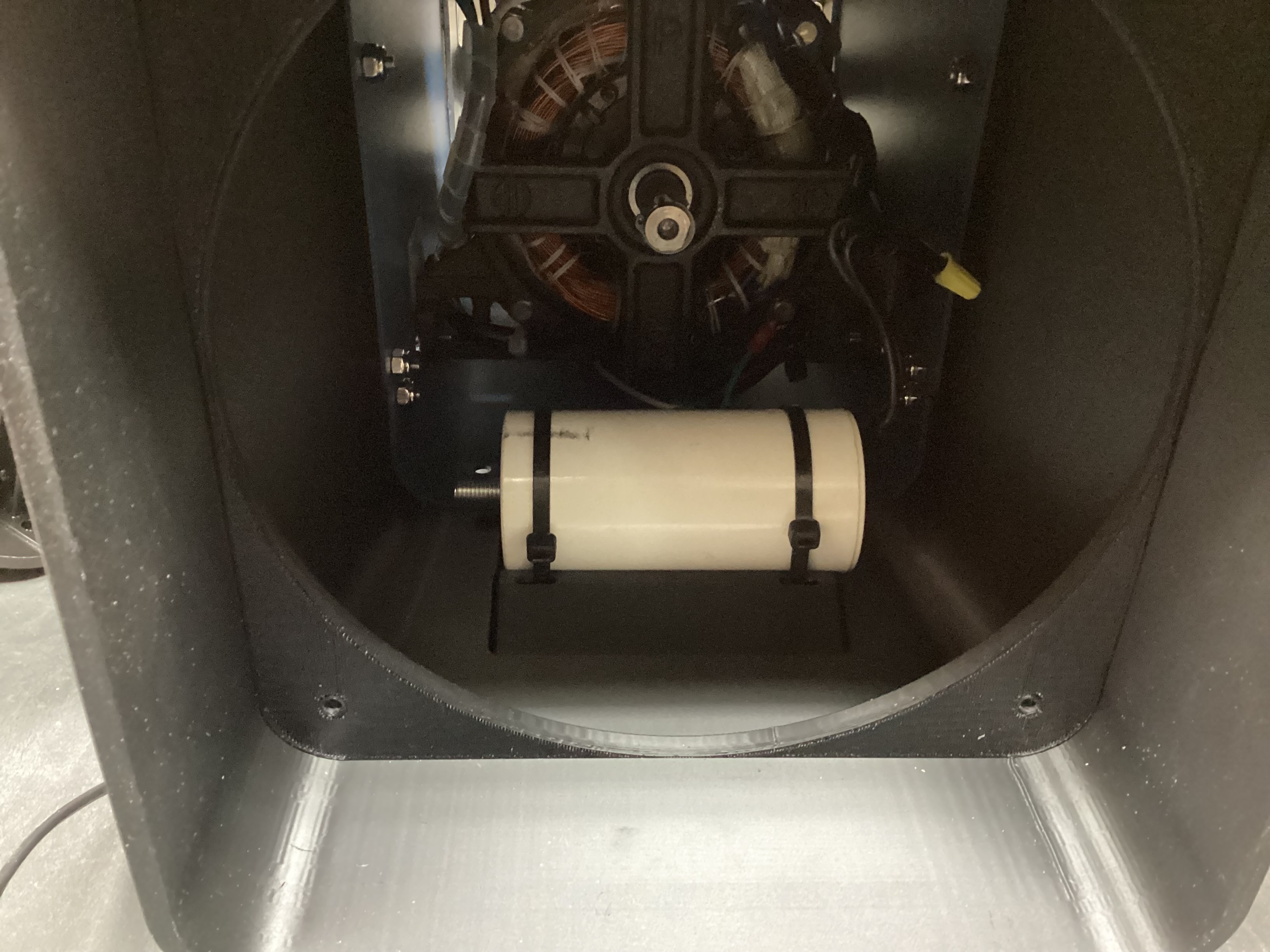

This is my final product. When I fill bottles, I use the separate oil/water separator. I didn't mount it on the compressor to keep everything mobile. The VEVOR sheet metal housing is more suitable for cooling the oil.... YongHeng has installed better high-pressure valves.....so I make a clone out of a clone👌
Reactions: airgunner53
The background of my work is that everything remains mobile without much effort. The large separator is also only used for bottles, so it is not mounted directly on the compressor. Unfortunately, most conversions are often pure handicrafts, which exclude any mobility, ...... neither compact or mobile, you can also use cheaper buckets). My create reaches max 36 degrees when filling the bottle and can conectet wherever 220volt is here in Europe. Easy to use and safe
