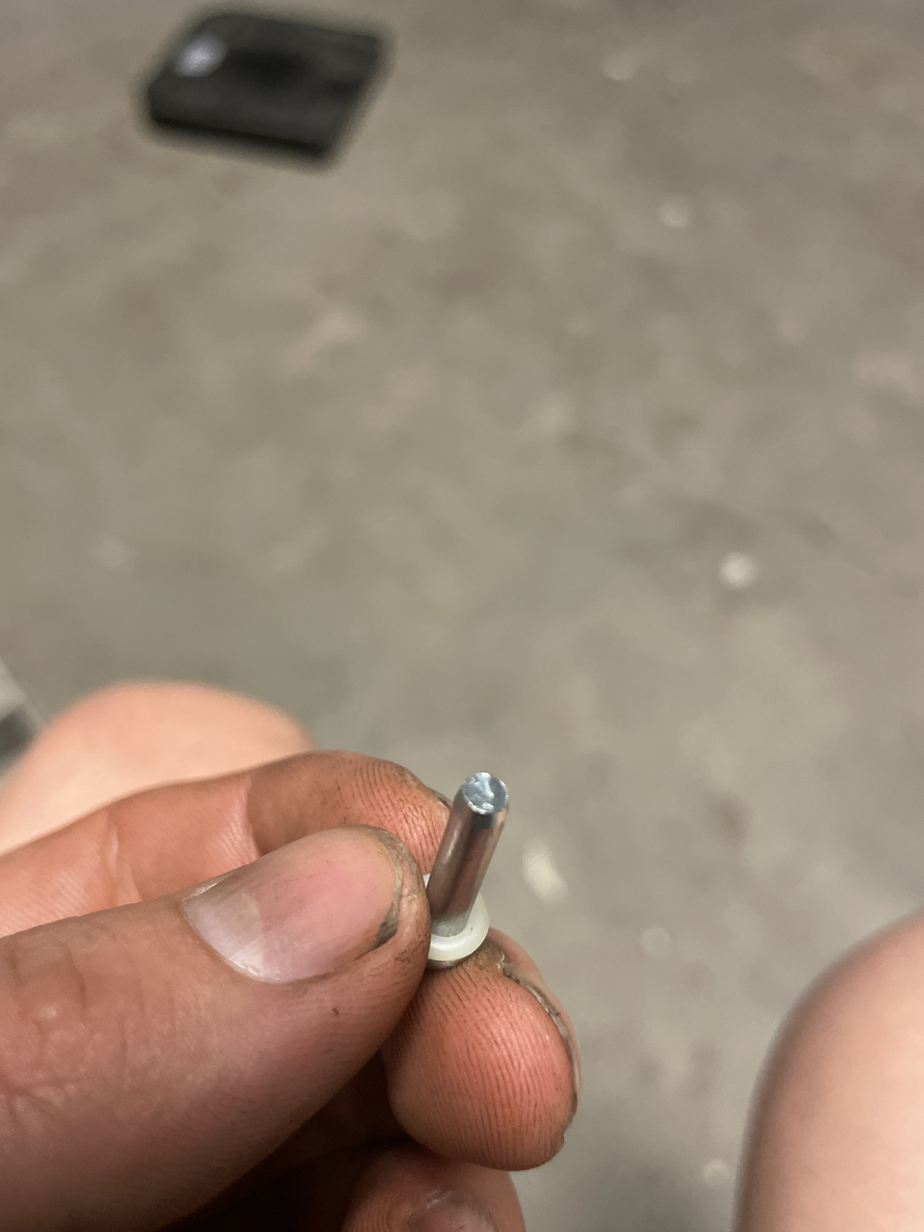

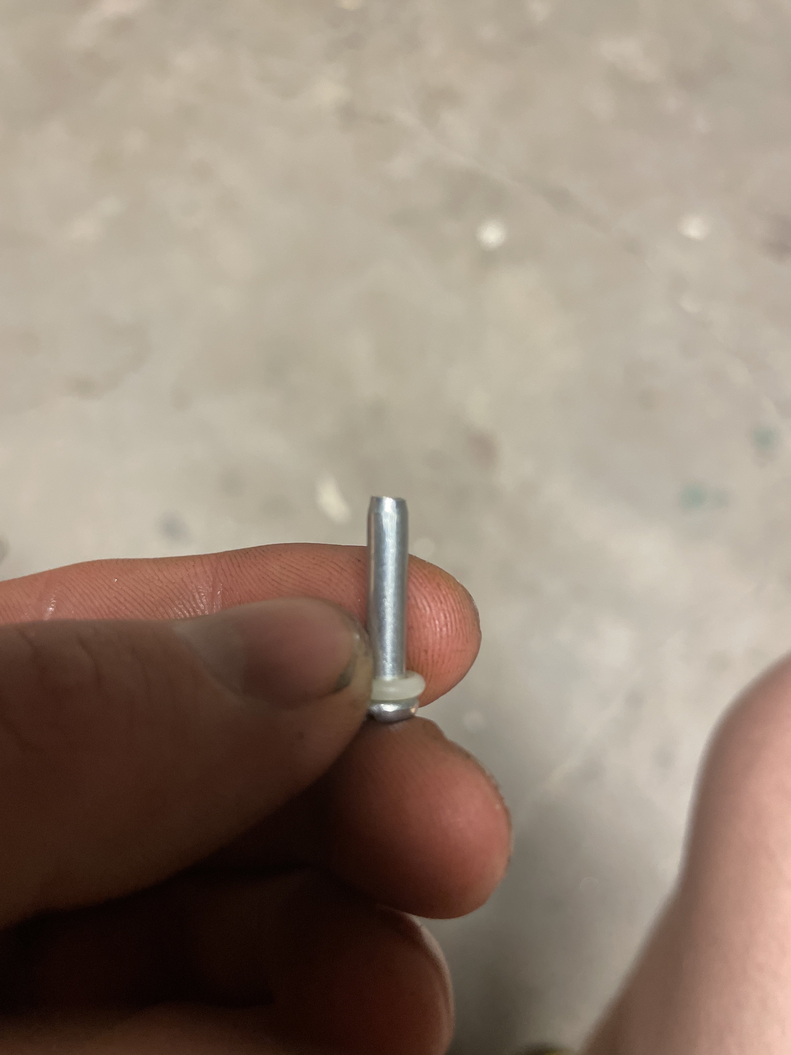

Yes Scotty is right, I’m connected to the fill port no the regulator. I will take a look at that fitting
I could be imagining it but I looks like the stem inside the fill nipple has a small chunk taken out of it. Could that be causing my issue?
