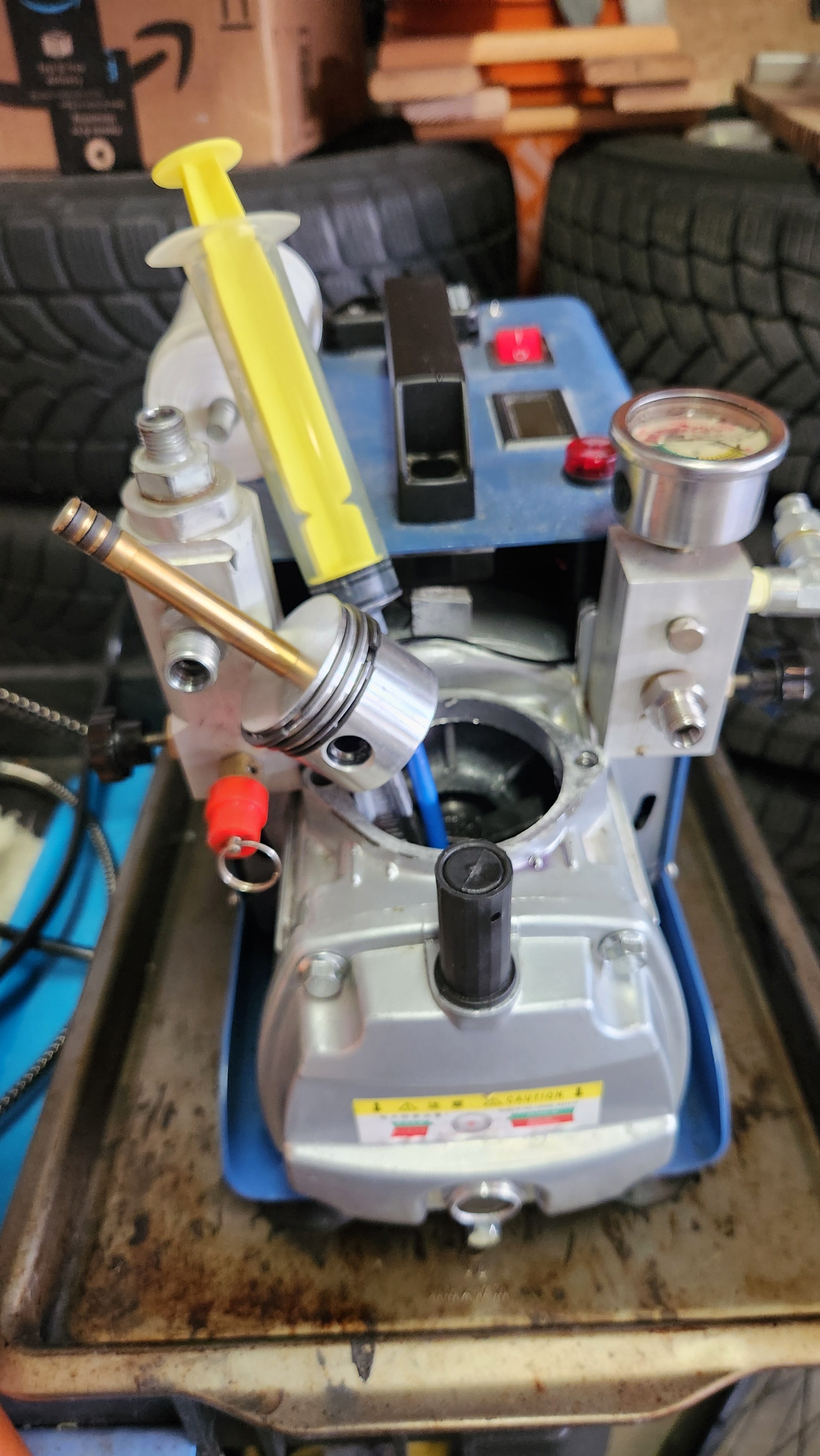

Yesterday I managed to seize that piston rod. Oh well, I have one new full assembly (first and second stage) on order from aliexpress, ETA 2 weeks.
Today I toke it apart, replaced the cylinders/pistons with one already used earlier years but refurbished the second stage diy and in good shape.
I saw the seizing left some scars on the "crankshaft" rod clean it with 1500 sandpaper, put all together and crank it up.
And seized again. !@%
I will need to replace that "crankshaft" now. I read somewhere back in time that the thread is opposite to brake it loose I shall do moment of inertia ClockWise. Never replaced that one before, is it sitting on a cone or cylindrical with keyway? I will try to polish it until next aliexpress order.

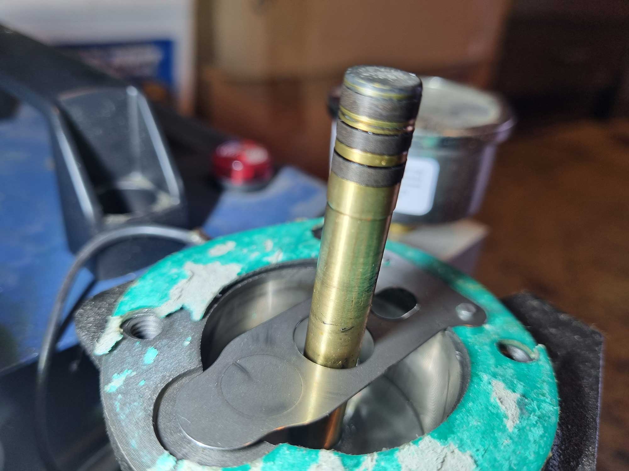

Piston rod seized, this is a second time. I tried to sandpaper down the surface but looks like didn't help.
Have a spare pump for parts whenever needed, any idea how to take this crank shaft out without some specialty tool? The screw I brake loose but cannot pull it out.

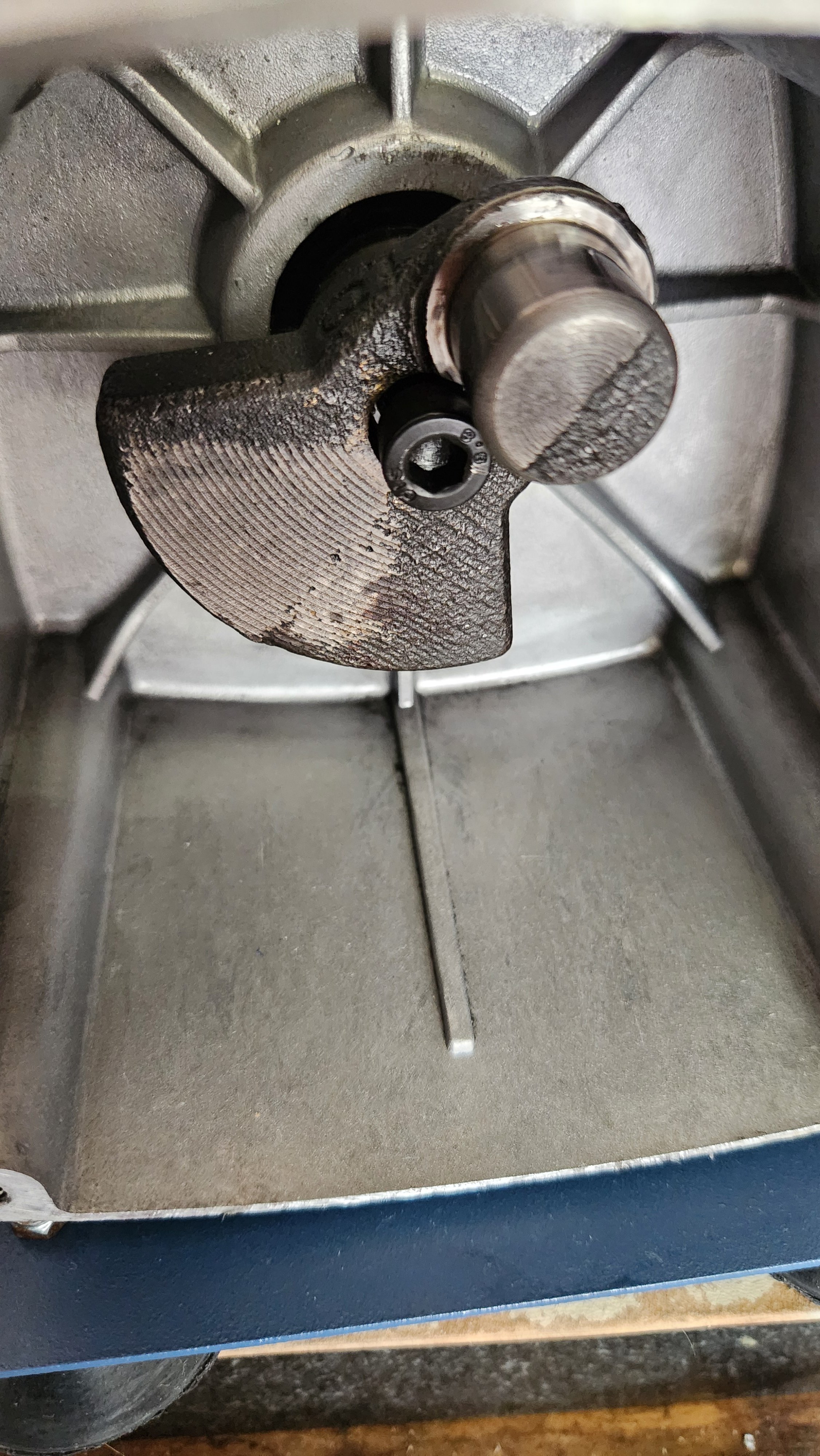

...I notice there is no “dipper” on the bottom of the crank, did it break off, or did it not have one?
the dipper is on the bottom of the piston rod (not shown in picture).
My best guess... the plastic spacers (I repeatedly put them in from the very early YH's 2020) shall not be on the dowel.

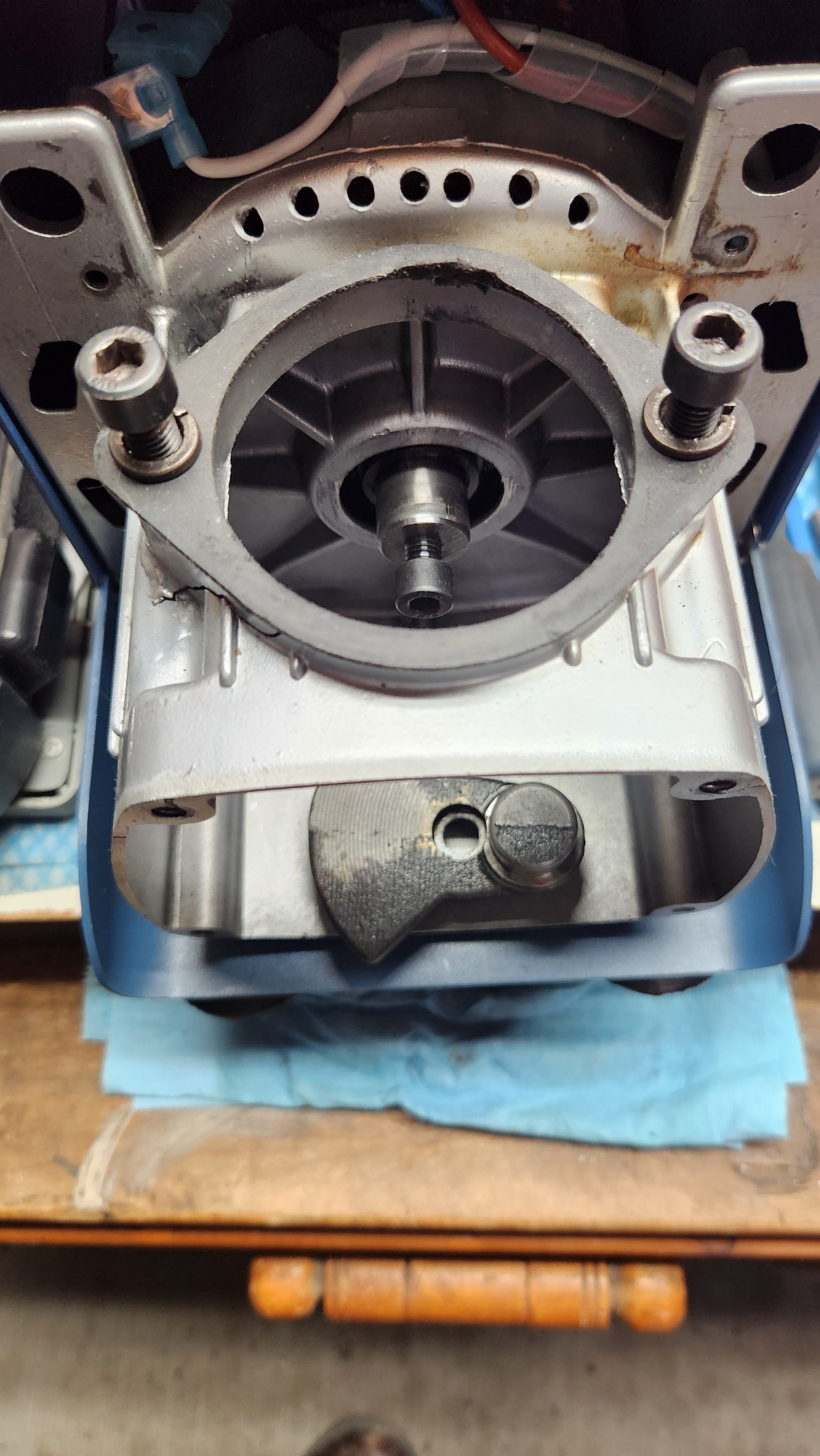

Today removed the oil and pan again, and with some tinkering finally managed to pull out that crank piece. I removed both the damaged and from my spare YH as well (this pic below) where I am scavenging parts in emergency.
I have two pistons refurbished but both piston rods damaged/seized and can't re-use, need to wait for a new full kit to arrive ETA next week.
