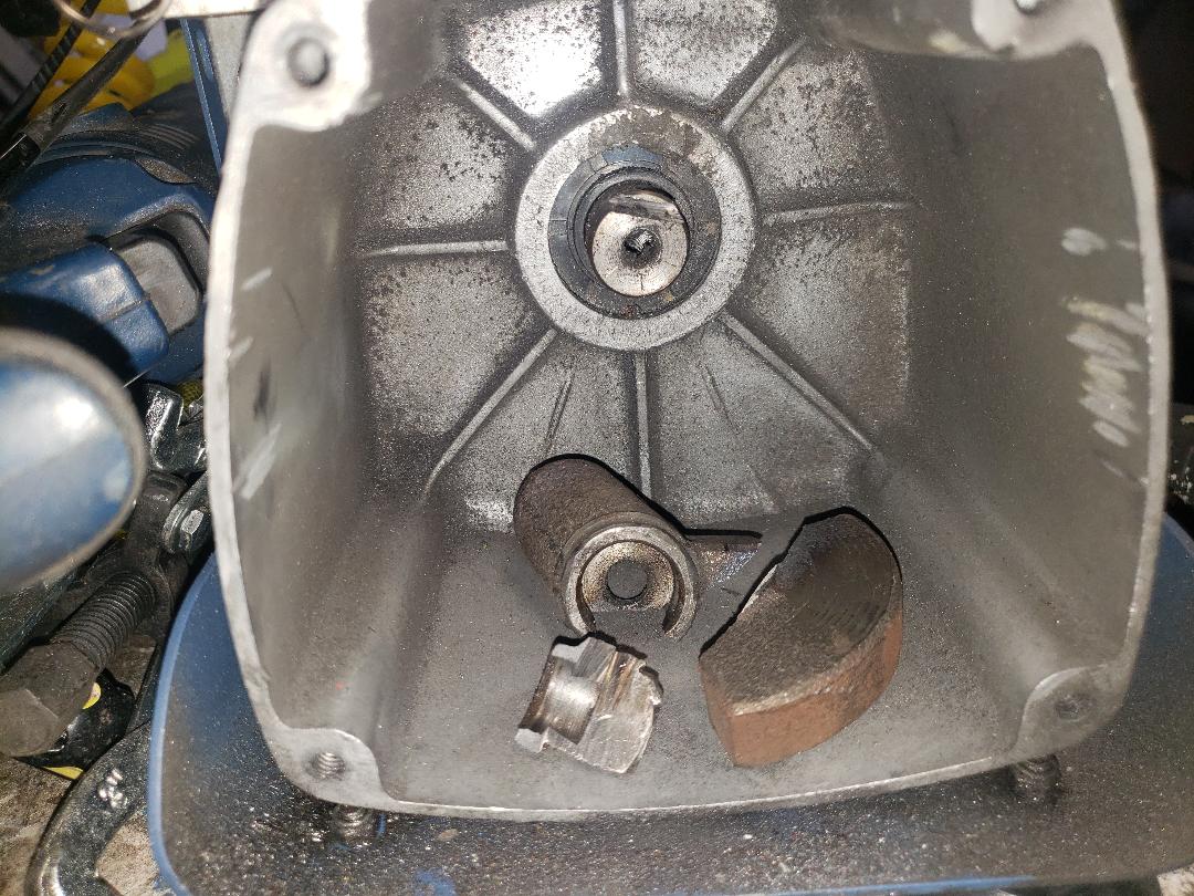

I ended up removing the crank with my angle grinder.
How did you end up removing the crankcase from the crankshaft? I am in a similar situation as you. https://www.airgunnation.com/threads/yong-heng-crankcase-swap.1306944/#post-1681246
The thing is I have a different counterweight. Mine slides over the crankshaft and is clamped to it via a bolt perpendicular to the crankshaft. This bolt tightens the counterweight down on the crankshaft.
My difficulty lies in removing the crankshaft from the motor assembly. Any suggestions are helpful as I am stuck.
Edit: I unstuck it with a board and a hammer. The crankshaft slides out of the crankcase after you remove the counterweight.
