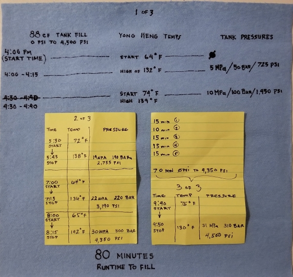

I used my Yong Heng 110v compressor to completely fill my 88+ CF carbon fiber tank from brand new / zero psi to almost 4,700 psi.
Mine used just the small oem oil/water separater, a 5 gal bucket of water [which I periodically added frozen 2 ltr bottles to - to help aid cooling]
I jotted down all of my run-times [starts, stops, breaks, as well as pressures and temps] It worked flawlessly!
