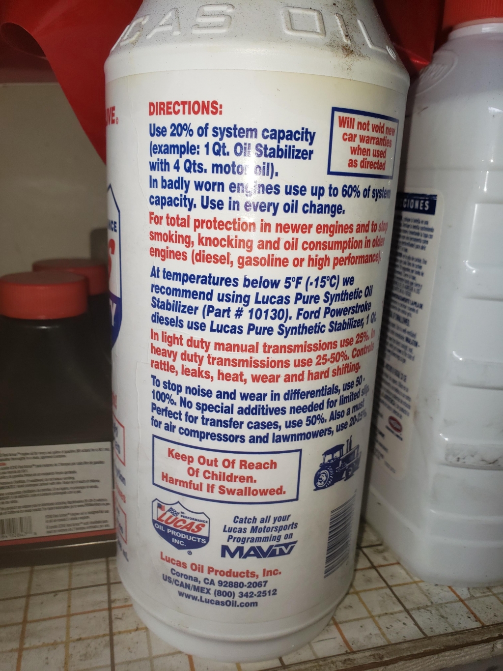

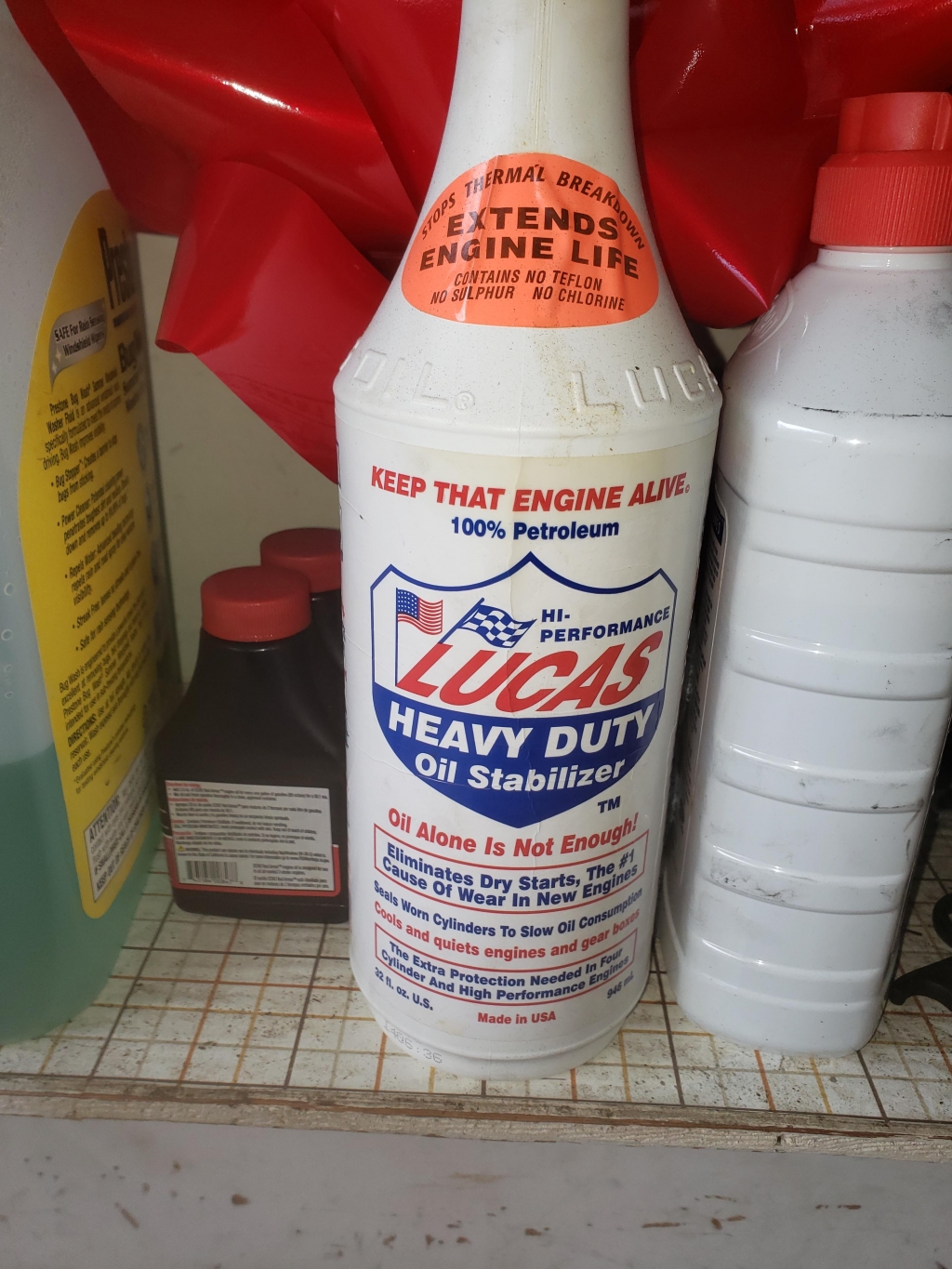

What oil are your referring not to use? The oil stabilizer? Why not? You don't give a explanation. I have used the Lucas in just about everything that has a motor. Say right on the back a must have for Compressors!

Im a big fan of Lucas oils stabilizer, but if youā€™ve ever been on bobstheoilguy.com you can see how heā€™s said that Lucas OS has a tendency to start foaming up at high speeds. These YH type compressors run high RPM, and I have a feeling your oil will foam up with a lot of air in the oil. If it does say itā€™s ok for compressors, I can bet you it wasnā€™t meant for these HPA type of compressors but for our low PSI shop ones from DewaltĀ or craftsman instead.

Isn't the oil capĀ designed to keep the oil from foaming up? I guess I'll be the one to find out what happens when you add the stabilizer!
