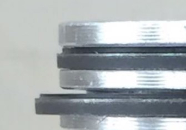

Just one more thing to pay attention to in case you re-install the first-stage piston ring. The Yong Heng people told me that the thinner side of the ring should be facing downward. The photo below shows the WRONG orientation :
That's a good one! This has to make a difference with how much more volume of air the YH puts out.
I wonder how long have they been keeping this one and and other tips a secret?
Many thanks for sharing!
