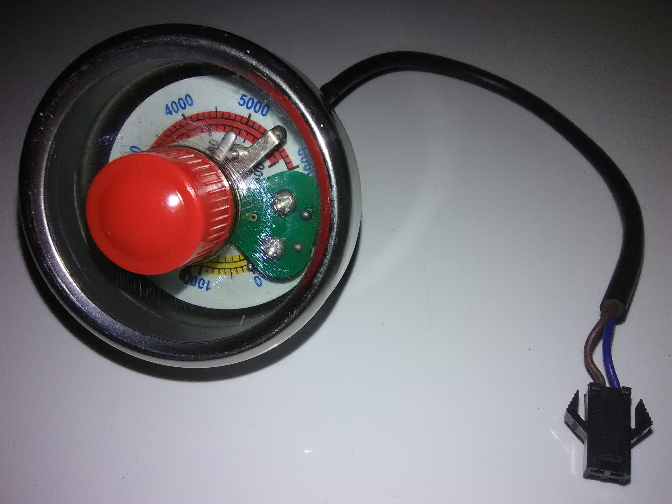

Agreed, three years in June for mine, no problem other than a leaking gauge. Semi-permanent in garage, set-up and break down bucket, hoses, and water pump each session. Don't use tank, just fill guns for home range use. A few other YH positives are inexpensive, easily found parts, good repair videos and power to pressurize post-compressor moisture filters. Caution needed to assure an authentic YongyIheng Pneumatic Company product is purchased, mountains of sub-par clones exist. Yong Heng produces 5 models; Simple, Hardcover, Set Pressure, Auto Stop and Digital. Hardcover and Set Pressure are recommended. Simple lacks Cyclonic Water Separator, Auto Stop is preset at factory (operator can't change) to stop @ 3,000 psi. Digital, OK, but price is up there. WMView attachment 499416
Haha, I probably have a clone, it has auto stop on it , and it works perfectly so far but it has not been preset for 3000 psi. I set the auto stop to 4300 psi and that’s where it cuts off. I really don’t have much in the thing though. It does have that black yong heng metal tag on it. Probably counterfeit tag, but it fills my rifle which has .6 liter capacity from 1500 to 4300 in 3 1/2 minutes. As long as the electric motor holds up the compressor part can be rebuilt. I put expensive oil in the crank case and so far so good. It is also suppose to have overload and overheat protection. It will not allow you to overheat the motor , it will shut down until it cools off. It has a 30 minute duty cycle , normally if you stick to quality lubricant and respect the duty cycle you can get even the cheap stuff to last. I guess time will tell. Thank you for your reply.
Panzerfaust,
Sellers often use inaccurate advertising pictures and model names. Auto Stop is preset at factory and has no method for operator to adjust. If you change pressure settings and it's authentic YH, most likely Set Pressure model. Picture of my Set Pressure model gauge, Hardcover model has solid glass gauge face, leaving it up to operator to shut off at desired pressure. Can't speak to what clone manufacturers build nor what they call them. Metal compressor ID plate is fairly common to clone and YH compressors, YongyIheng Pneumatic Co., listed on ID plate, is specific to authentic YH compressors. Clones note, "Made in China," name of clone manufacturer or blank. Chinese authorities are lax with copyright infringement but draw line at labeling incorrect manufacturer, at least that's how it seems. You're welcome for reply, sharing what Biohazardman taught few years back, miss having him around. WM

Sellers often use inaccurate advertising pictures and model names. Auto Stop is preset at factory and has no method for operator to adjust. If you change pressure settings and it's authentic YH, most likely Set Pressure model. Picture of my Set Pressure model gauge, Hardcover model has solid glass gauge face, leaving it up to operator to shut off at desired pressure. Can't speak to what clone manufacturers build nor what they call them. Metal compressor ID plate is fairly common to clone and YH compressors, YongyIheng Pneumatic Co., listed on ID plate, is specific to authentic YH compressors. Clones note, "Made in China," name of clone manufacturer or blank. Chinese authorities are lax with copyright infringement but draw line at labeling incorrect manufacturer, at least that's how it seems. You're welcome for reply, sharing what Biohazardman taught few years back, miss having him around. WMView attachment 500273
Yup, that’s the gauge mine has , goes up to 6000 and so far works well, I set it at 4300 and it shuts down and beeps fairly loud until I turn the main power switch off. I monitor it though don’t leave it unattended while pumping. Honestly I must have looked at 10 or 12 different units online, I finally got aggravated and just picked one that was in the middle just based on pricing. Tuxing makes one just like the blue ones, it’s black and yellow but it’s priced more than any blue one I looked at , it had good reviews , I almost went with that one but finally just selected a blue priced in the middle of the ones I had found. Working great so far!
