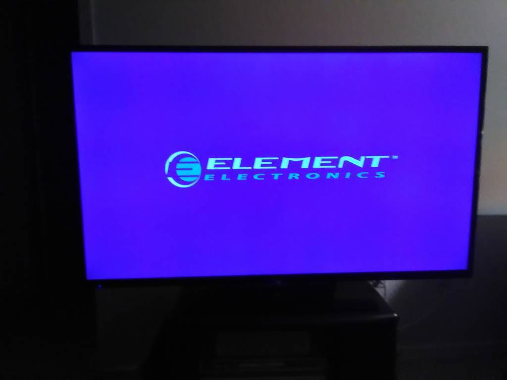

I don't even claim to be in your league, but, neighbor set this 2014 (60 inch) Element TV out by curb. YouTubed repairs, only needed $35 T-Con board. I get your addiction,
Yup the internet can really help allot at times when you need it on electronics. For the most part it has pointed me in the right direction a number of times.
You did good on fixing that big screen TV. You got quite the bargain on that thing.
