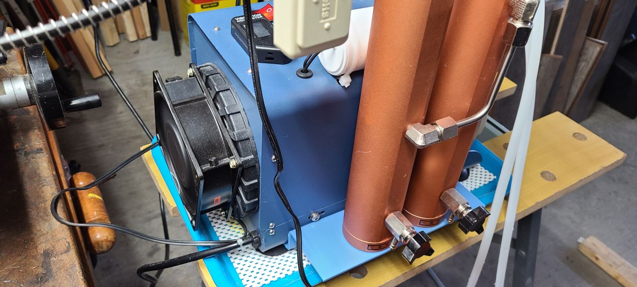

I have removed the original YH fan from the shaft and mounted a high flow fan from AC Infinity. It is a plug in so that means works independently from the compressor, usually I let it run an extra 5 minutes until I pack up the gear after a refill.
Looks like you bolted the new fan onto the existing intake grill? What is the watts of the fan?
