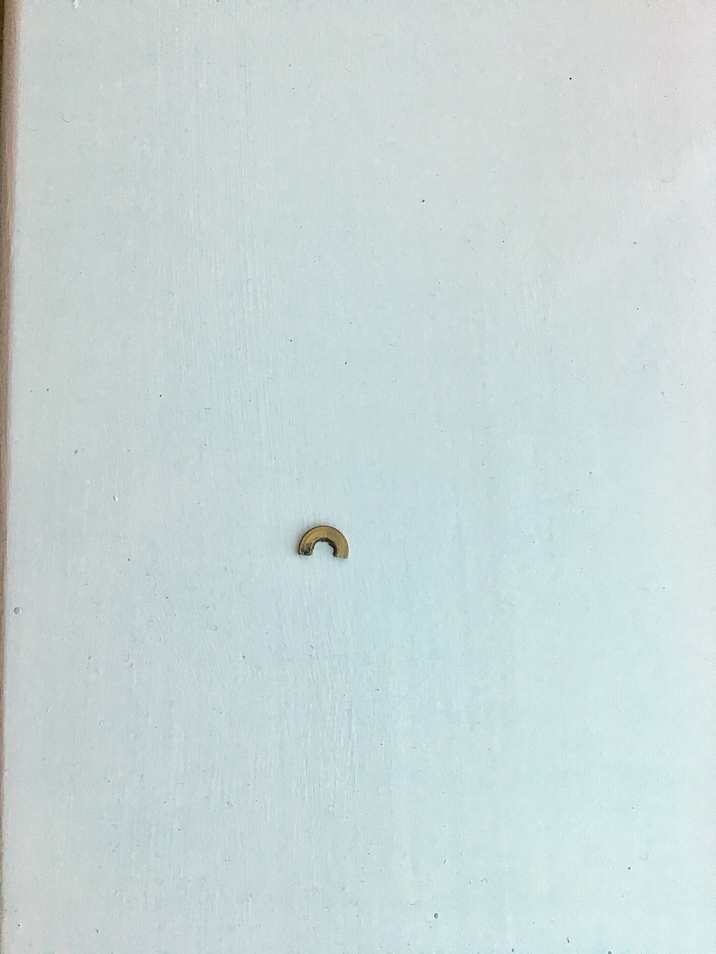

A clip that holds the rings on the high pressure side broke in half. This caused very low output pressure to the fill house.

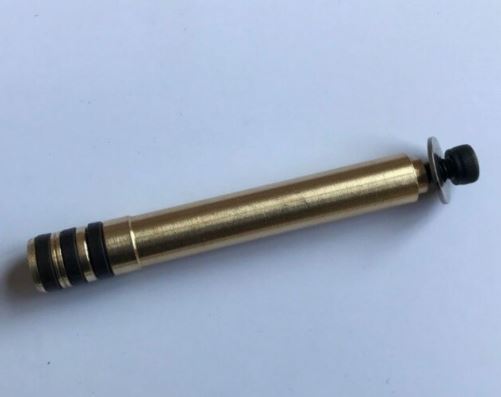

Any photo of this "clip" ? Each of the three rings on the 2nd stage cylinder consists of a brown plastic ring ( probably Delrin or Teflon ) surronding a green O ring ( looks like FMK type ). There is no "clip" as far as I can see.
I'll have to see if I still have the split washer/clip. It was mounted at the top where the three black seals you see in the picture.
I assembled the head etc back together so that way with the part(s) come in I'll know where everything goes. Hope I won't have any lose ends to worry about.

That picture looks like the assembly is complete....nothing missing....I don't think there is anything else involved...no clip or any place to put one. maybe a piece of the reed valve broke off and was floating around in the cylinder. It is a thin flat piece of steel that is somewhat flexible. it does not attach to the piston that is shown in your picture.
This is one half of the what I found.
My bad for calling it a clip but it is more in line with being a washer which looks like it's made of brass.
