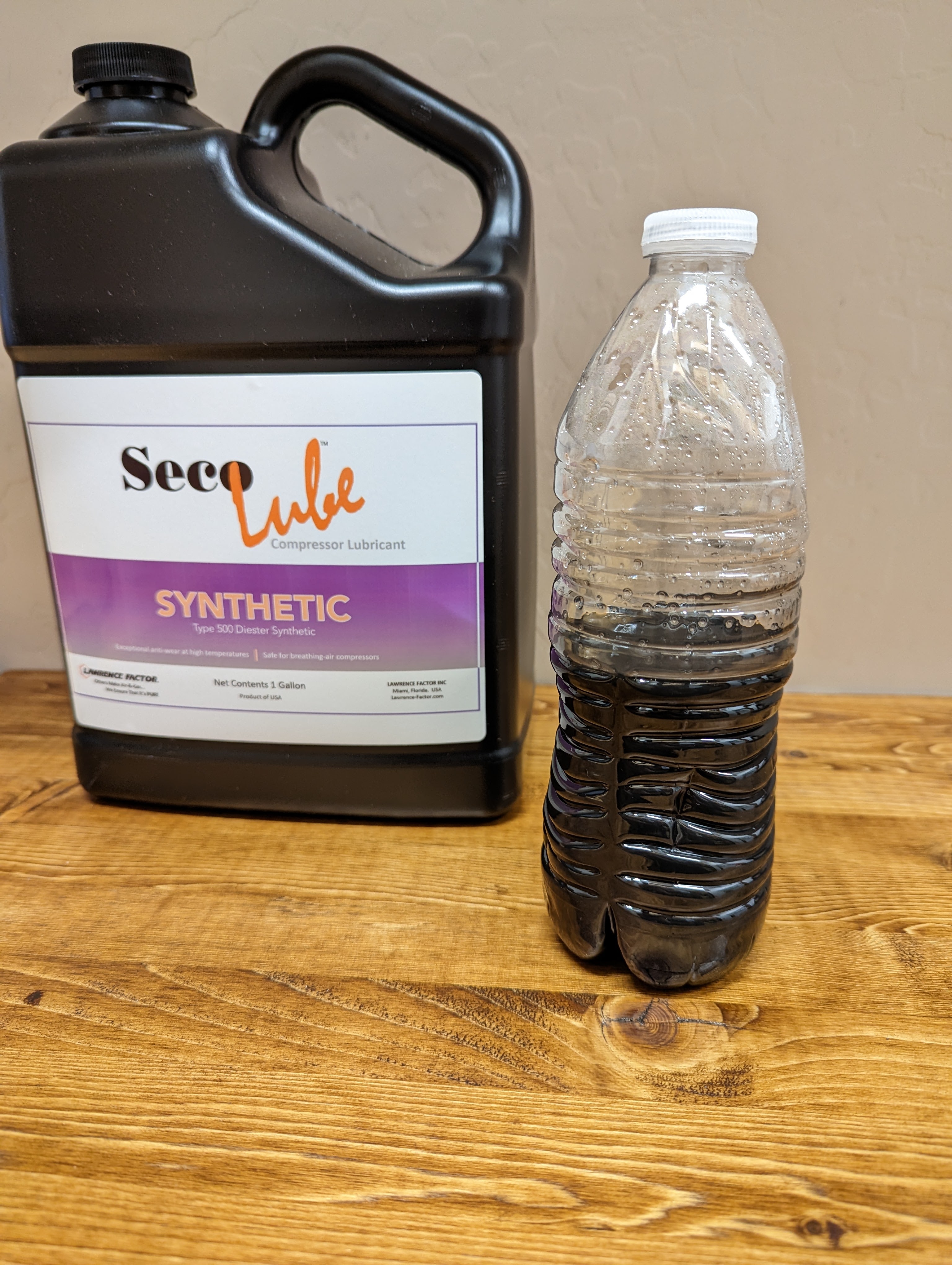

Bought a Yong Heng 5 or 6 weeks ago so I'm green as can be with them. I know many have been running them for years so I'm hoping to pick your brains.
The first 20 min I ran with Huskie Synthetic mostly because the Seco Lube 500 wasn't here yet and I needed to top off my tanks for a match. Drained that Huskee stuff after the first 20 min and replaced it with the Seco Lube 500. I'm now up to 126 minutes, total ( 106 minutes with the Seco), and the oil in the sight glass is dark gray enough to not be able to see the red dot used for measuring the oil level.
Is this normal? Do I need an oil change already? Sure hope not cuz it's gonna get pricey doing oil changes every 2hrs with the $75/gallon Seco stuff.
I've been trying to minimize run times, as everybody seems to say one should. Most of my run times have been about 12 minutes. The longest run time I had was 16 minutes. And my temps are topping out at 59-60 on the digital gauge. I did have a warm day a few weeks ago where it went up to 64 but stayed there.

Hi Franklink. I've been using Seco Lube 500 from the start. My first oil change was at about 45 minutes. Next change was at about 1.5 hours after that. Then about 4 hours after that. I'm guessing about the exact times here. I just keep my eye on the oil level and how grey it is and change when it looks even slightly dirty. I wouldn't wait for it to be so dirty that you can't see the red dot. For me, if it looks like it has a grey tint to it, I change it. Fortunately the Seco Lube 500 is a very clear lube so it makes it easy to see if it is dirty. The bottom line is that the time between oil changes gets progressively longer for the first handful of changes. After 4 or 5 oil changes your oil might not need changing more than every 20 or more hours. I'm just guessing about the exact times here again. For me personally I wouldn't plan any scheduled oil changes at specific hours of use. Just change it when it has a grey tint. This is subjective, of course. Two guys looking at the same oil will have two opinions as to whether or not the oil needs to be changed. One gallon of Seco Lube 500 will last a really long time -- don't know how long that is, but by the time you actually need to buy more oil, I'm confident that you won't consider the cost of a gallon of Seco Lube 500 to be a big expense relative to the number of hours of run time you get out of your compressor. Lots of guys here have started with one gallon of Seco Lube and have been running their Yong Hengs for years without needing to buy more.

My guess is the oil is dirty faster due to using the husky oil first. If you just changed the oil, there is still some husky remnants left in the system. It won’t be completely flushed out for a couple new oil changes of secolube. I wouldn’t consider your dirty oil the “norm” for secolube. Just for the first few changes. There is also probably metal shavings suspended from the break in also.

Ots breaking down in some way.
Like your car fresh oil lookse clean and fresh then your past due to change it and it near black..lol. Or contamination getting to it ,..

Take 2 clean white patches and a dip stick. Swab clean fresh oil on one and a sample out of the pump and compare. ( Just after a run before contaminats settle)
Notice any breakdown like color , metal, flakes, water, slickability, fine line between making it last another run or 2 or better go fresh.. (opinion). In the end it's your judgment call on whats best for you.

Good luck and welcome to the "oil turning dark fast" club. I've had the same issue for nearly a year now and have been through MULTIPLE oils. I'm now trying this stuff.
In general I think judging oil condition by it's appearance is not a reliable practice. If you really want to know the condition of your oil you can send a small sample for analysis. This is usually done with engine oil but I'm sure they would do an analysis of compressor oil. Blackstone is one company that does it, their price is $35. They will tell you how much metal is in the oil and whether the additives are used up. I haven't done this on my cars or my YH, I just change the oil often. My cars get changed with a full synthetic every 5k miles. My YH gets changed with Nuvair 751 annually. After one quick break in oil change. I run the compressor 3-5 hours a year. I've had it several years and only had to change an O-ring once. The oil looks kind of dirty when it comes out but not nearly as black as what I drain from my cars. I kept the drained oil in a clear container for several years and some sludge settled out. I presume it has some metal chips in it.
You seem to run your YH a lot more than I do which is fine. If you don't want to change your oil a lot an oil analysis may be a good idea. It could allow you longer time between changes without risking the compressor.
I think a gallon of oil is going to give me 10-12 changes. For me that 's like 10 years. But if 5 hours run time is only a month or so for you, then you could be looking at a gallon a year. It may be totally safe to extend the time between changes to 10 hours or longer. An oil analysis should tell you.
Here's the used oil. Ths has been sitting since Jan and still looks the same. Seco 500 is clear when new.

Oil is black, and can't have more than 2 or 3 hrs on it. Turns black on first fill after changing so just decided to leave it in longer.
I use Nuvair 751 and have since day 1 in my YH. I changed it early, after an hour or two run time. Now I change it once a year. I fill my 45 minute SCBA tank about once a month on average and it takes the YH 20 minutes or a little less to do it. So maybe 4 hours/year run time between changes.
The oil starts out amber and is darker when I remove it. I put the first 3 changes into one clear container and let it sit until I took it for recycling. Some sludge formed on the bottom. I've never seen a chemical analysis of used compressor oil but I suspect it gets dark for the same reason engine oil gets dark. It has carbon and other undesirable materials suspended in it. I think that was what the sludge was when I let it sit for years. When I change oil in my cars I put the old oil in a 5 gallon pail so I don't have to go to the recycler every time. That 5 gallon pail gets sludge in the bottom too. I don't see the darker color of the drained oil to be an issue or an indication of a problem. The oil is supposed to remove carbon and other junk and that changes it's color. It's just doing it's job.
My moto is to use good oil and change it relatively often. I don't worry about what it looks like.
