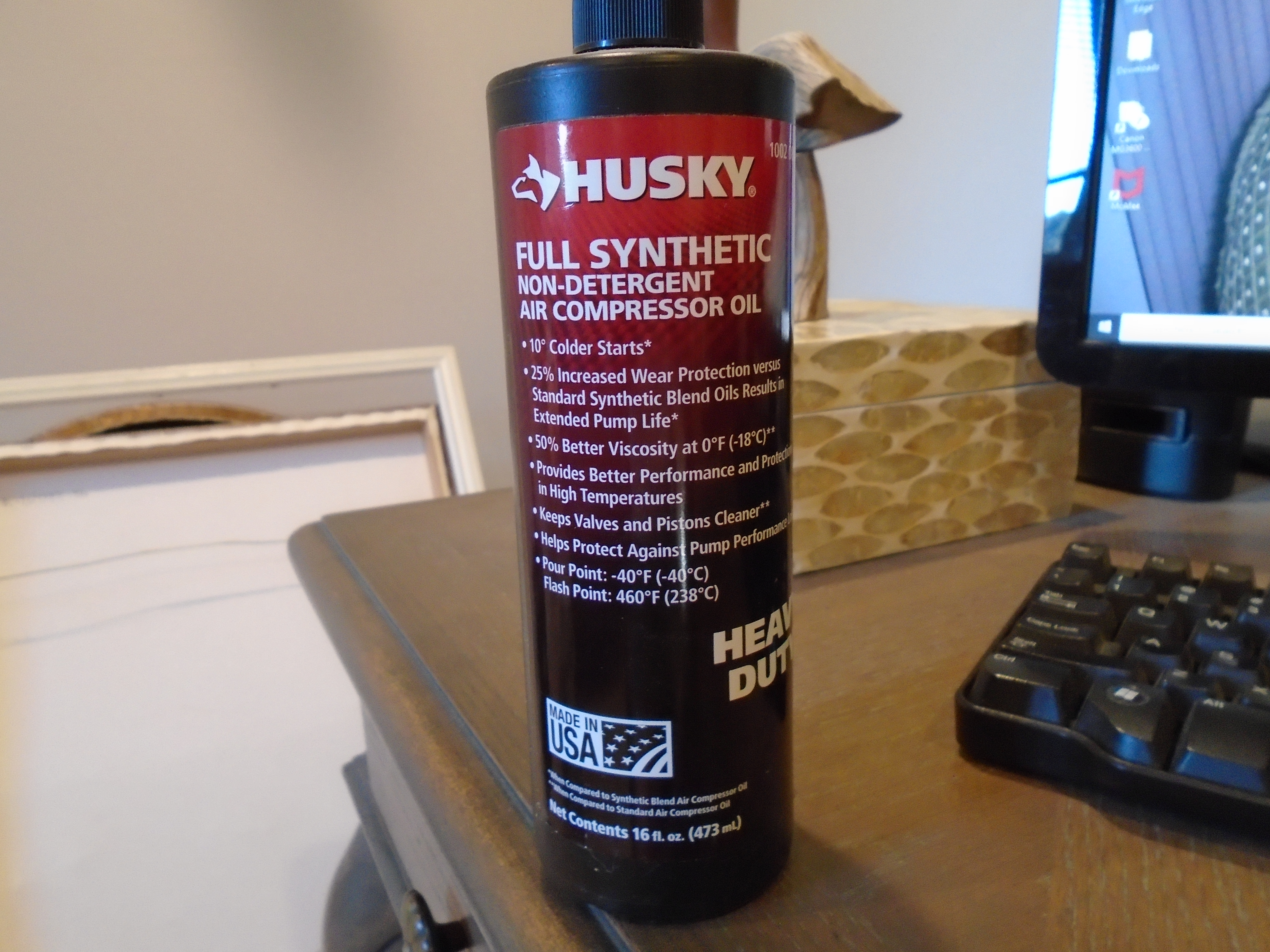

Have this oil in the compressor to fill my Brocock Bantam. Fill time less than 2 minutes. Is this oil o.k.? Say's flash point 460.

I used that first because it was available. I found it to have carbon deposits on the head under the valve and other places. Switched to SECO, no issues.

Don't young hang recommend
ISO VG46 Anti-Wear Hydraulic Oil, Mobil DTE25, Mobil 826or equivalent
It's funny how everyone uses everything except recommended .. lol
Then like huskey is just low pressure household or hime shop 125 psi compressor not 4500 pis high pressure .. idk. I guess it's what you feels best in the end ..

Yes sir that oil will work perfectly I use it in my tuxing double cylinder compressor you will have no issues seems like good quality to me plus you can pick it up at home depot 15$ for a quart isn't that bad
