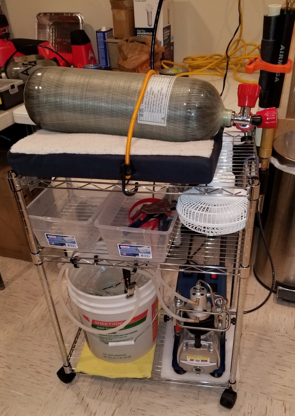

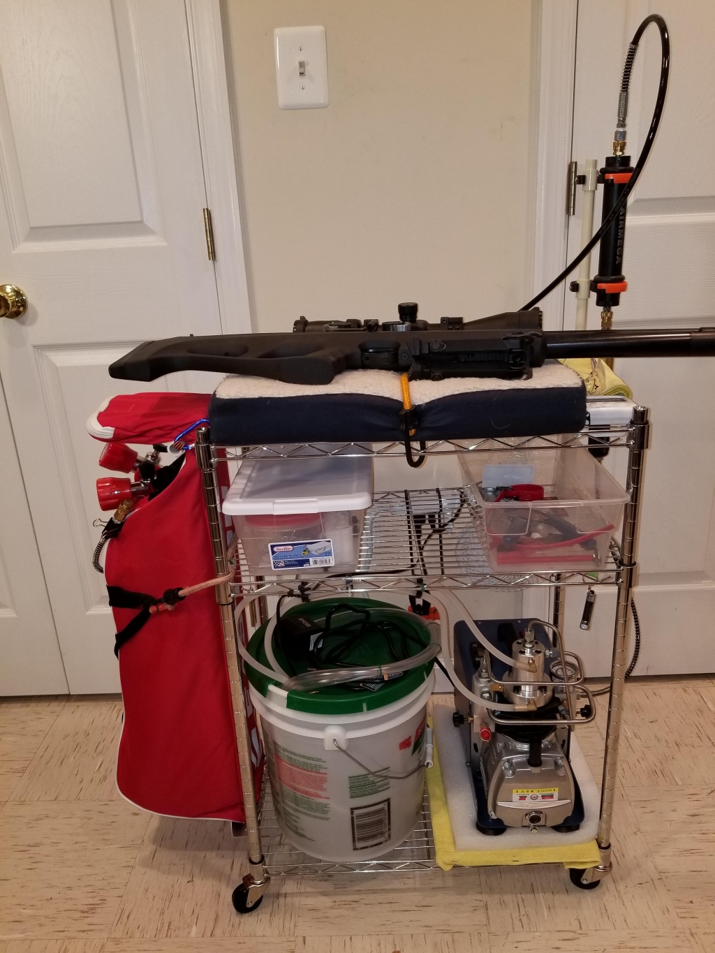

That might have been mine. Here is what I think that I posted. I have made changes since then so I will post new pictures when I get home.
A couple of changes:

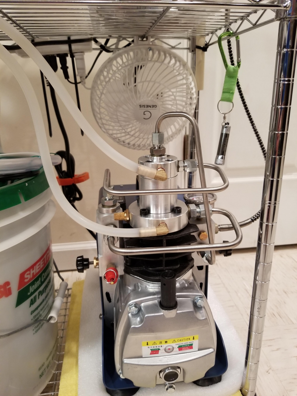

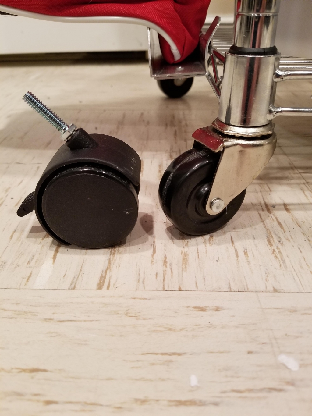

I upgraded the cheap plastic casters -

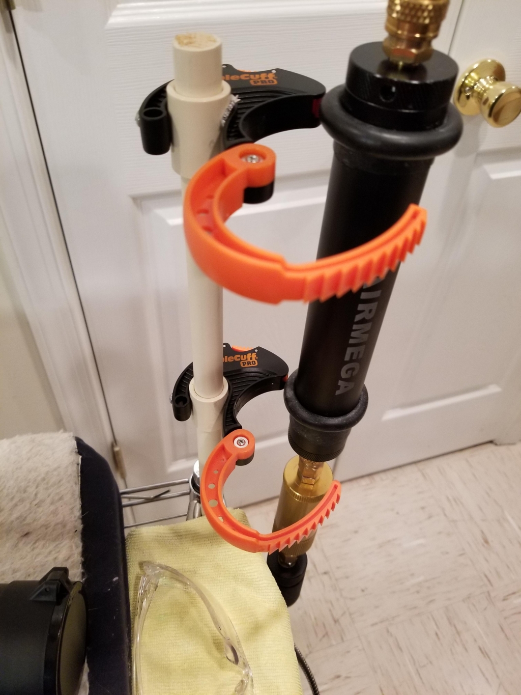

I moved the 6" fan to have more shelf space. The fan now moves air with the YH fan as opposed to 90° to it's airflow.
I made the air filter less of a hassle to remove.

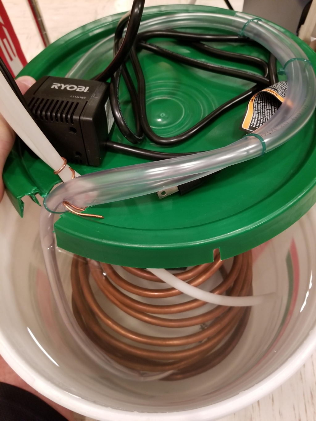

The additional pump and tubing is for a cooling idea I'm working on. It is attached to a coil of 3/8 copper inside the bucket. I am going to try circulating chilled water thru the copper and see what that does for temperatures over longer run times. Why not just use ice you ask? If it works then I can add water wetter to the water bucket and not have to change out the water. Short run times = run as is. Long run times = just add a second bucket of ice water.

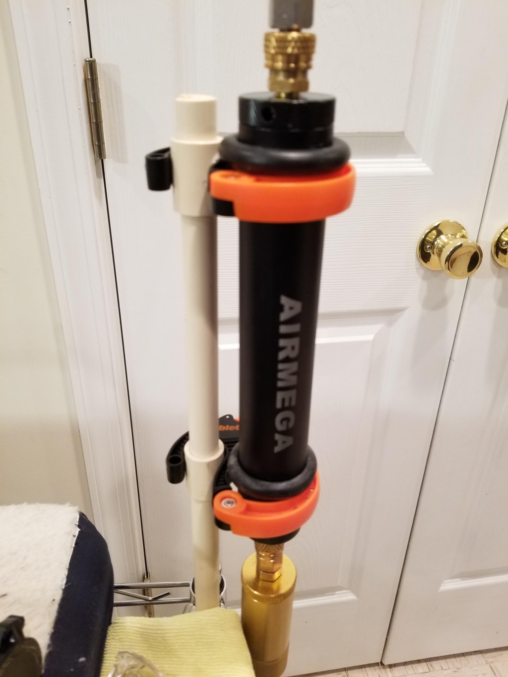

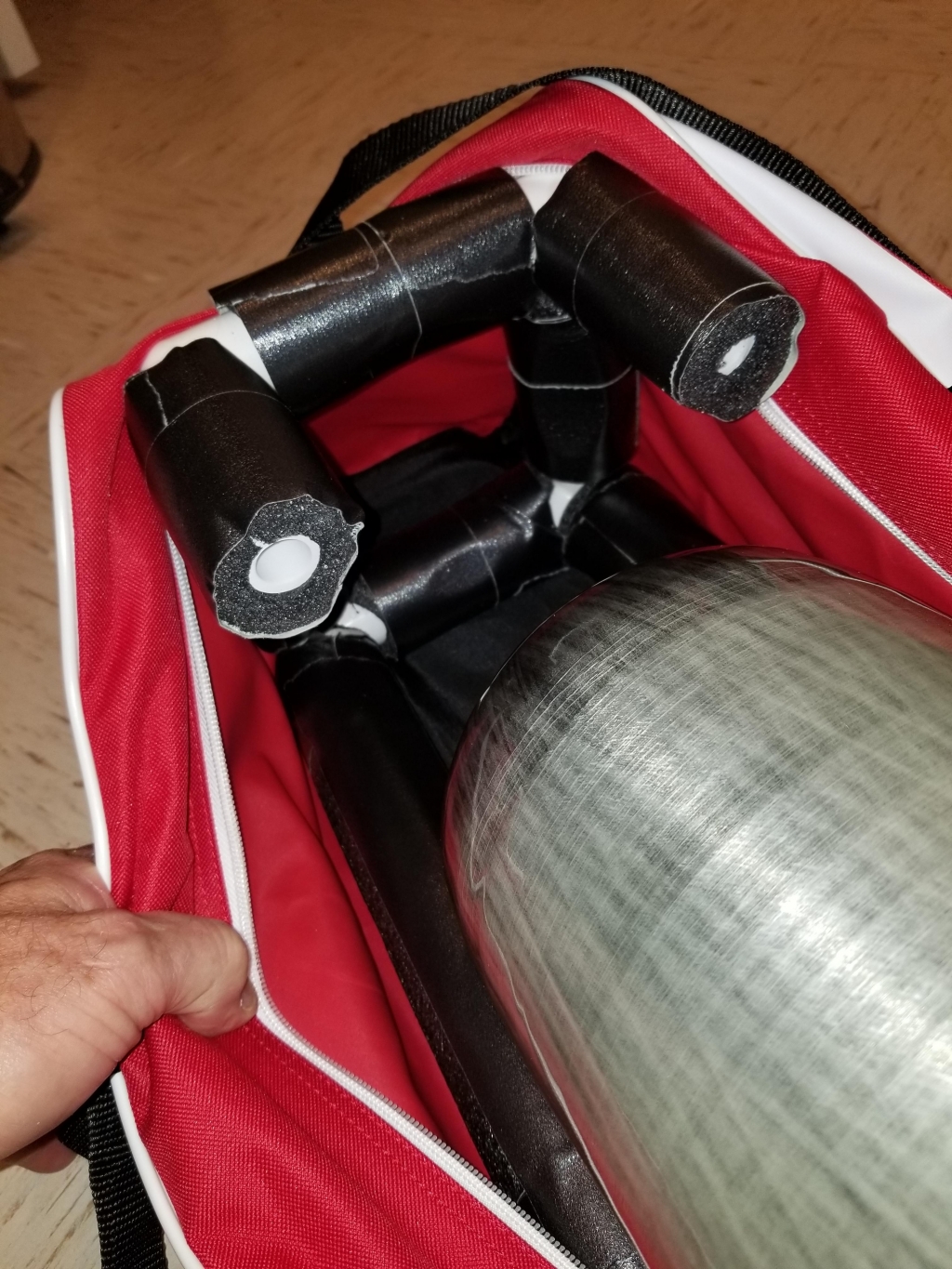

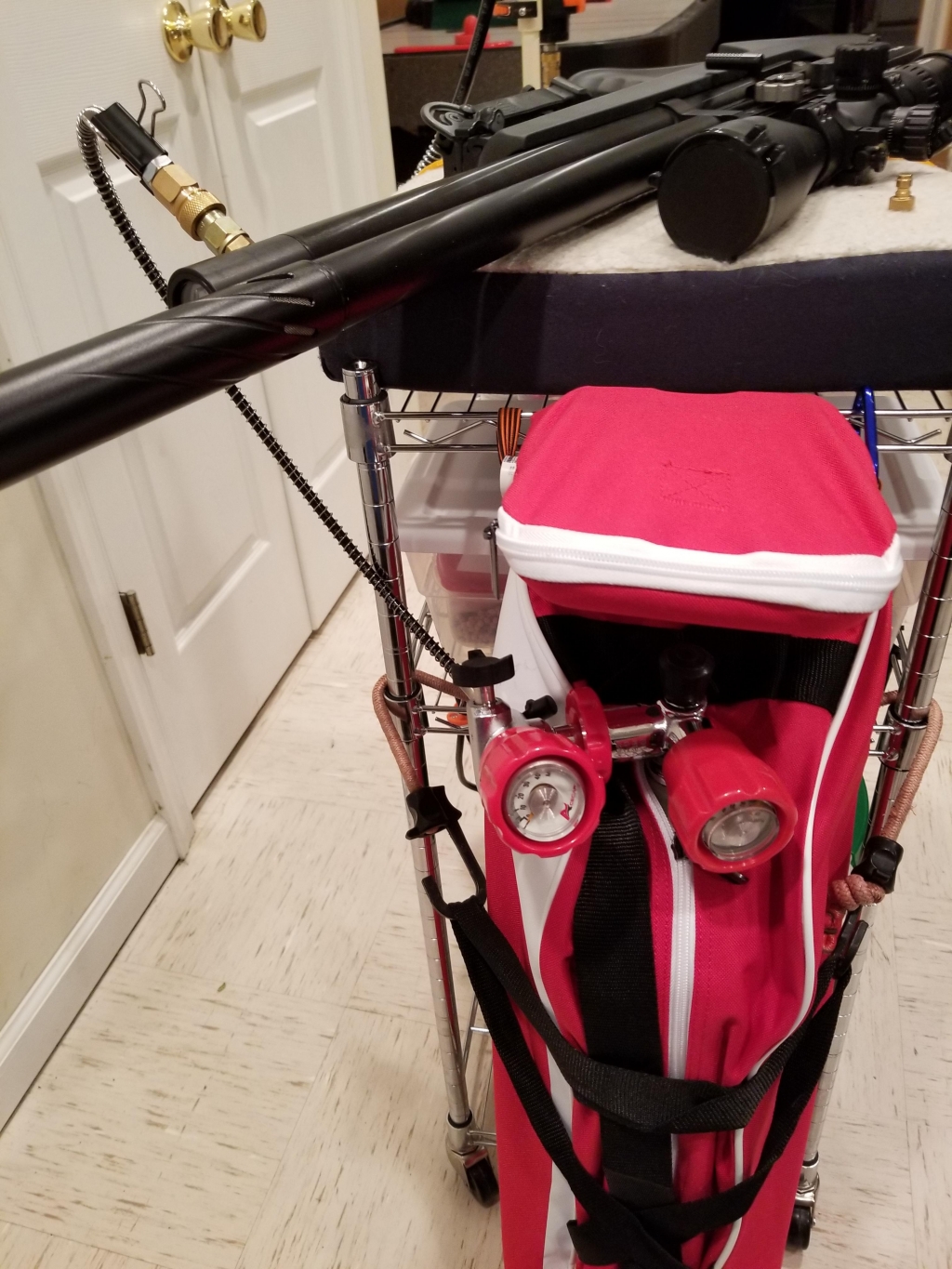

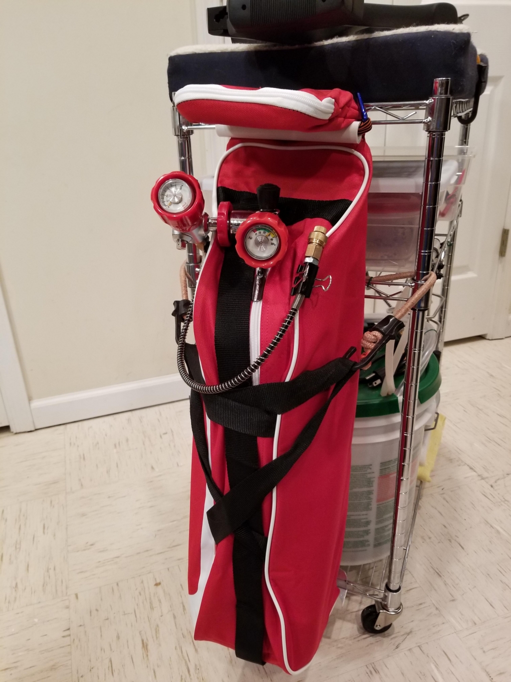

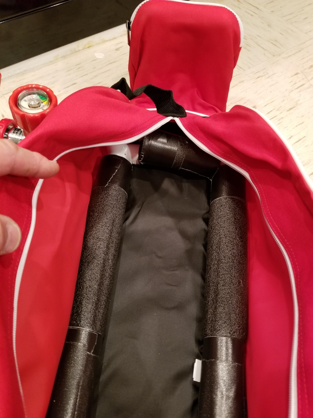

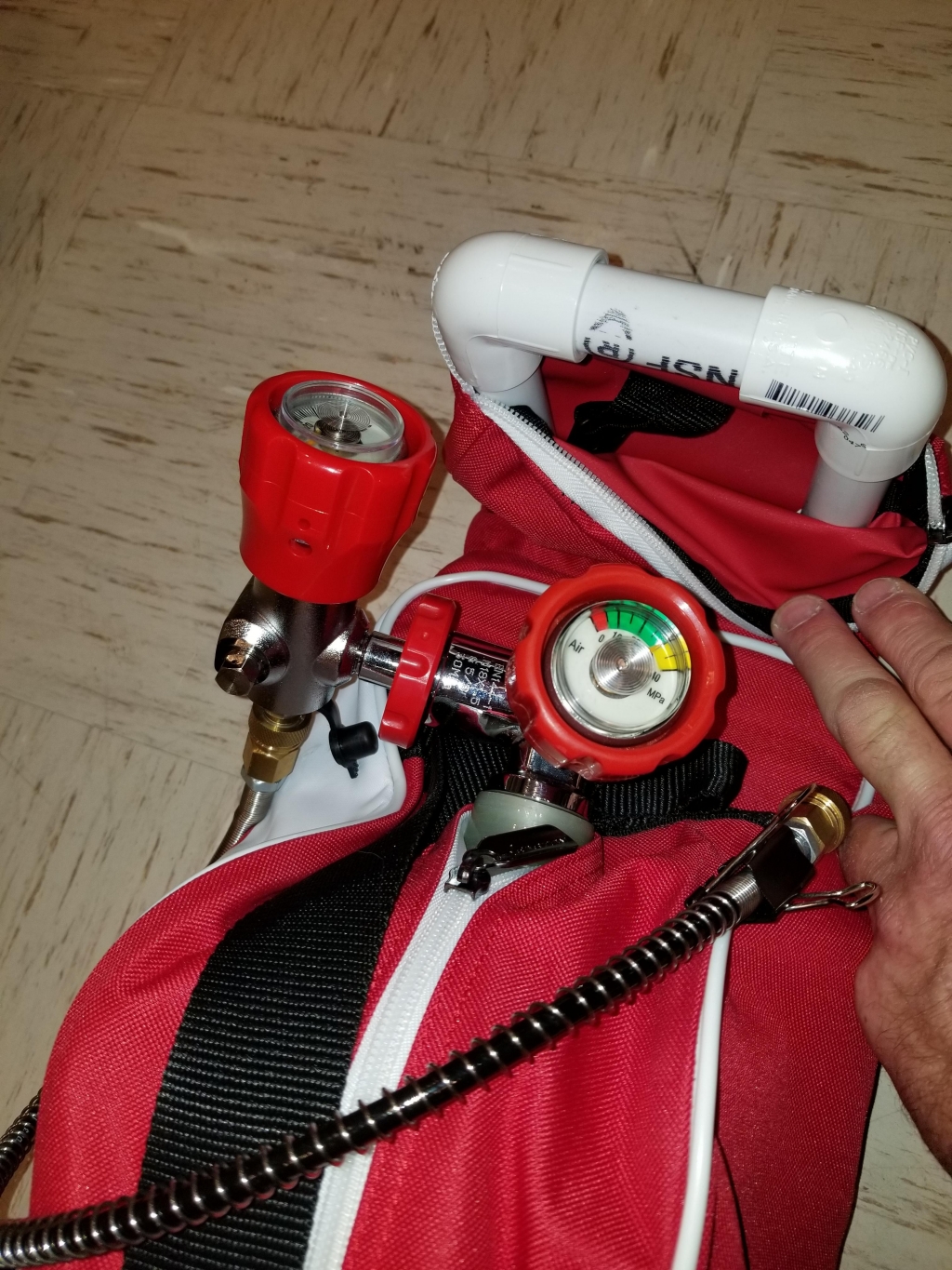

My final add on is a holder / carry bag for my 6.8L tank:
I wanted a carry bag that I could hang on the side of the cart, easily carry, offer some protection to the valve assembly (pvc frame that is padded around tank) and allow me to fill guns without the need to work around inside the bag or take tank out of bag. It is a youth baseball bat bag with a DIY padded pvc frame. Strapped to the cart makes gun fills really convenient.
