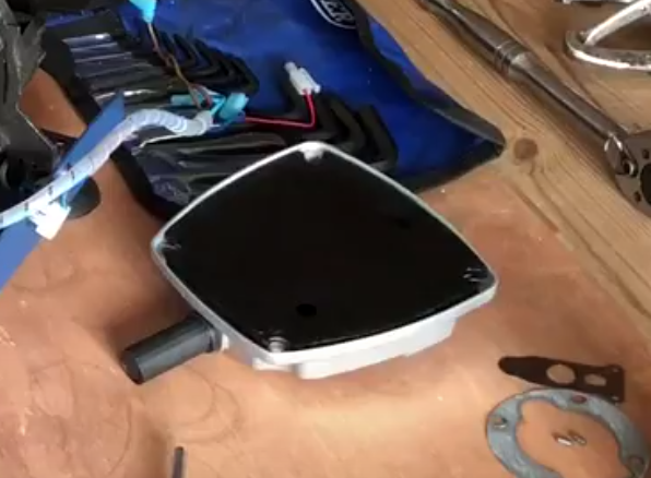

Picture of "membrane" on crankcase face plate, face plate facing down.
My method is to stretch the membrane in all direction and put it quickly in place before it shrinks back to the original size. The working time window is no more than 3 seconds. I managed to get it done after several attempts. There has got to be a better way to do it. I am asking the Yong Heng how they install it in the factory.
edit : the Yong Heng people suggested to replace the membrane with a new one. The cost is 5 Chinese Yuan which is less than one US dollar. I am located in Hong Kong so I can get it from their on-line shop in China. I think Yong Heng has an official shop at Aliexpress as well, may be you can ask the seller there. They may be able to get it for you even if the parts is not listed. This is how Chinese do business. You need to talk to them.
I will never remove that membrane again unless it is absolutely necessary.

I am afraid that will be impossible as it is not a plain sheet but one having a ridge running along it's perimeter mating the groove on the crank case . To seal effectively , the ridge must go fully into the groove. This is difficult to achieve if the membrane has shrunk.

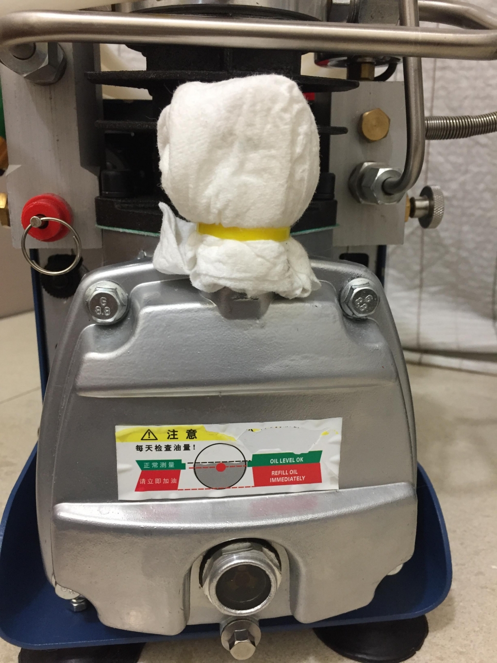

Well, that's just my theory but it makes sense to me. There has got to be a reason for it to be designed that way. Some members of this forum have reported seeing fine mist of oil coming out from the breather tube and presence of oil smell around the area where the compressor is running. Just to be on the safer side, I wrap kitchen paper around the breather tube of my Yong Heng to provide additional filtering. Doing so may be redundant but it's better to be safe than sorry.
