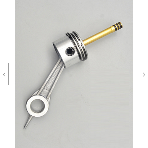

Disassembled the YH first and second stage, I am noticing oil in cylinder walls, pulled out the piston assembly, and the first stage piston rings are shiny... gone...the second stage rings look OK.
I just checked my aliexpress purchase history, last time I ordered a full cylinder + piston all in a kit, in March last year. Prior that somewhere in 2021. I think it is not so bad for total of 64 hrs. Also, may be a good entertainment tinkering with.
In my crate I have two (didn't throw them out) full cylinder+piston assemblies, all worn the piston rings. I think both rings, the lower lubing and the two upper compression rings the edges shiny.
Anybody come up with a source for first stage piston rings only? I may order a full bag of those.
I don't mind buying the piston+crank kit for $20, or maybe two, but when I know the rings goes first.....
Also, I trust myself most how to mount rings on pistons
