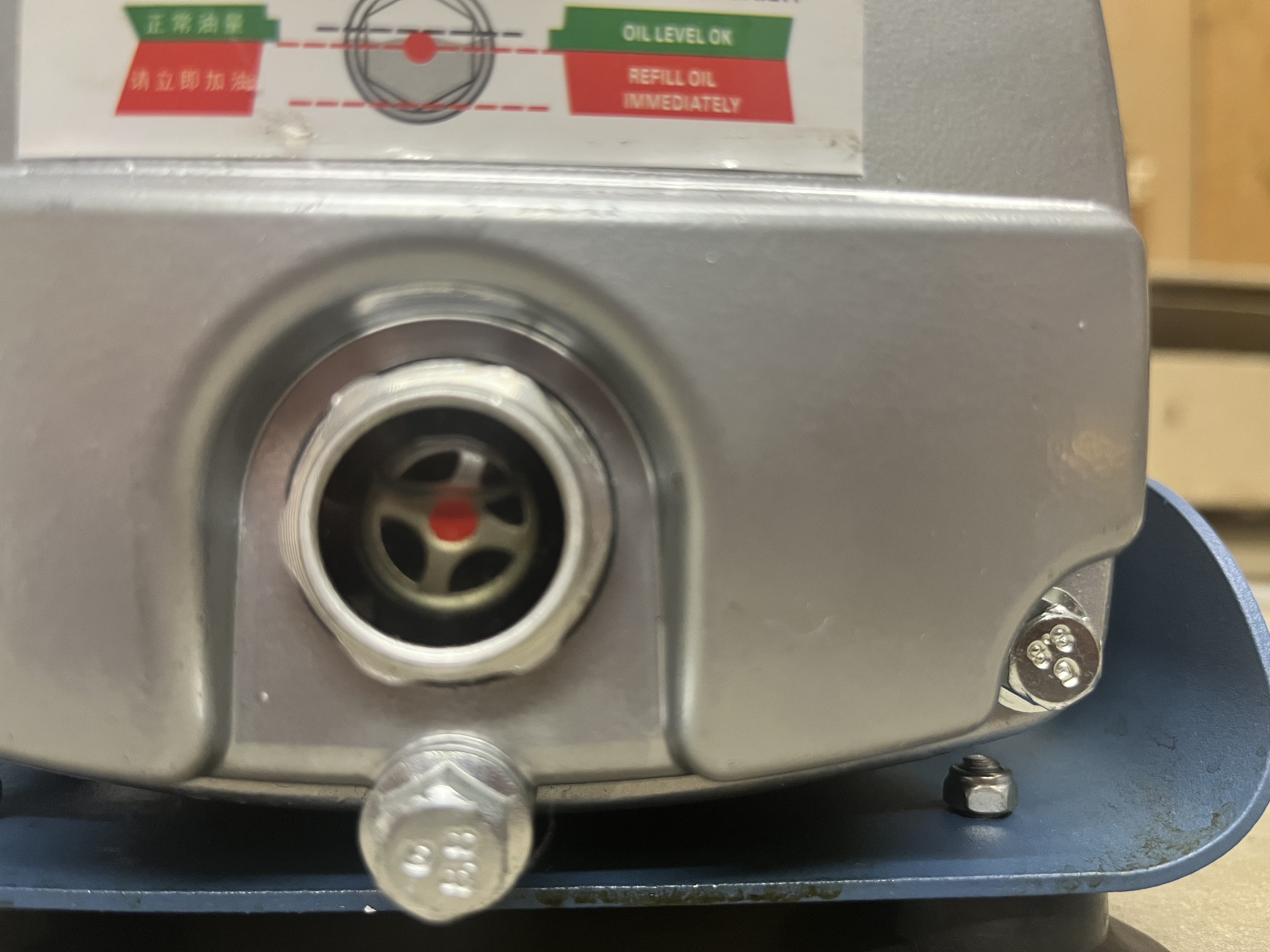

Make sure that the crankcase is level. On mine, the bottom plate that has the feet on it is not square to the crankcase so I put a small bubble level on the pump itself rather than on the straight line of the bottom metal to make sure it is level when filling with oil, checking the level and when running it. I had to put a piece of masonite under the front legs to get it level so the reading was true.
A photo of where the oil is in the sight gauge would be helpful to show where you have it. Too much oil can cause problems as I recall as of course can too little.

Here are some pictures. Close as I can tell the oil level is where it shows it should be.
Zach,
There's another oil breather hole, at center bottom, might be restricted, if air exits oil breather top hole while compressor running, oil breather functioning. Oil level looks good, would consider piston ring problem, cracked case or if compressor was on its side, while filled, allowing oil to enter areas not designed. Think, in your shoes, I'd use compressor, keeping close tabs on oil level, while searching for additional clues, such as excessive oil use or unusual sounds. Best of Luck, WM

Hi Geezerhood. I once started a thread asking "are you sure your yong heng has enough oil", or something like that. I had a gut feeling that the oil level should be centered on the red dot when the piston was plumb (meaning the crank shaft was level) rather than just setting the compressor on a level surface as the instructions said. Again, it's just a gut feeling I still have, but I can't prove or disprove the validity of it. The crankshaft is definitely not level on any yong heng when the entire unit is placed on a level surface. Perhaps it is intentional and the sheet metal guys at yong heng were instructed by the guys that designed the motor, crankshaft, and piston to offset the crankshaft by x number of degrees. OR the sheet metal department just jacked up the back of the motor in the case so they could more easily install the power cord. It's all creepy gut feeling for me. Anyway, I still do what I think you are doing by placing a small digitital level against the back of the piston to make it plumb and then place stuff under the front legs to keep it there. THEN I check the oil or fill the oil. It seems to work OK unless I fill to the TOP of the red dot. At that point I think there is a bit of foaming going on. But if I only fill the oil to the center of the dot things seem to go OK. I only have 9+ hours on my yong heng with no problems, so not a lot of use.

I should have added that my folding table that holds my Yong Heng has a visible slant on the top so I knew I had to compensate for it, otherwise the oil level would have been way off. It might well have been better to level it off the straight sides of the bottom metal. I will have to see how everything lines up on a level surface, though I am not too keen on moving the compressor since it is hooked up to the water bucket.
For those who have torn into one, how far away from the sight gauge is the little pickup probe on the connecting rod?
