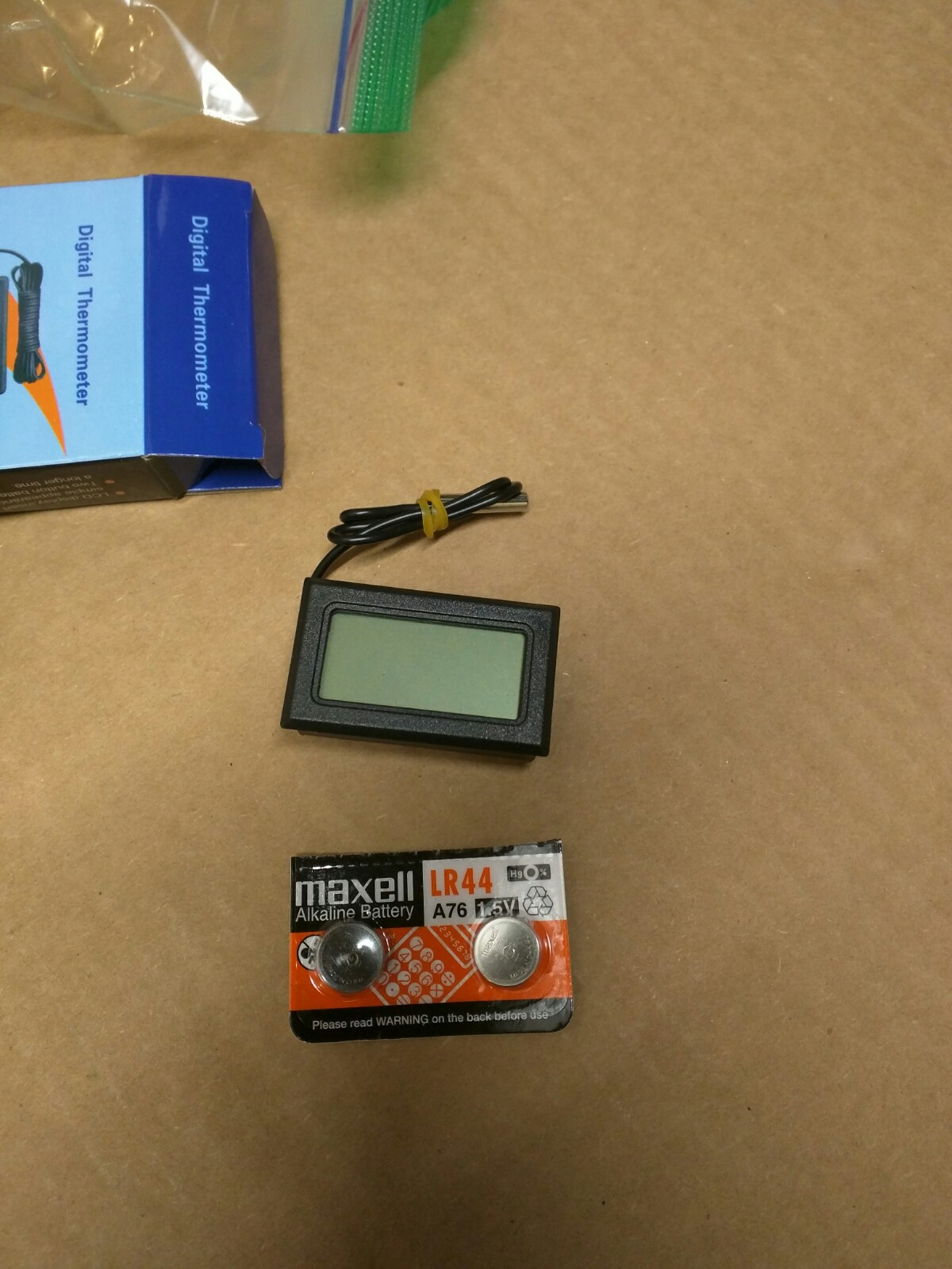

batteries for thermometer.
AA,

AA,
Still search under "best-homepro," then find thread about Air Venturi Fill Nipple, that will provide good info, including Bio's Fact Sheet. 357 batteries are longer lasting than L44 for the snap-in temperature digital display. SecoLube 500 has a 520-degree F flash point while the Husky Full Synthetic Air Compressor Oil has a 460-degree F one. Higher the better for flashpoint, lower flashpoint oils getting into second stage will tend to detonate and cause problems. WM
