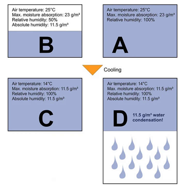

I am not discussing absolute humidity, that is all you, you're on your own there. I never said temperature changes absolute humidity, because I don't care about absolute humidity, I only linked the definition describing the difference between the two, and one of the differences is temperature effects relative humidity...period. Ending the statement that 'temperature effects this' was not directed towards absolute humidity, it clearly effects relative humidity....so don't take something out of context to appeal to your confirmation bias.
The articles I linked and all of my statements have been about relative humidity, which I have proven thoroughly greatly impacts compressors. You keep running circles around and around and I am not going to play cat and mouse with you.
You can think what you want, but you have made no clear arguments, only thoughts and hypotheticals while I have given you citations, actual citations proving that relative humidity does effect compressors...either you didn't read them carefully enough, or are unable to grasp the premise, even with pictures, like a picture book...but yet here we are....and I am done trying to explain a very simple concept to you.
Another picture from the above linked article. DO NOT TAKE 'this depends on temperature' out of context, as it applies to RH, not AH

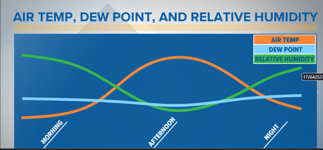

I plan my fills, during the time of day where humidity is at its lowest, another key factor in preparation some may not consider. Morning = bad, afternoon/evening when its the hottest = best (for low humidity conditions). This morning was probably 30% humidity, right now its 25%, and in a few hours it'll be 19-20%. I am fortunate to live in a very arid climate, at least from the airgunners perspective.

I already cited 2 articles stating otherwise...if relative humidity was pointless, then these pictures would be pointless...
You do you boo. Go run your compressors in 100% RH, I'll run mine as close to 0% as I can.
And another, as you see, RH and Dew point is lowest in the afternoon....as I said when I prefer to fill, opposed to mornings...or evenings...
