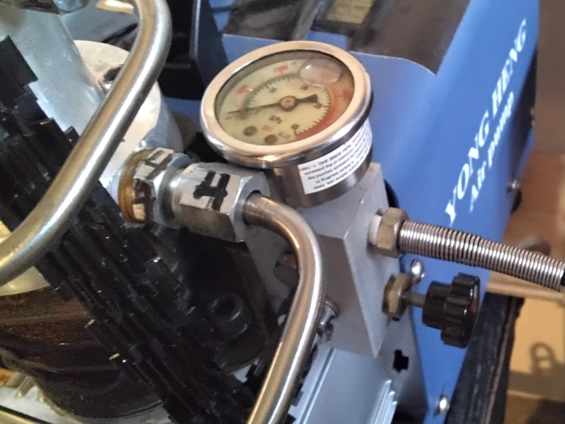

No worries pal. I don't feel hijacked. The check valve is on the right side, almost touching the pressure gauge. It's in the fitting that the tubing connects to & has the 2 dowty seals/bonded washers under it, 19mm wrench needed or a metric crescent :ROFLMAO: :unsure:. Keep pressure on it when unscrewing, there's a spring inside & a cap that makes it a check valve. I'll try to add a picture. In the pic, it's the part with the 2 #4's on it.

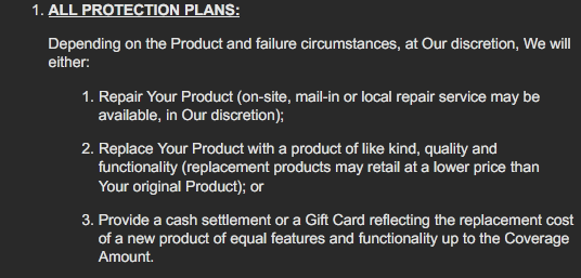

I totally forgot I bought a 4 year warranty when I purchased the YH! Anybody on the forum have experience with warranty & return? How'd that work for you?
Was it through a 3rd party? I believe they require you to go through a repair center, not sure if they need to be authorized or if diy repairs count.
You'd have to look at the terms and conditions set forth by your protection plan/warranty provider.
My plan excludes normal wear and tear which I think most claims could easily be denied under unless you skirt them somehow.
Depends where you bought it. Mine was through Walmart. When it failed, walmart said the seller is responsible for the first year.After a big hassel, walmart refunded my money,voided the warranty and told me to keep the unit., the gauge was leaking.
You scored! Got mine thru Amazon. Really don't think the warranty thing will pan out.
