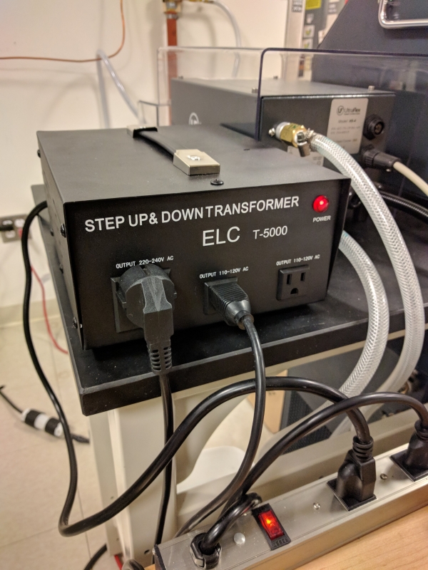

I bought a 220V one because the price was way better at the time. Use a step-up transformer, which plugs into your standard 110V outlet and provides 220V for the YH. Heres the one I bought from Amazon for $89.99 - though I've seen that the price has gone up now. Maybe it will go down again or you can find a price match for them.
"prfssrlee"I bought a 220V one because the price was way better at the time. Use a step-up transformer, which plugs into your standard 110V outlet and provides 220V for the YH. Heres the one I bought from Amazon for $89.99 - though I've seen that the price has gone up now. Maybe it will go down again or you can find a price match for them.
Yes I know that is an option. I am not concerned about the availability of a 110 and a 200. I have both at my residence. I was just curious about the put that came with the 220v unit. If in fact it is a 220 plug or a 110v.

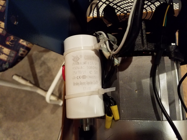

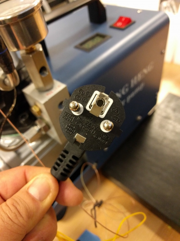

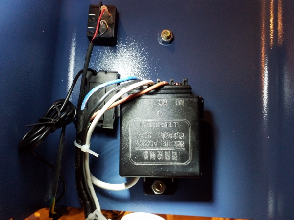

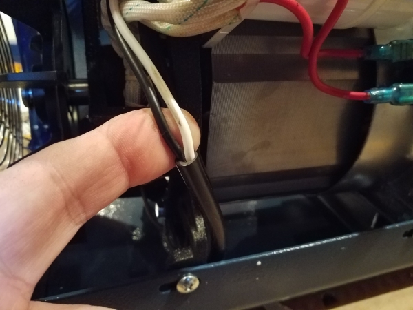

I ordered a 110v YongHeng a few months back. They sent me a used 220v with an EU style plug. Some electrical motors do have a center tap that allow you to move a wire internally. I opened the used one to make sure and it is only 220v. I got a refund and ordered another that arrived yesterday. It was packaged really well. I haven't tried it out yet. They didn't want the used one back so I guess I have a source for spare parts.

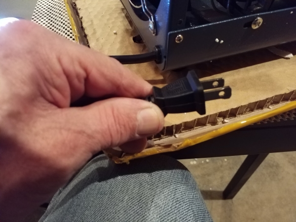

I also purchased the advertised 220volt pressure adjustable version. It came with a US 2 prong plug (type A), but "no ground". I have existing 220volt source @ home and don't mind splicing a plug or running a heavy extension, but I'm not sure what to do about the "no ground". I can put 110v to each leg of the 2 prong plug, but should I ground the motor and frame with a separate wire or leave them isolated ??? Planning on having a defibrillator, first responder crew, & helicopter on stand by. I'll let you know how it turns out.

Guys please be careful. A US 220 plug looks different than a US 110 plug. It will no way fit into a 110 outlet. If your plug fits a 110 outlet then you have a wiring issue. Guaranteed!

I think the problem is there is no standard US 220v plug unlike in EU, there is a vast amount of different style US plugs for 220V. If you look at one of the vendors that shows the different plugs they have it will only show the US 110V plug, which is the only standard end we have. So if it's 220v, it will either be EU end or if they send it with US end it will be of the 110V type plug.
