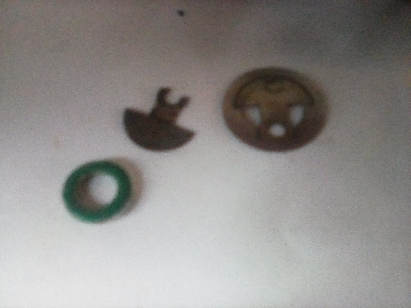

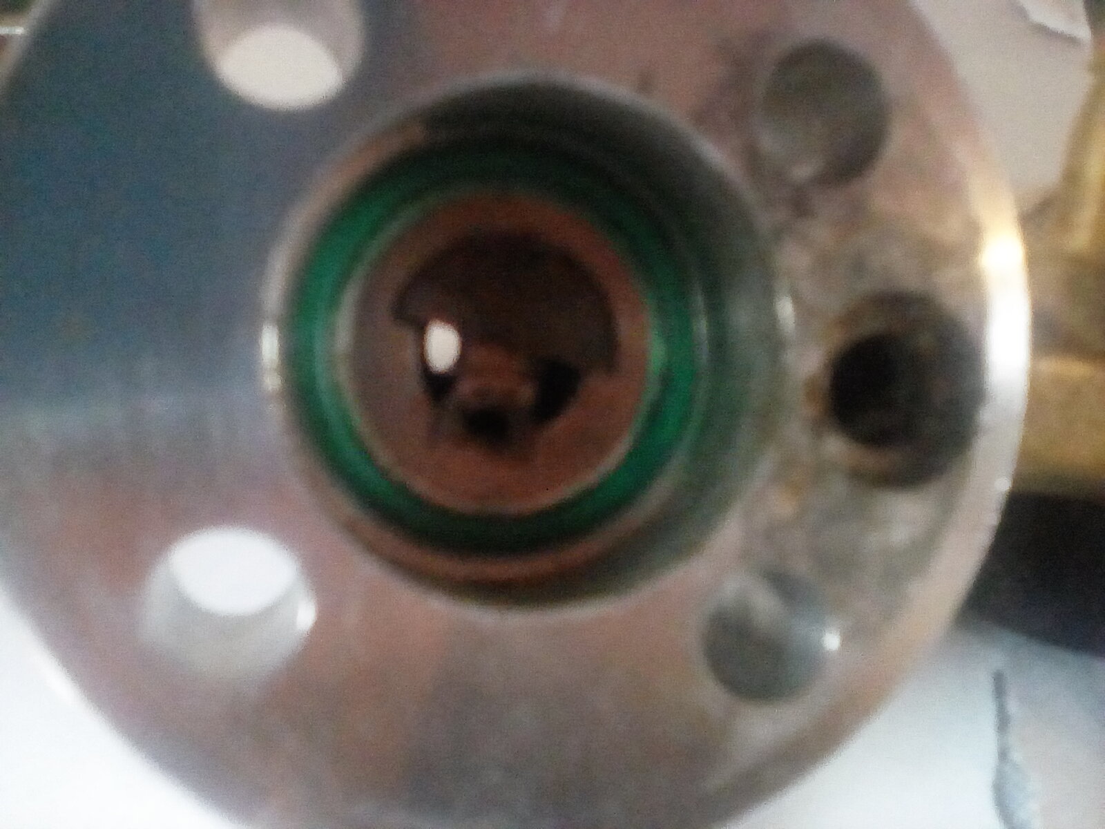

I'm trying to get Yong Heng running one more time. New piston gaskets ect. Still not building pressure. I figured I'd check out the valve plate and change o rings. I think this is my problem.. Having a hard time finding them. Found some on eBay from China. See the internal valve plate broke off from the metal ring. Any input appreciated.

I've had several minor leaks in my 2-year-old YH. First was worn out Delrin "donut" washers my black-knobbed pressure-release screws tighten against to seal. Replaced with YH spare parts. I've had rubber "O" rings fail inside 2 female foster fittings, tore apart top half of YH looking for first leak before finding foster leak, next foster leak I caught right away. While top half of YH apart noticed Dowty seal (metal/rubber) from steel tubing to top of high-pressure cap had failed, due to being loose, replaced with YH spare parts. Hope this helps. WM
