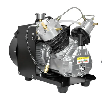

Hi,
My Yong Heng is almost 4 years old and its dying. However I am looking at the Tuxing Double(twin) Cylinder just the standard model since I got all the filters already from my Yong Heng.
Does anyone know if the Double Cylinder model is more reliable then the Yong Heng for filling a 7 liter tank? Does it fill faster than a Yong Heng due the design? My Yong Heng served me well but it is so damn loud. I considered a dive compressor aswell but thats a bit out of my budget.

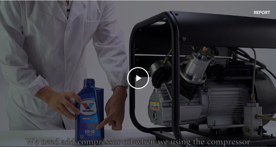

WOW! I am truly intrigued with this compressor, they must have redesigned the system since they are now suggesting the use of 5W-40 motor oil now!
It is also made to fill full SCBA bottles, 6.9L all at once with no cooldown cycles to 4500 PSI!
One would be able to do oils changes monthly with little cost and with the long duty cycle, I bet it would last longer as well.
I'd get the 4 year warranty myself, just sayin' ;)
Or maybe, just maybe, their marketing is not on the same page as engineering.
The Tuxing is the same basic compressor as the Yong Heng. So they separated the HP and LP stages and moved them to separate cylinders, redesigning a few things. Great. As a result, it runs smoother and quieter. Perhaps fills marginally faster. That's it. Other than that, don't expect miracles from it. Still the same Chinese assembly, quality control, and support. And definitely don't use motor oils in it.

I have one over these compressors except I've got the one with the cage around it and I have had a lot of good luck with it I feel a 6.8 l bottle one to two times a week for about 6 months now and the thing is still running strong the biggest thing to never let it overheat too far and keep the hydraulic oil changed when it gets dark compared to the young hang I have had four young hangs and not one of them lasted more than a month in fact most didn't even get to the first fill. As far as my experience with the tuxing I would absolutely recommend
