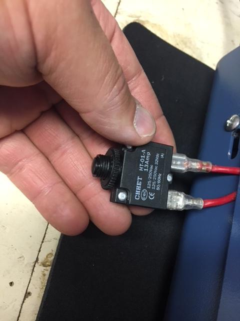

I do have an issue with mine constantly kicking off while I am pumping. It seems to be caused by the crappy switch pictured here:
