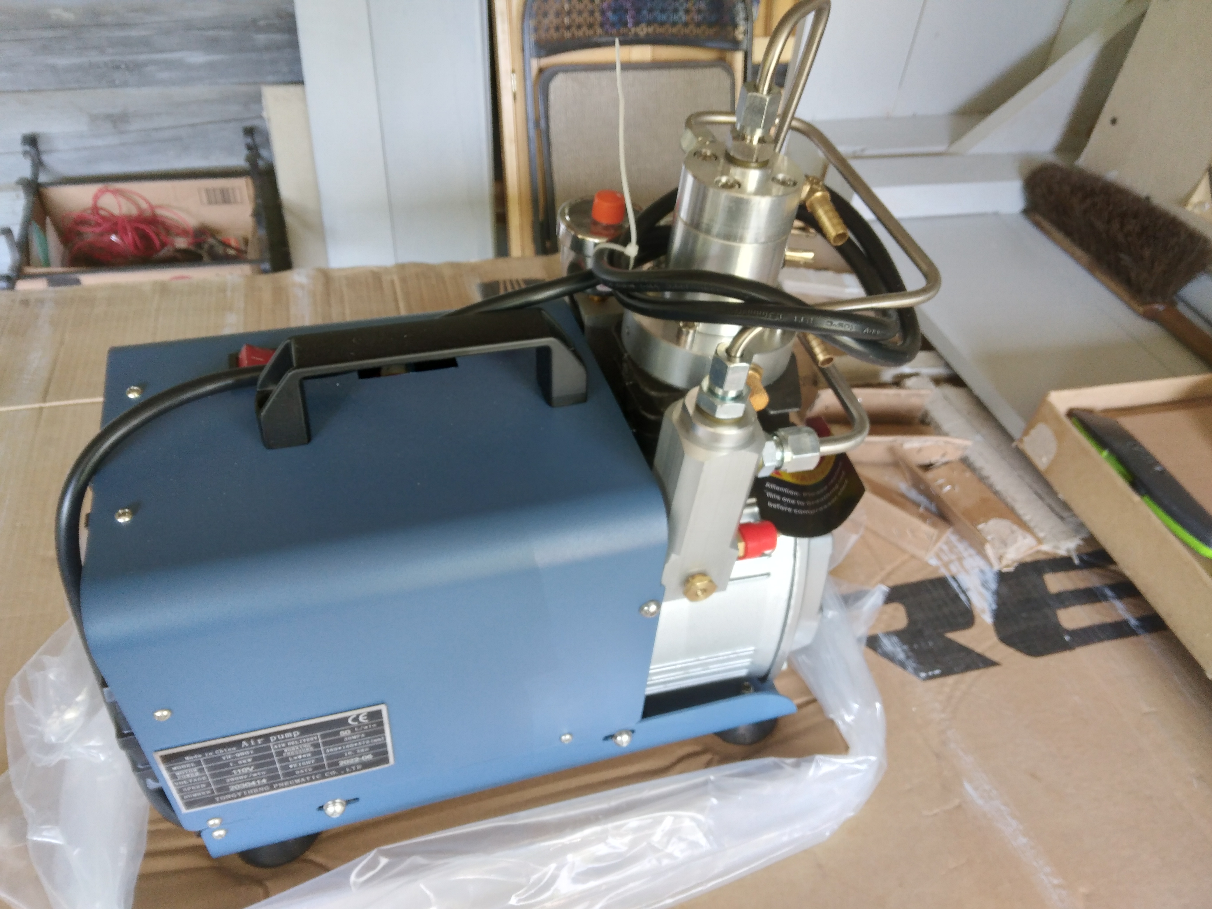

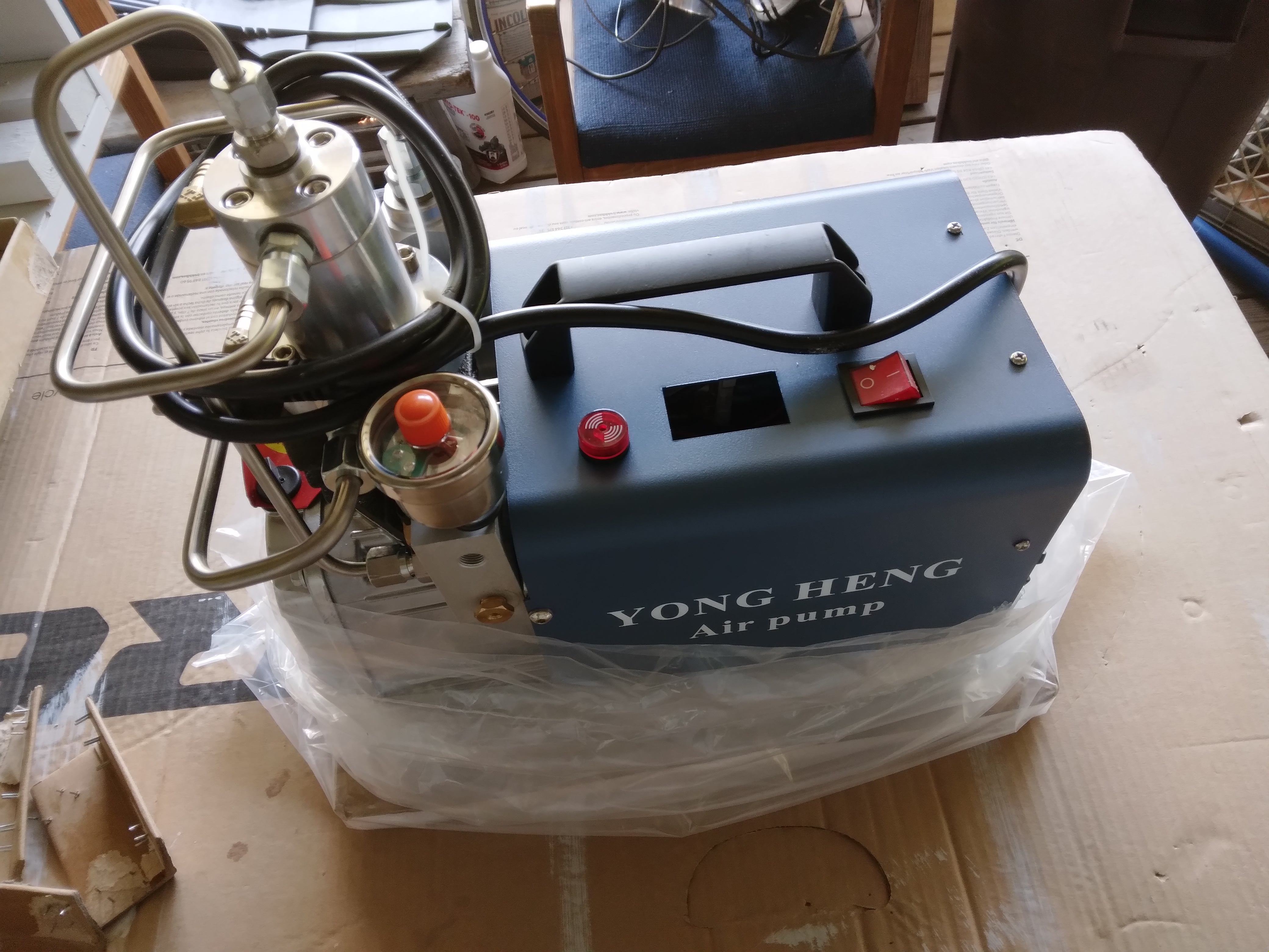

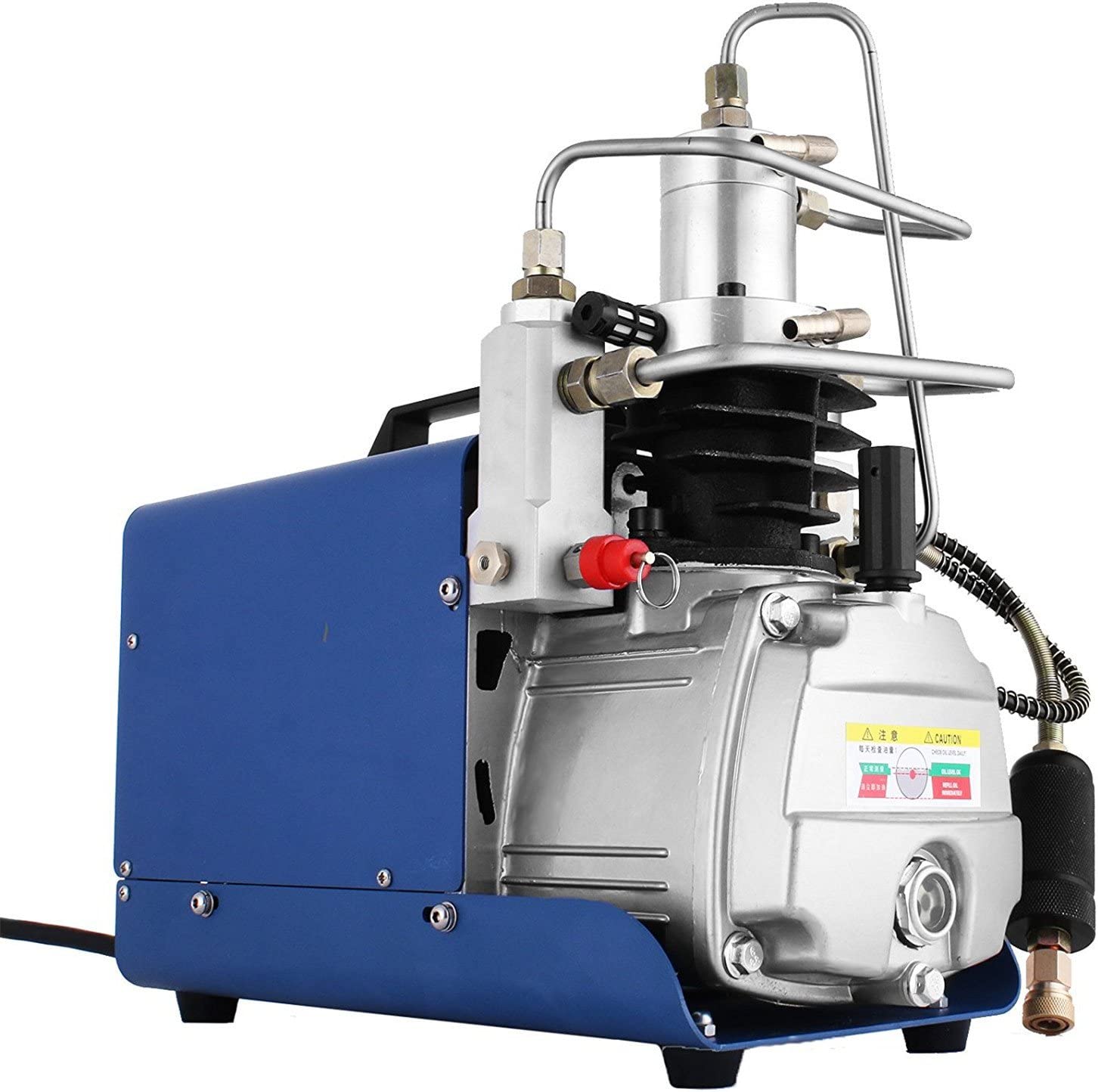

It should be arriving tomorrow. 71+-giEua5L._AC_SL1500_.jpg71SRonZSWeL._AC_SL1500_.jpg81ACqblWkzL._AC_SL1500_.jpg71E0-+jlPvL._AC_SL1500_.jpg

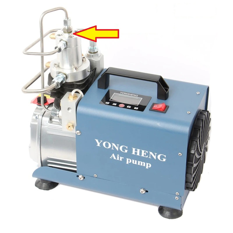

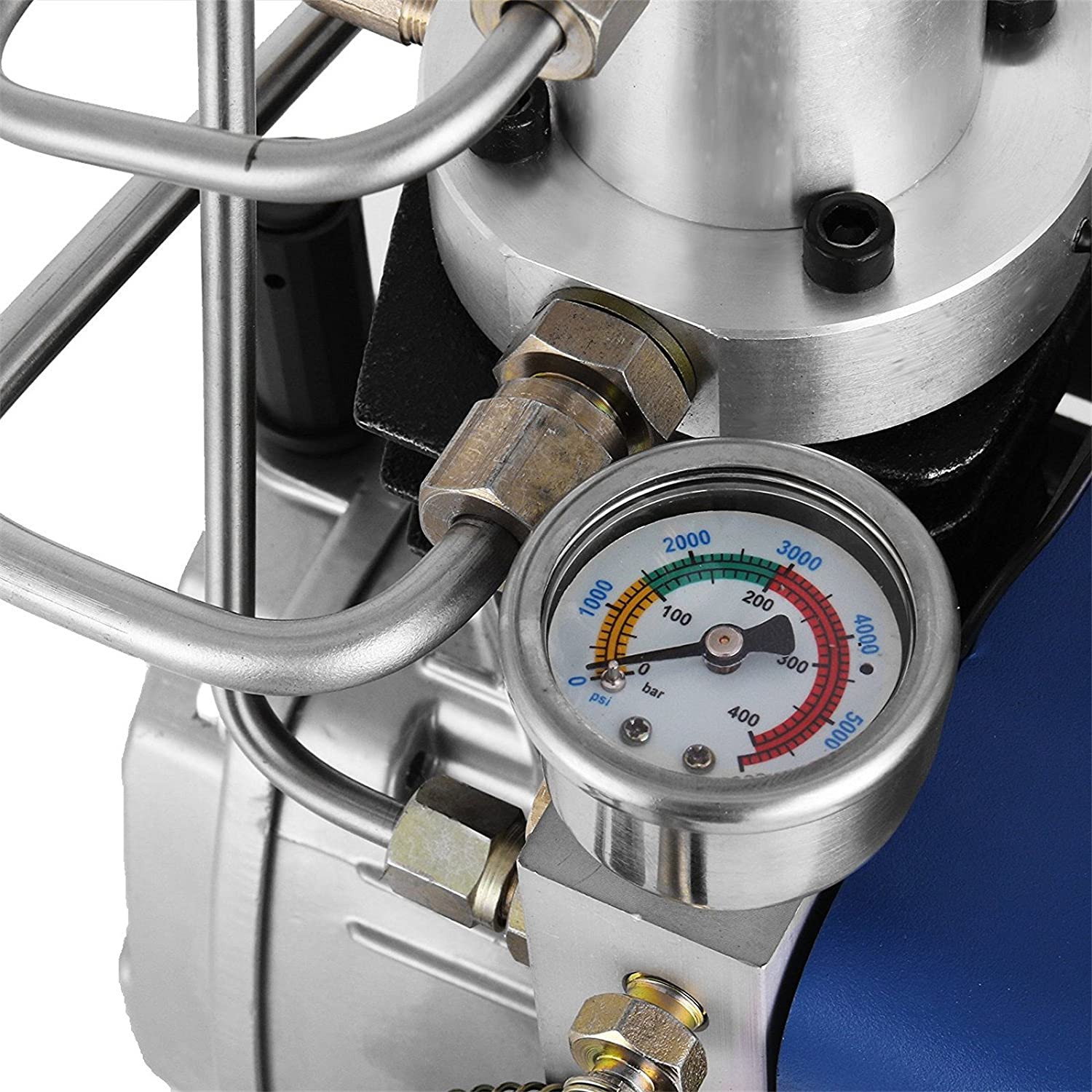

OK, so not a digital Yong Heng. If advertising photos are to be believed (sellers infamous for playing fast and loose) you have a Hardcover model. Set Pressure and Auto-Stop models have a red plastic knob in middle of gauge glass face and a Simple model has no Cyclonic Water Seperator, clearly visible in #2 photo. You've chosen well, fingers crossed it's the real deal. WM

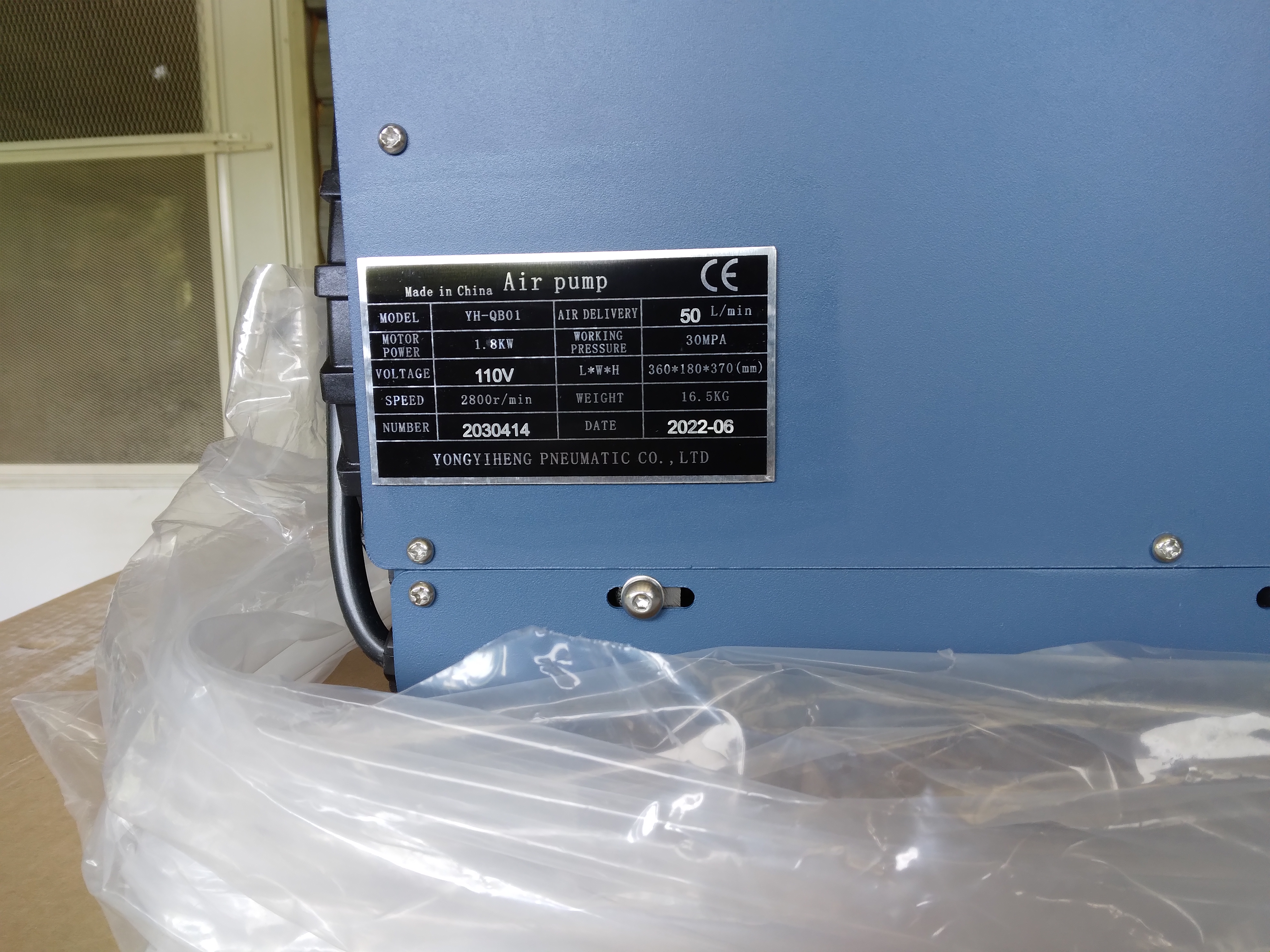

Alpine,
Congratulations, zooming in on metal ID plate I see YongyIheng Pneumatic Company, a good sign it's authentic. The white-lettered "Yong Heng," on compressor side, is another clue of authenticity. Looks just like mine, a Set Pressure Model. 10mm is thread size of hoses and fittings. White, Delrin "donut" washers, at the base of threaded holes, provide sealing as hoses, gauges and brass fittings tighten against, no Teflon tape needed. Check out "spare parts" bag, several Delrin washers included. Here's my set-up, be glad to help, just "reply" to one of my posts so I'll be alerted. WM
