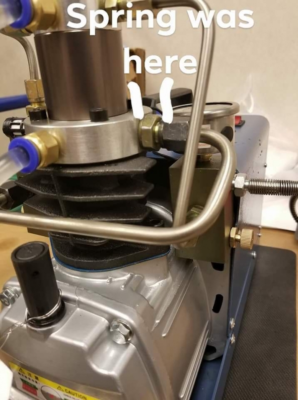

Are you getting any pressure? Mine would stop building around 1000psi. A spring was broken at the low pressure check valve
Mine has worked great until yesterday. Tore 95 % of it apart and both pistons, rings, reed tab, and last check valve inthe top, below burst disc all look good. I didn't take the inner fitting out that holds the low pressure check valve. (didn't know it was in there). I'll look soon & let you know what I find. Any other hidden valves? Thanks for the pic & tip Csexton, it might help both of us. Good luck dark1961. Don't be afraid to open things up, pretty simple design, just dont over tighten your front case bolts. Case is aluminum
