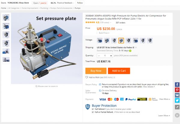

Ok Dark thanks for the information on identifiers for a true YH compressor. I purchased one from the YH factory in China or at least that is what the listed said, see below.
https://www.aliexpress.com/item/300BAR-30MPA-4500PSI-High-Pressure-Air-Pump-Electric-Air-Compressor-for-Pneumatic-Airgun-Scuba-Rifle-PCP/32815880523.html?spm=a2g0s.9042311.0.0.61ad4c4dLjj7d
Hi Haji, I also bought mine from the same seller, they where very quick to ship it and I have it know for over a year now, hasn't give me any problems, I mainly use to top off my rifles when I go to the range, just keep it below 60ºC and runs like a kitten !!!!, very good compressor, as a side note, I've found that the PSI gage is around 20 BARs off,so be careful!.
