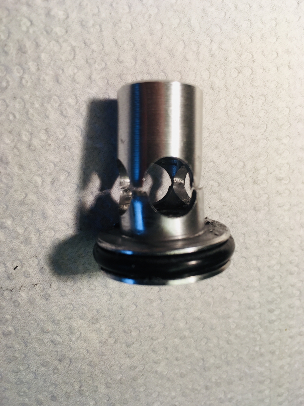

I put air strippers in my superlight shrouds. Or at least a crude version of what can even fit in there. There's not much room.
I'll post a photo of that in a bit.
As for the mods, any of them will affect harmonics. So, in theory, if the gun is tuned to one specifically, you should be able to get the same accuracy. But we know the world just ain't that simple. So, only trying to do what I described would tell you if that's the case or not.

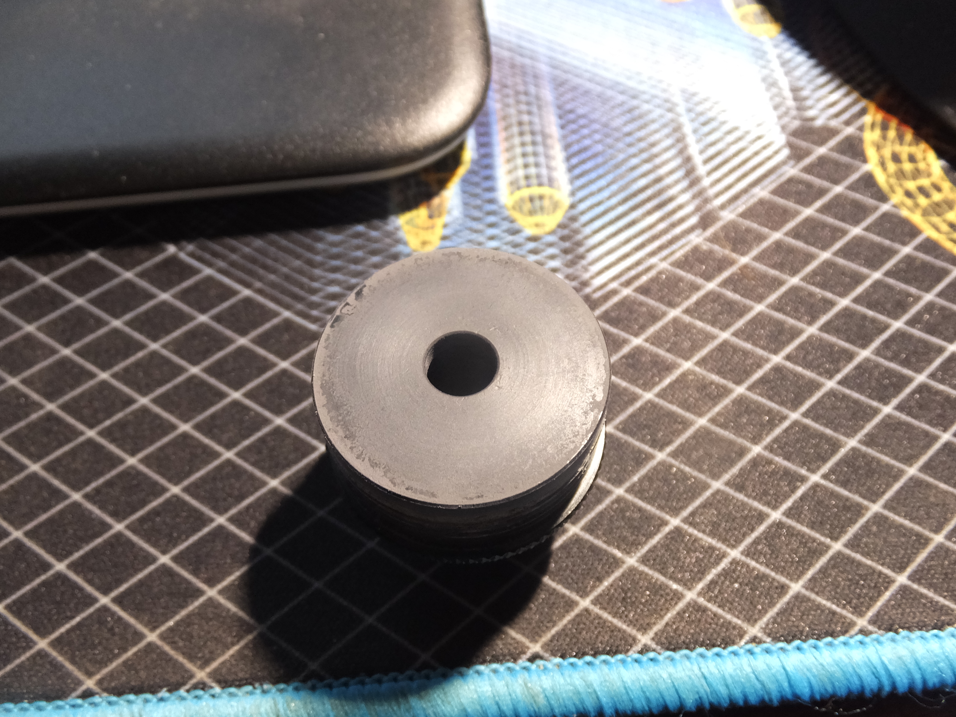

Shroud sized delrin disc. 6.5mm bore, bonded to rear of endcap/thread adaptor
LGD would a stripper work inside the shroud being the air is still retained in the shroud? I fully admit I don’t know how half of this stuff works so it’s an honest question.
And yes, the tune/harmonics I 100% agree with. The current tune was done last year in 70-80 degree temps with the Fat Boy on it. Was running just under 890 fps was just as good if not better than the Sumo. For kicks after I made the post I bumped the reg 5 bar and gave it 2 clicks on the wheel to get me back to 890 and I tested the Fat Boy, Sumo, and 0db again and they were all making ragged hole 10 shot groups.

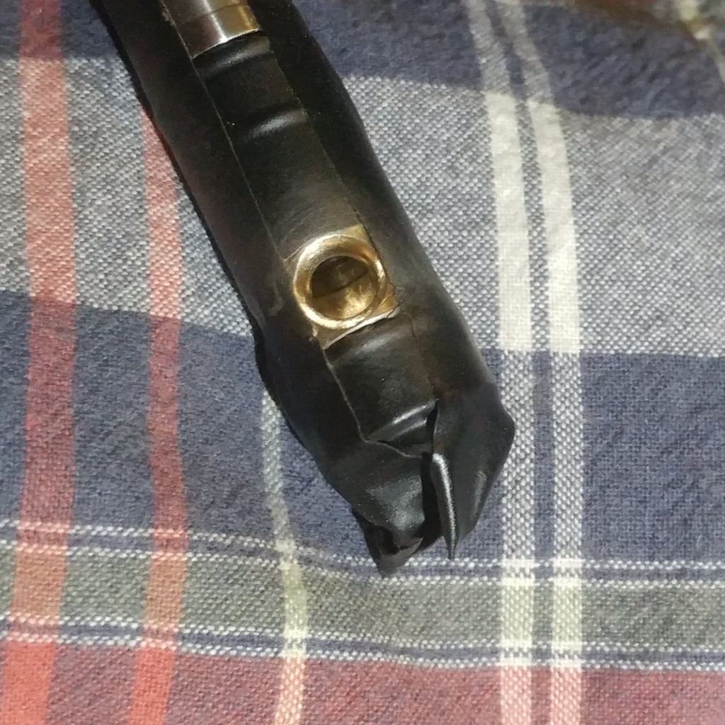

Sure. The older crown barrels actually had a more standard air stripper inside the shroud. Wouldn't strip as much air as one that is external, but still some which is more than none. As to how much it helps, or how much stripping it does, who knows. But those barrels tend to be extremely accurate. The bore in the end of my superlight shroud was over 9mm iirc, and the liner exit bore is very close to it, so although the shroud is active, I figured it wasn't doing as much as it could to contain some of the pressure. Main idea was to reduce noise signature but figured it couldn't hurt accuracy either. Likely help. But again, the 380mm pellet A barrel has always been a laser. Really hard to tell any change in accuracy unless it's over long distances. Normally I only shoot to about 30 yards. But I've used it and made clean head shots on squirrel out to 70. Mine has a standard circular port, but is bellmouthed to match the .30 transfer port in the gun. Picked up 50fps on factory tune. In the short barrel. Runs about 960fps @ 130 bar with 16gr aa pellets or 930 with 18gr jsb. Both as accurate as I can ask for. Don't know if the in shroud baffle helped since it's always shot so well. I more or less tuned the gun a long time ago to run in an efficiency plateu within its potential power band.

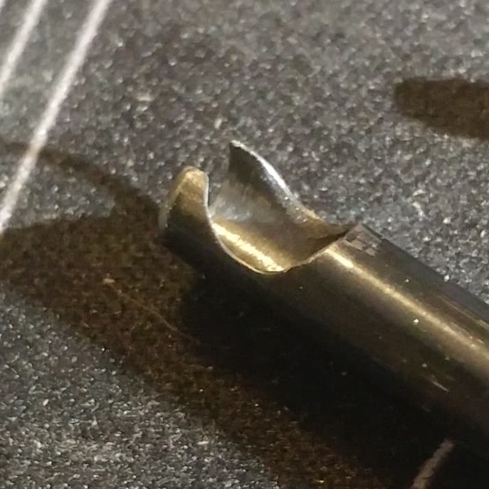

Here is also a pic of the older air stripper that the superlight barrels do not have. Only photo I could find is of a broken one. (not mine) I have a 600mm .30 barrel like this, but no photos of inside it.

Here is also a pic of the older air stripper that the superlight barrels do not have. Only photo I could find is of a broken one. (not mine) I have a 600mm .30 barrel like this, but no photos of inside it. View attachment 442015
