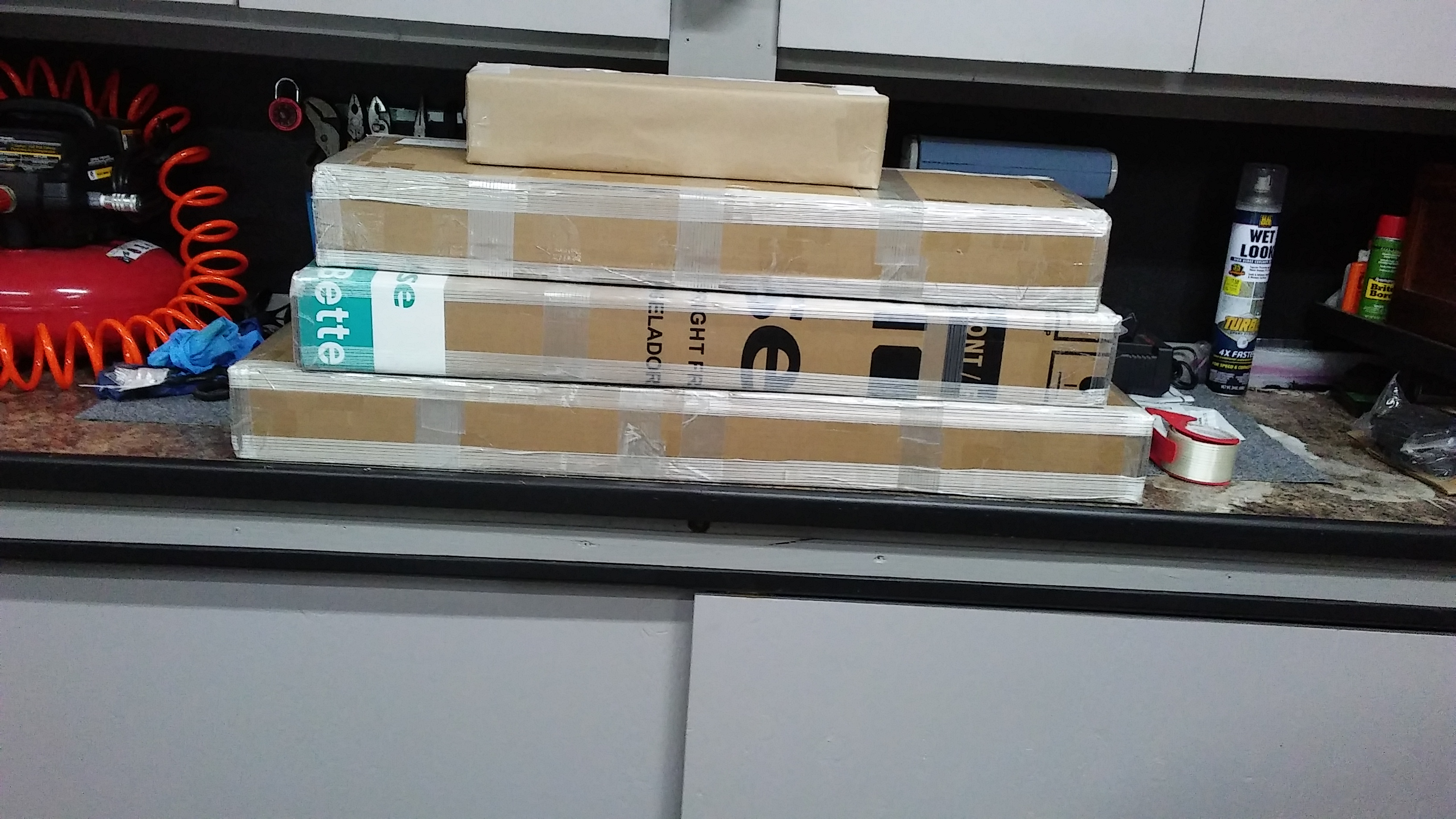

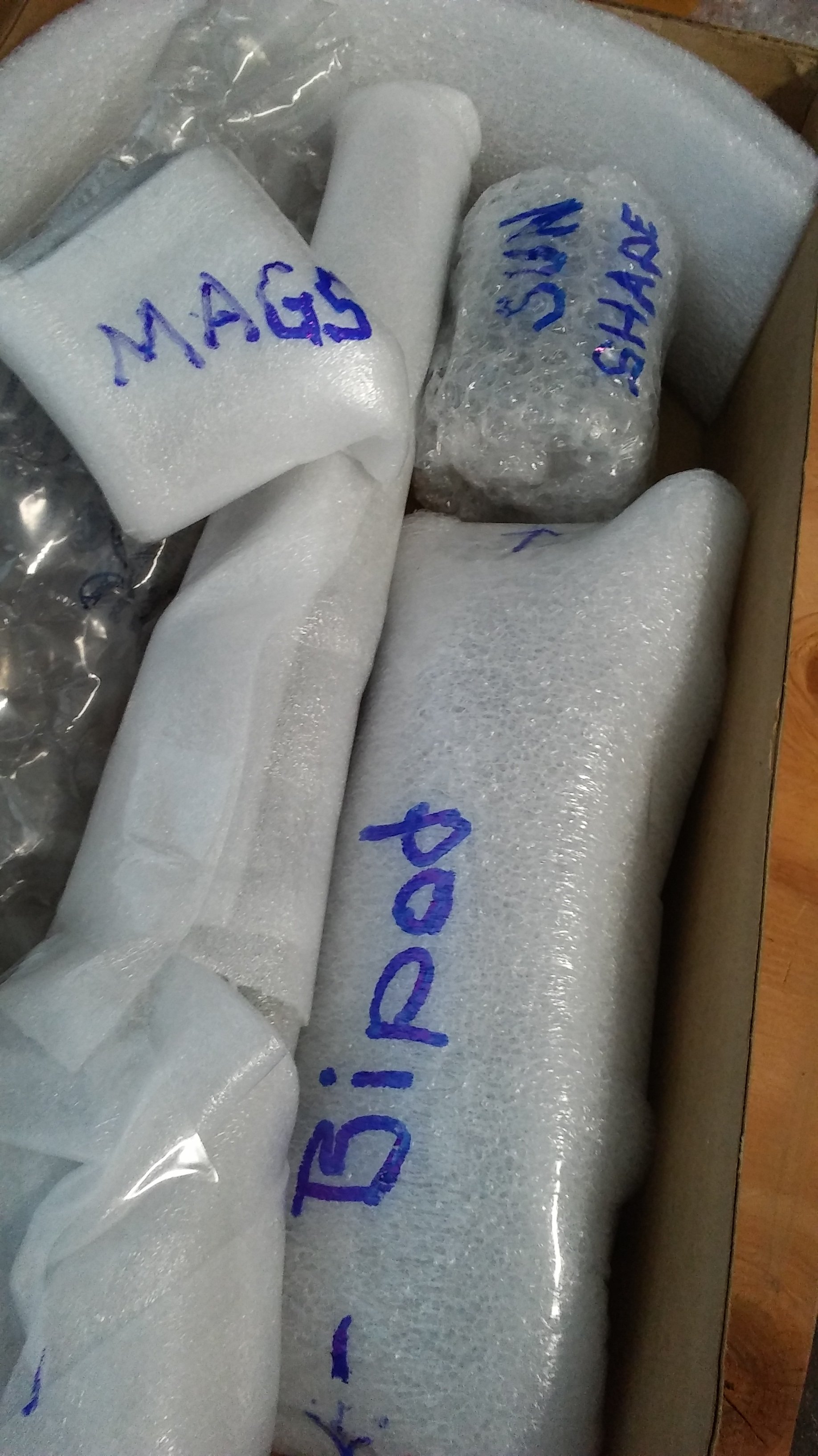

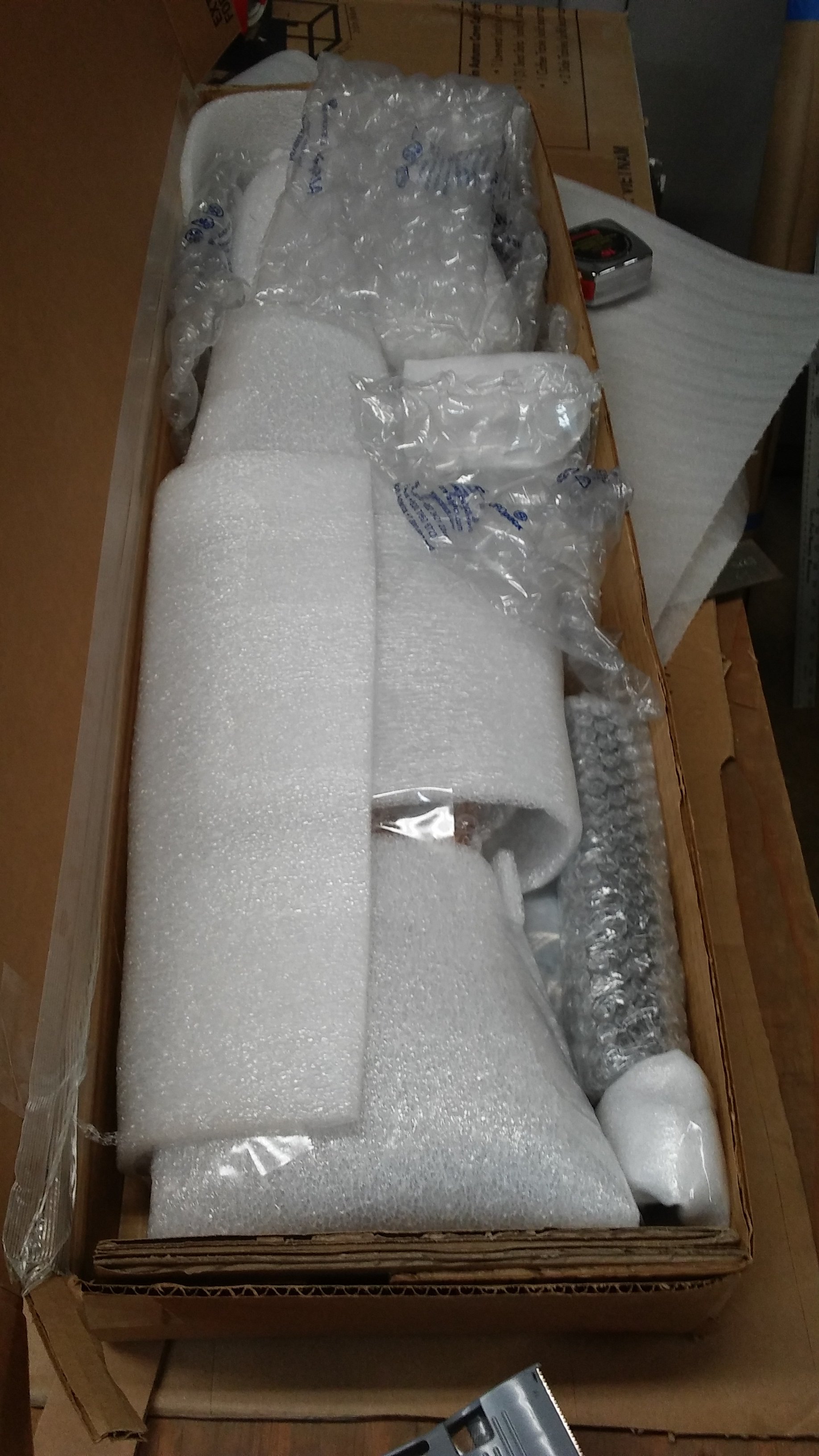

Luckily I have access to a variety of packing and shipping supplies from work. Anyone who has received anything from me here has been supplied with a year supply of 1 inch bubble wrap after unpacking. Items I have for sale now are double boxed and accessories separate in another box packed tight with bubble.
Edit to add I also have sent pics and explained how it’s packed before shipping as well.

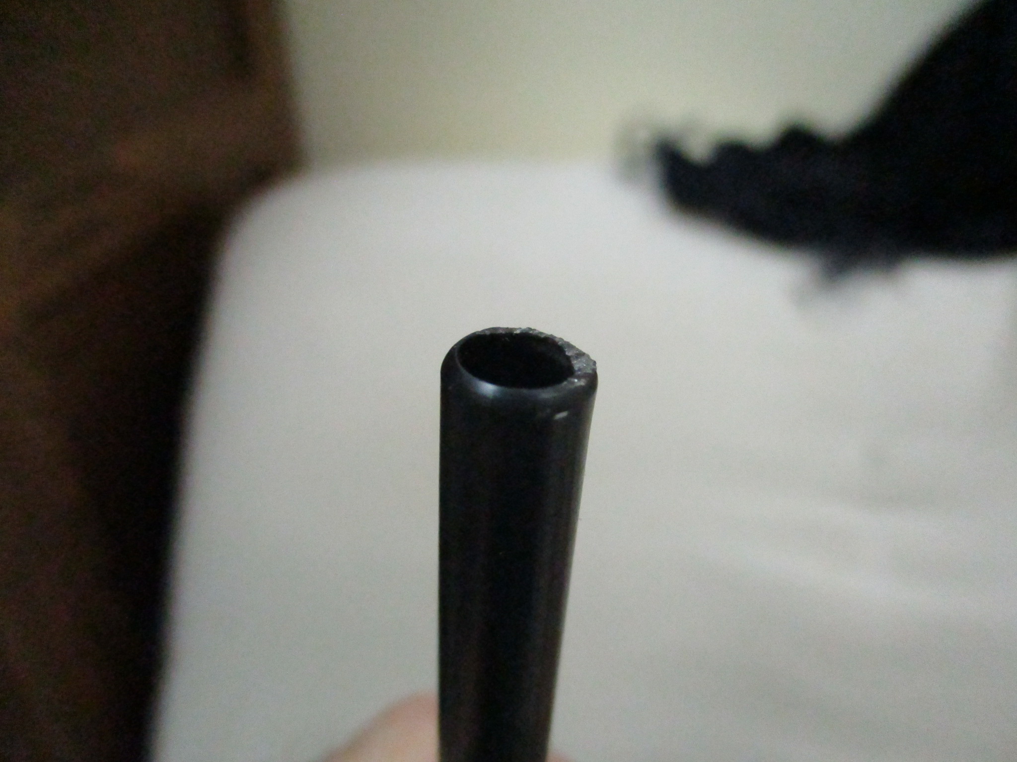

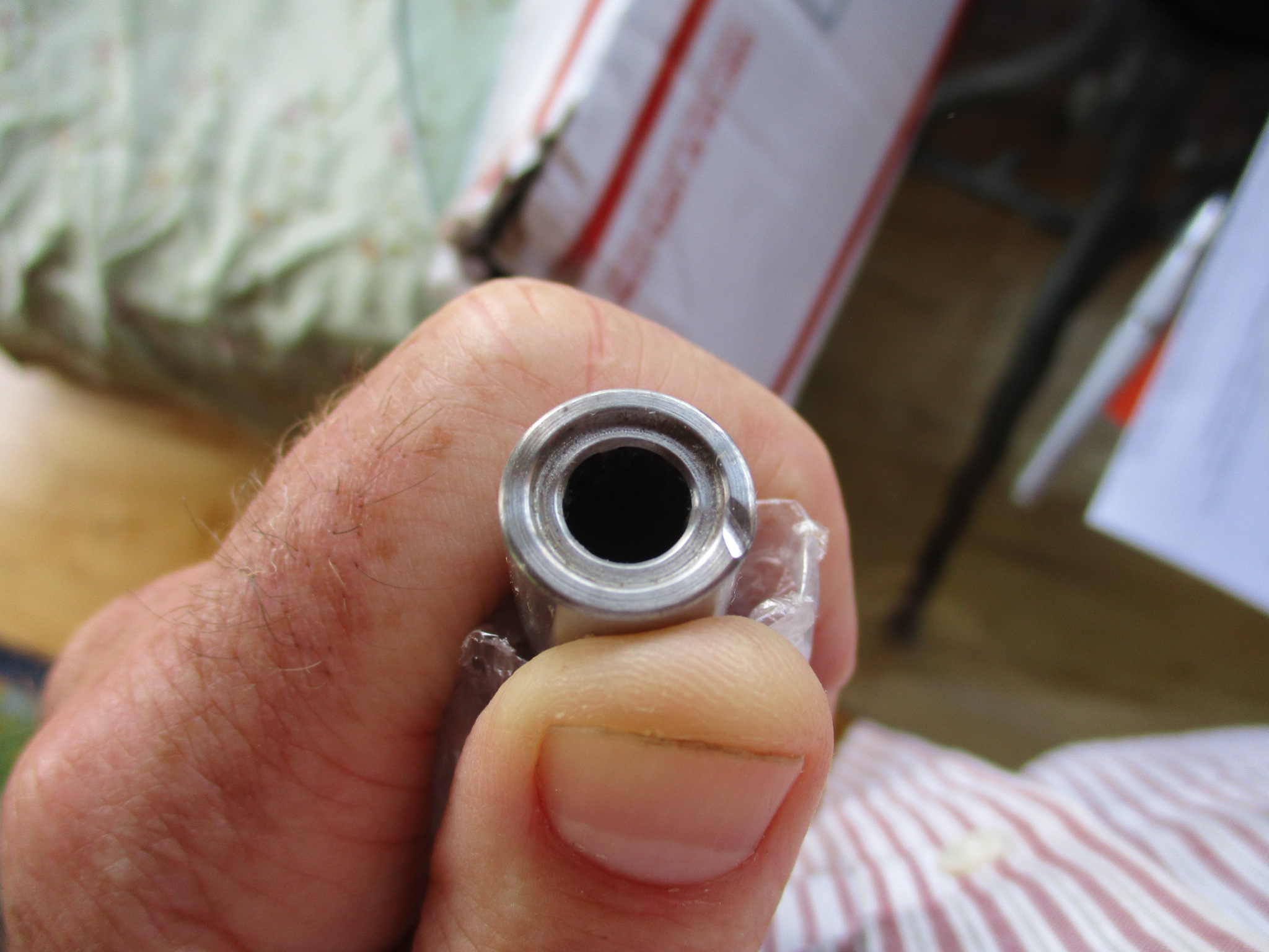

These barrels were packed and shipped to me from respected online retailers:
Both poked through inadequate packing, basically loose in mailing tubes with plastic end caps and tape, and then on through their loose secondary boxes that could not contain anything pokey. Those mailing tubes are designed to hold paper documents, not heavy steel that can move and slowly hammer through. A third barrel poked all the way through, kept going and is probably still rolling around UPS' warehouse.
Fortunately, with a little dressing they shoot just fine. I kept them rather than risk getting a worse replacement, but they look fugly.

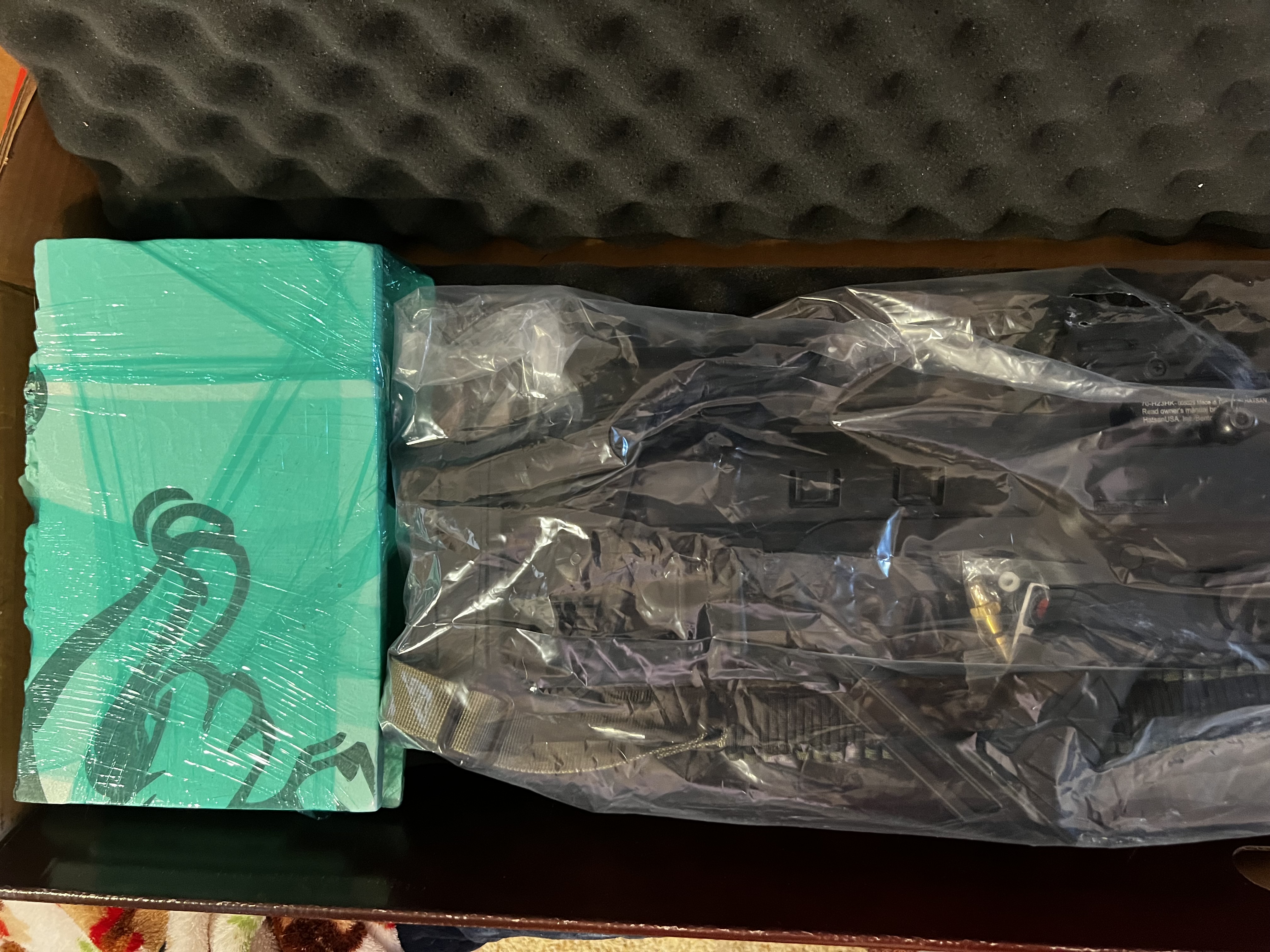

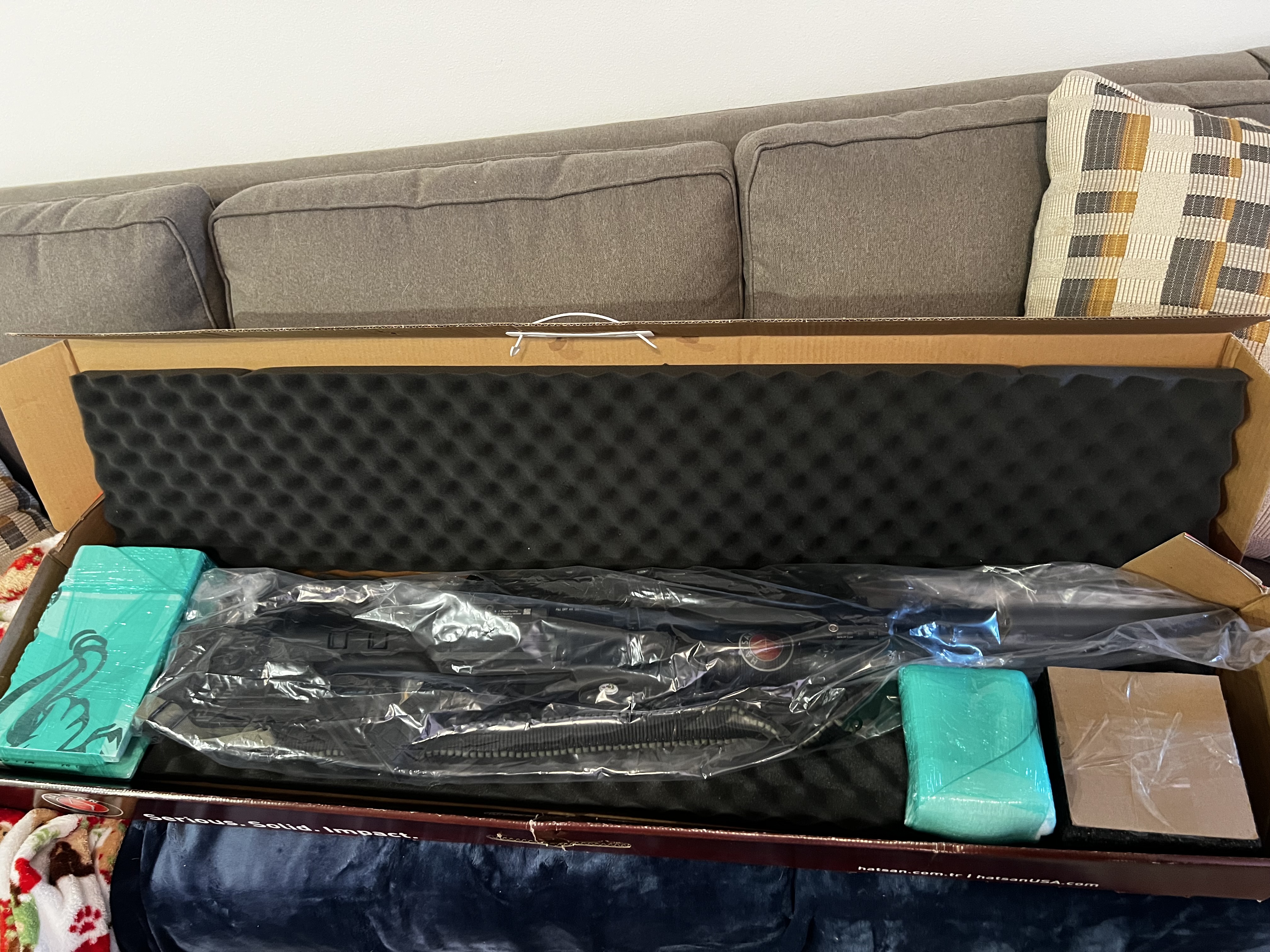

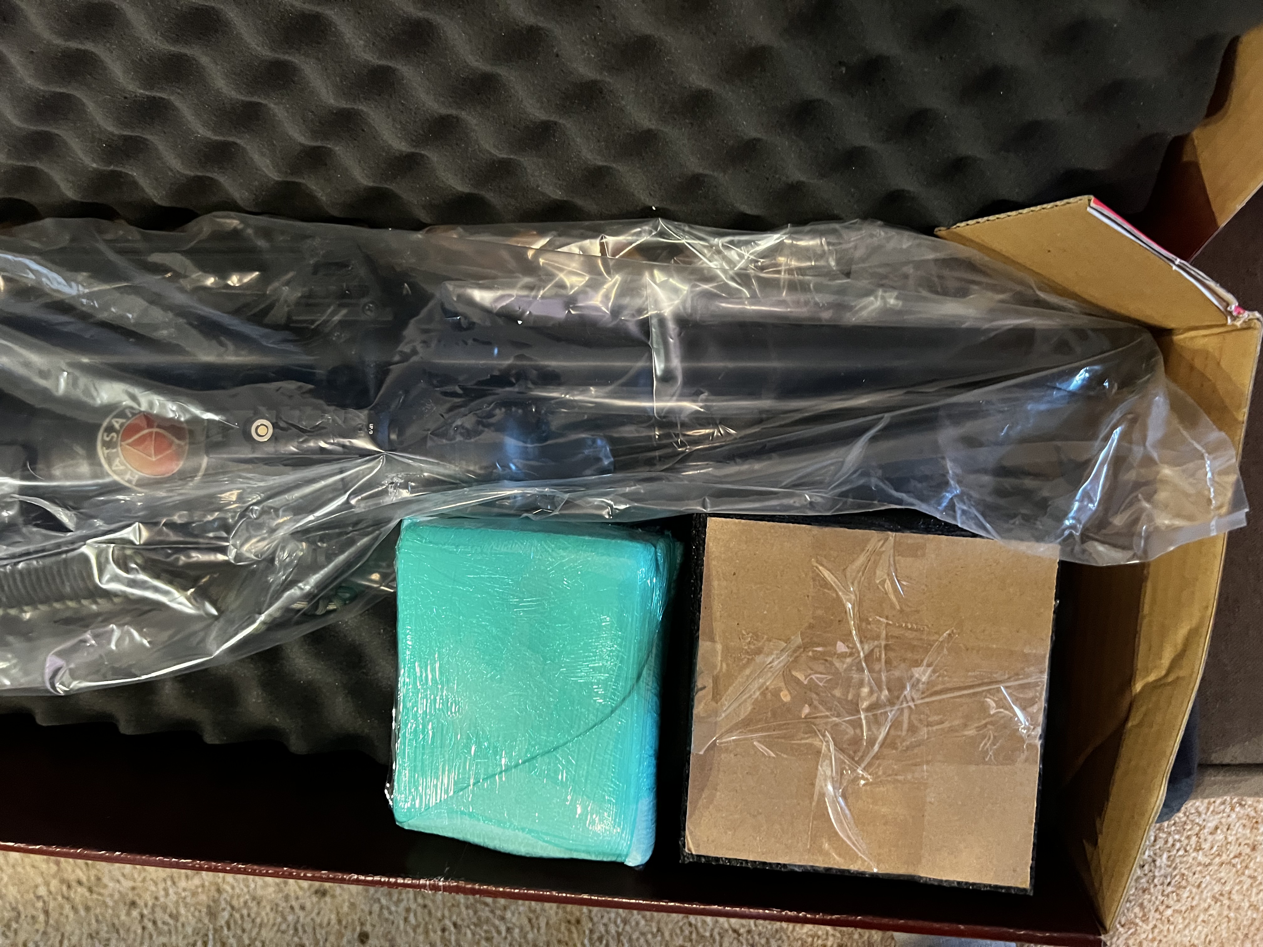

Gun cases don’t work. The gun moves around too much between the padding. I received a gun that had broken through the plastic case.

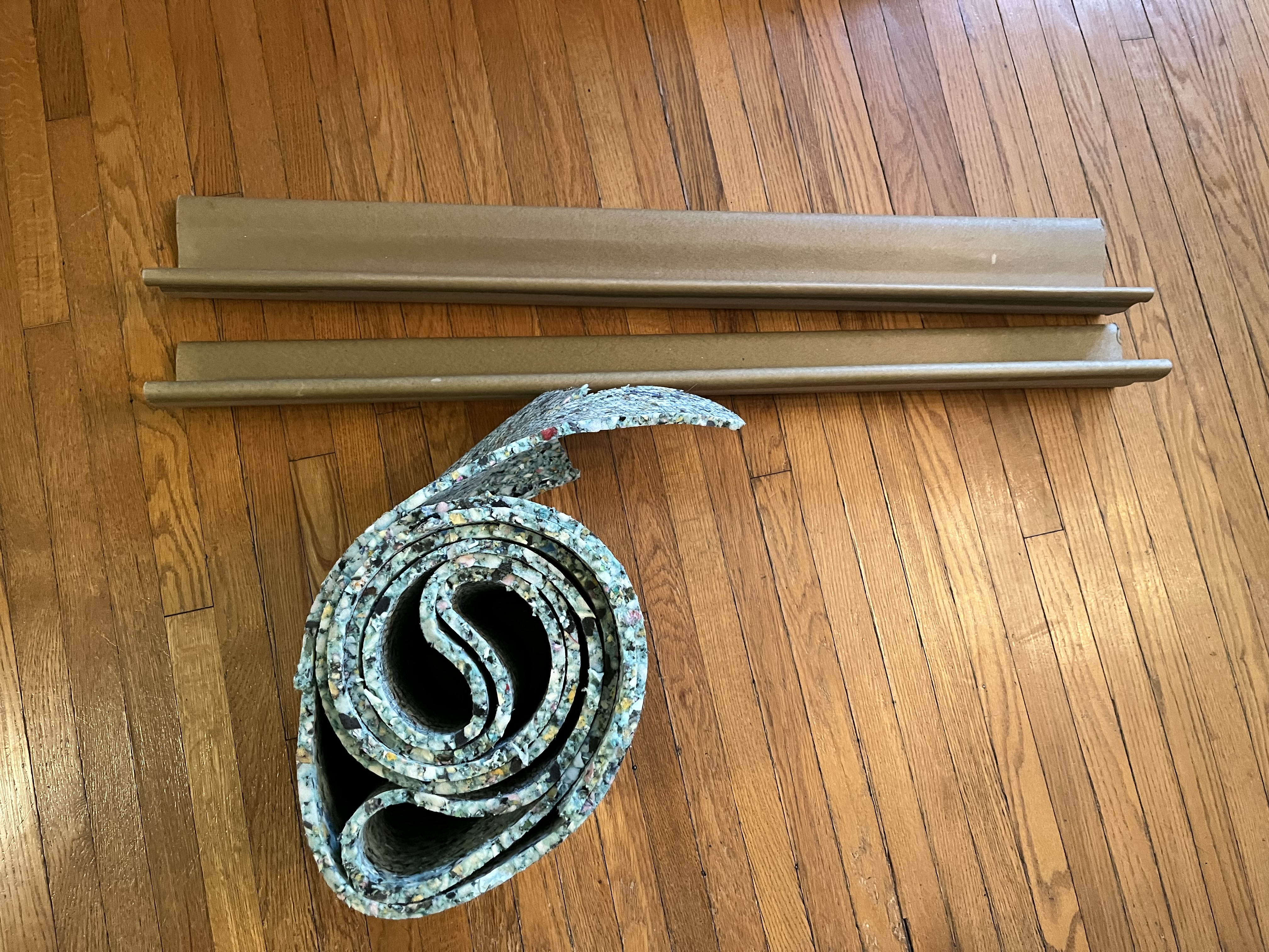

I use a good cardboard box. Wipe the gun down with Ballistol. Wrap the gun in carpet padding.

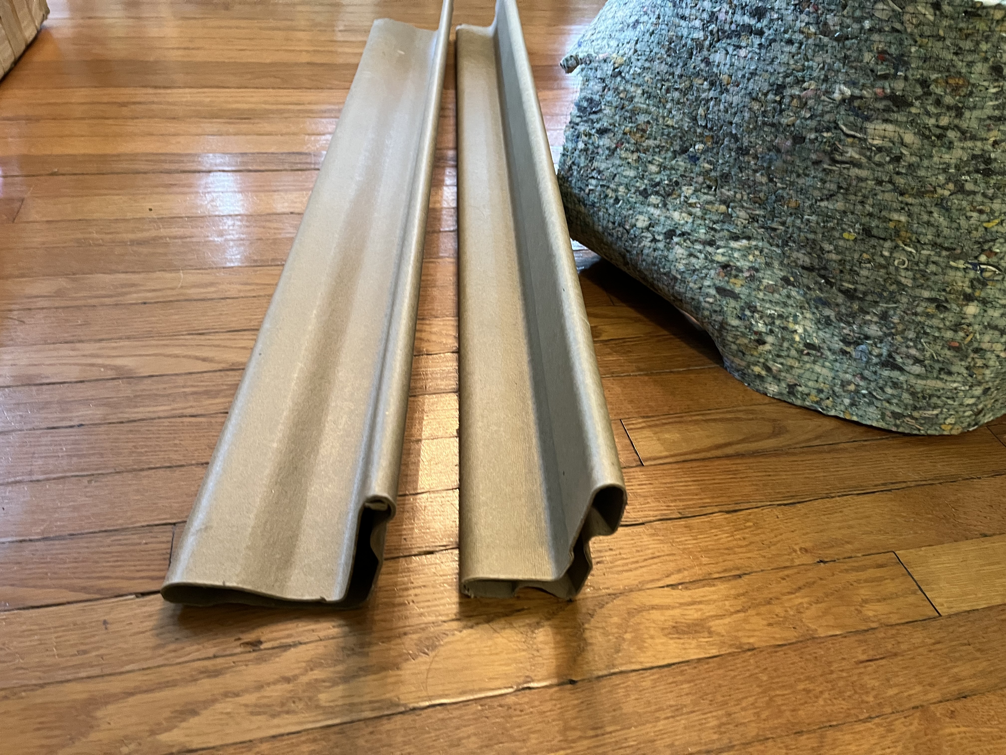

Then reinforce the box with the stiff cardboard angle that appliances and cabinets are shipped with. Add extra cardboard to the ends

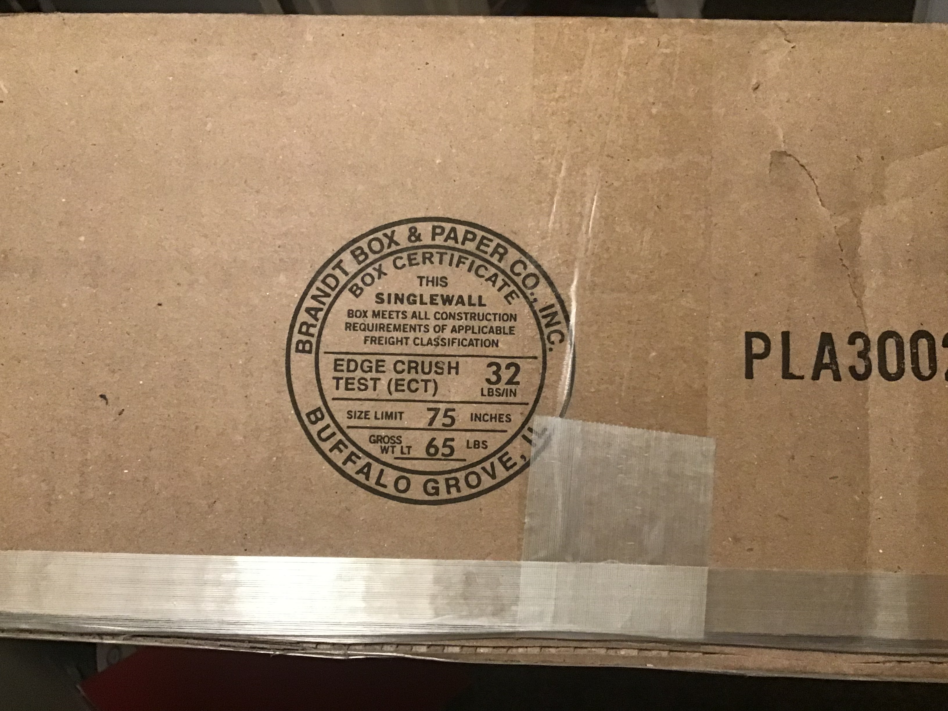

Shipping boxes will have a stamp on one of the flaps to tell you the "Crush" resistance. If what you have inside the box is heavier than the "Crush" #, that box will likely tear apart. If it does not have the stamp, it wasn’t meant for shipping.
