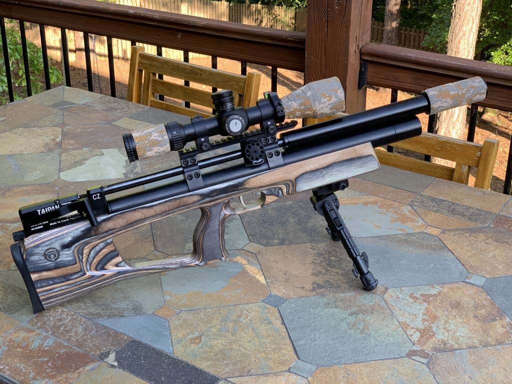

- Taipan Veteran: Solid, accurate, quiet out of the box, reliable. It will bore you to death as all you do is shoot it. Cons: Watch the anti double feed when shooting low power. Below a certain level the magazine will stop indexing. This can be true with lead free pellets also due to their light weight. (Have chickens wandering about so I shoot tin pellets often.) The compact model has a shorter LOP. Standard is longer at both ends. Of course the long is huge.

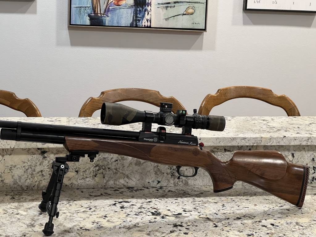

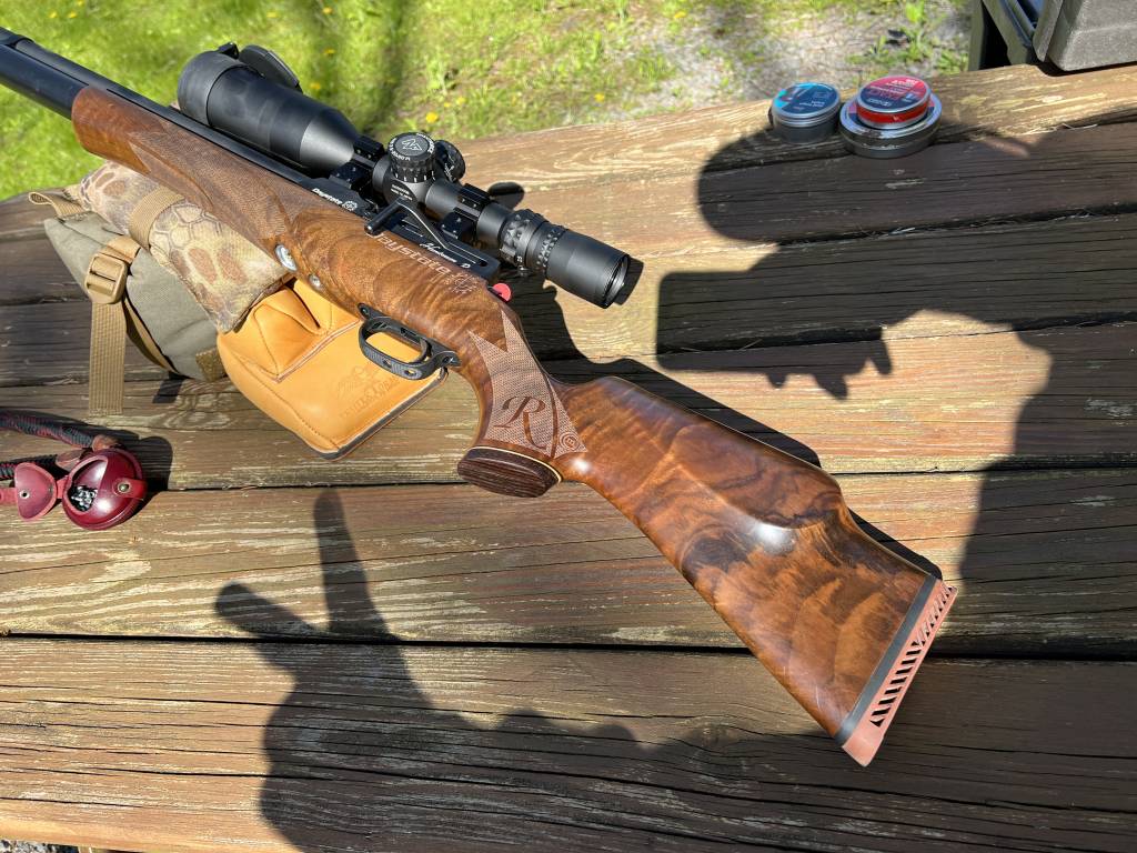

Of the half dozen I've owned, the Huntsman Revere is my favorite. It's not loud by any means (certainly backyard quiet with the small 0db moderator), but not the quietest I've shot or been around. Knew before buying I'd likely be happy performance, but am still a bit stunned at just how accurate it is. Form factor similar to your Dreamline Classic.
Lots of good choices out there... HW 100 was also on my list before I decided on the Revere. I'm sure I would've been happy with it as well, everyone that has one seems to love it.
