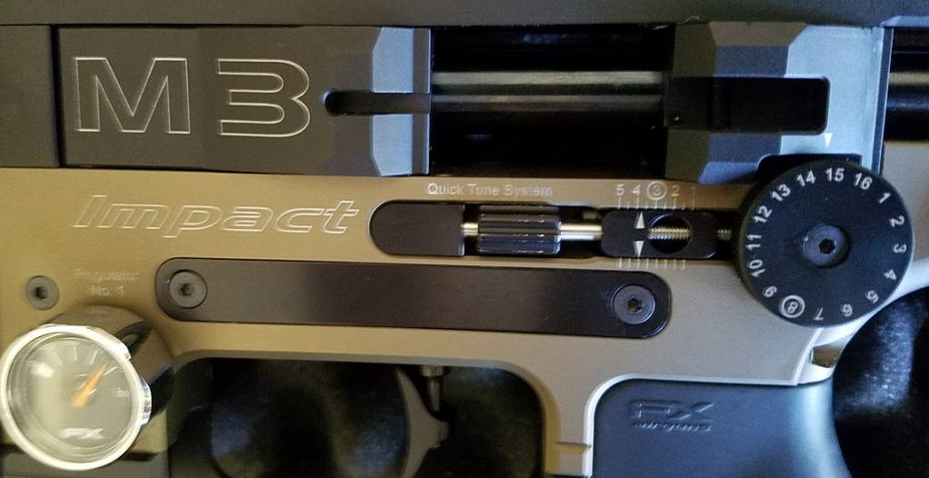

Hey guys. I have an M3 .22 tuned for 25.39gr JSB's. It looks like this:
Reg 1: 160 bar / Reg 2 130 / Quik Tune: 3.75 / Dial: 15
for 25.39gr JSB (stock 700mm barrel/liner)

Joining this party with my first setup.
M3 .22 600mm Superior Liner, stock standard, "P" Transfer port.
1st Reg 160
2nd Reg 130
Power Wheel 12
Adjuster 3,8
Valve on Line 4
NSA Slugs 20.2gr .218 @ 1030 fps
The goal of this tune is to shoot the NSA, FX Hybrids, JSB Pellets and H&N Baracudas with only turning the PowerWheel, leaving everything else where it is.
Will update this post as i try more projectiles with that tune.
update:
Same tune shooting the JSB Exact Jumbo Heavy 18.13gr @900fps with power wheel on Nr. 4 and the H&N Baracuda 21.1gr @ 900fps on Power Wheel Nr. 8.
Will try the FX Hybrids today in the evening. Whats their preferred velocity? 950-1000 ?

Mine is set at 175 first reg, 130 2nd reg, macro on 16 and micro at 4, valve adjuster just over the 4th line. But unfortunately I’m still getting ES anywhere from 12-15fps. I’ve tried doing a bunch of different things but can’t get the ES down. Shooting 29.5g NSA slugs at around 950fps.
