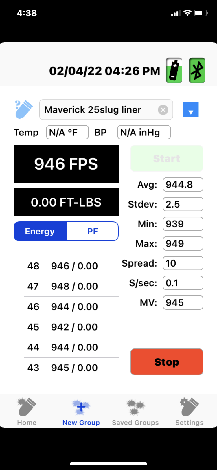

sorry i didn't change over from my maverick but this is a fx m3 700mm barrel is 25 cal 33.95mkii all day long !!!
