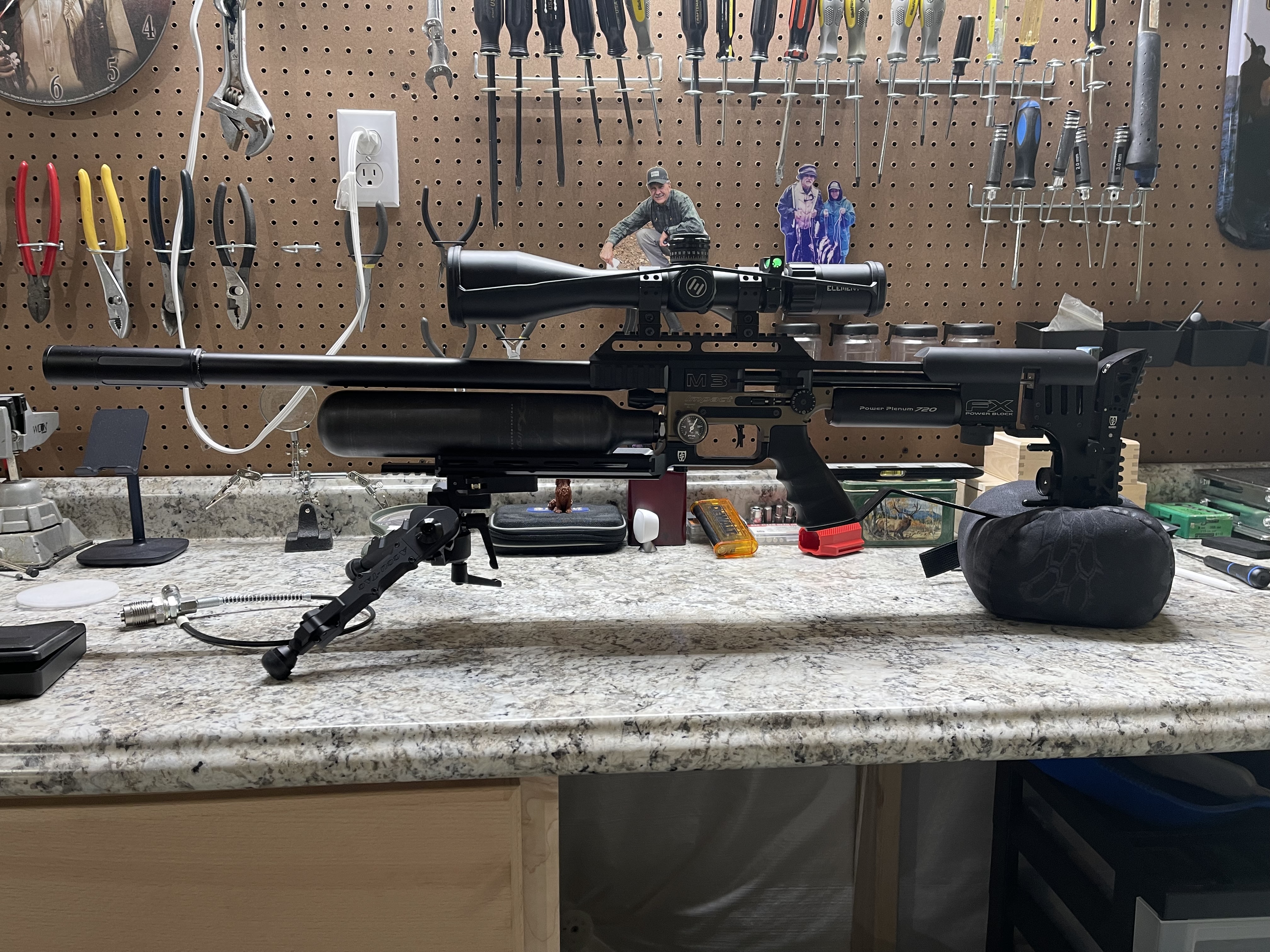

.35 cal
1st reg deleted
2nd reg is a Huma at 190 bar
93 grain .357 NSA slugs in a heavy liner at 930fps.
Installed are Huma power spring, stock valve adjuster spring, 16 gram tungsten hammer, power block, NSA pin probe, huma enlarged transfer port, 700cc alsafe bottle, and a bullet central shroud specifically designed for use with the huma tensioner setup.

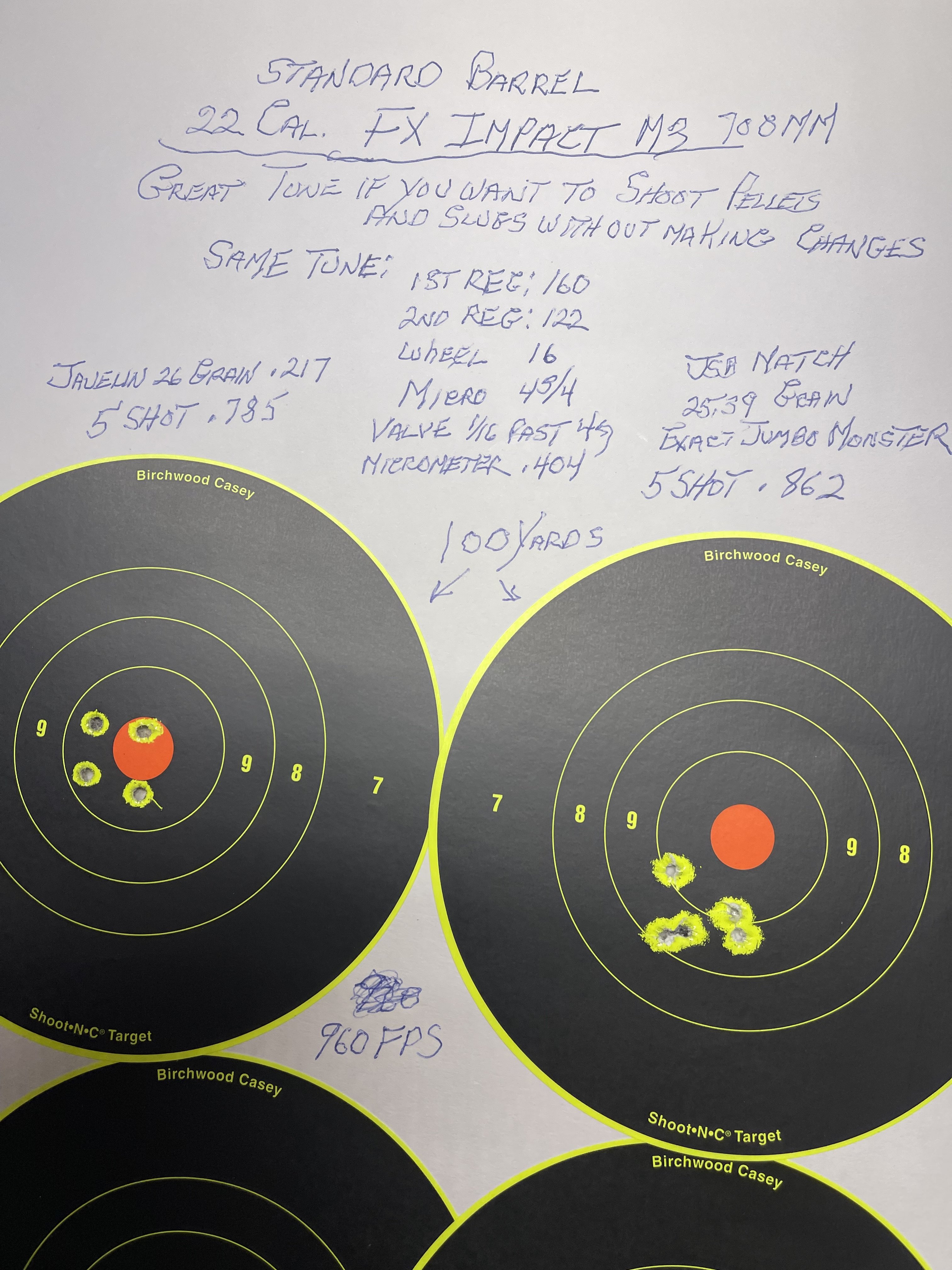

I would like to pass on a tune for a M3 22, caliber 700 mm barrel. What’s great about the tune is that you do not need a slug barrel you can use the standard barrel, but I did put a carbon fiber sleeve in it.. if anybody wants a tune that will shoot a slug and a pellet accurately at 100 yards I have something to pass on. That group that looks like there’s only four shots is truly a five shot group 2 slugs in 1 hole. Let me say one more thing I posted this gun with this tune, shooting knockouts with a sub MOA 100 yard group. It will shoot knockouts good but let me tell you these Javelin 26 grain slugs, at least for me and my rifle will shoot 1 inch groups all day long without flyers. I shot a lot of different slugs in this gun. Nothing was as consistent as the 26 grain javelins. I hope this helps somebody.
Yes please, can you let me know your tune ? Thank you
