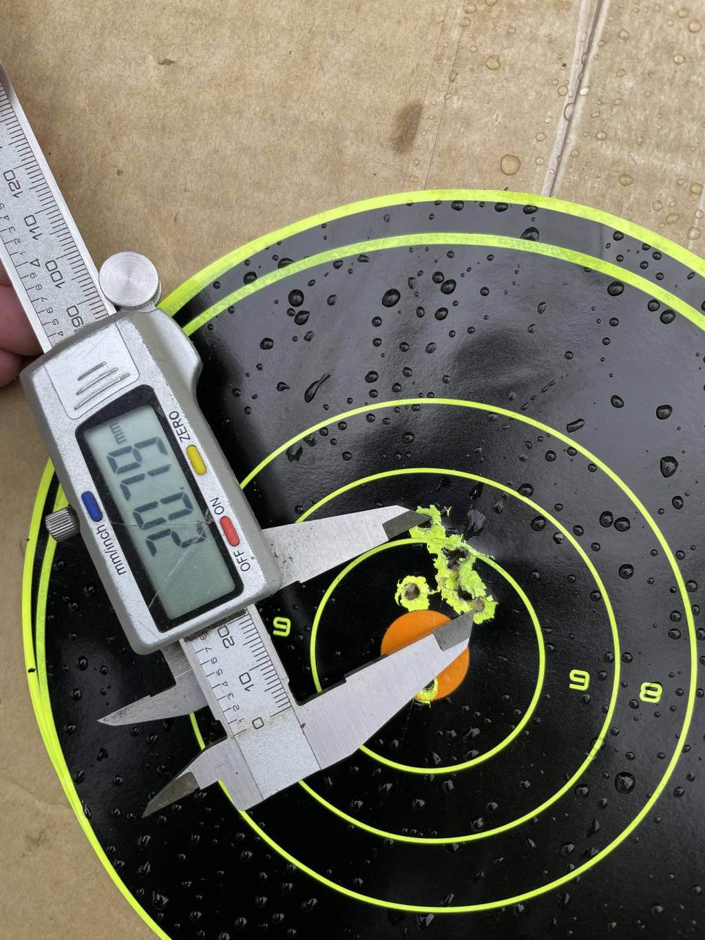

40 yard accurecy 28gr 295 m/s

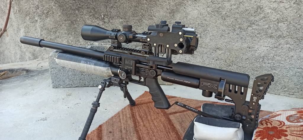

Can you give us some more infos on your m3?
Barrel length, standard or heavy liner, slug power kit?

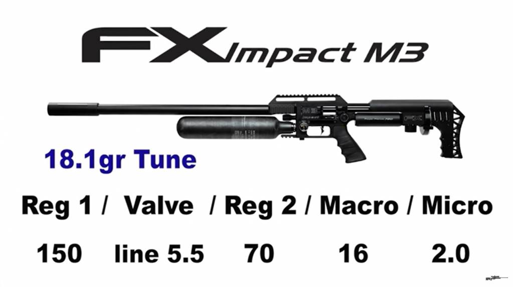

slug pin probe tune
Reg 1 180
Reg 2 150
Macro 8
Micro just passed 4
Valve 11.59mm
at approximately 900fps my groups are shocking
