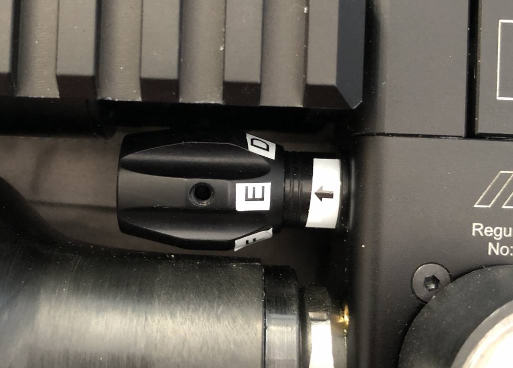

Valve calibration. I'm learning about the the M3 tuning. I noticed the that one full turn of the Valve knob moves from one line to the next (of the 4 lines). There are 6 spokes on the valve knob. I labeled them A-F starting with "A" when the valve knob is precisely on the 1st line of the stem. This has made it a bit easier for me to quickly record and return to previous settings. I had a hard time seeing the calibration lines. Maybe its something that would be helpful to you and make it easier to share tunes?
It controls the duration of the blast of air. That is a very nice feature to have when you have a complicated finicky barrel system. But if guys don’t understand these type of things, I don’t know why they would want to aggravate themselves with a complicated Impact. It is good for pellet and slug sales though.
Yeah. I bought it for the macro and micro wheels and the customization options.
