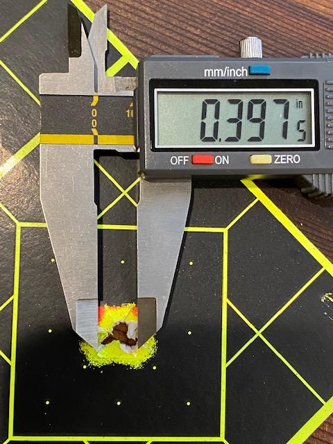

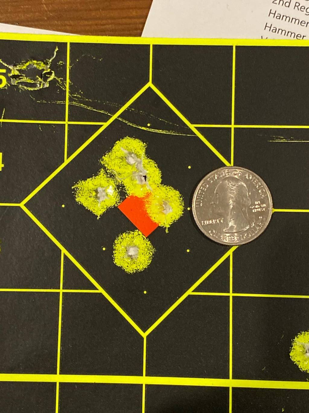

FX Impact M3, .25 caliber, 600mm, DonnyFL Sumo, CF Sleeve
FX 34 grain pellets
1st Reg: 150
2nd Reg: 120
Macro: 14
Micro: 3.75
Valve: 4 or 10.59mm
Avg Velocity: 887.2 fps
Measured 0.3975 inches for a center to center group size of 0.1475 inches. I'll take it!
