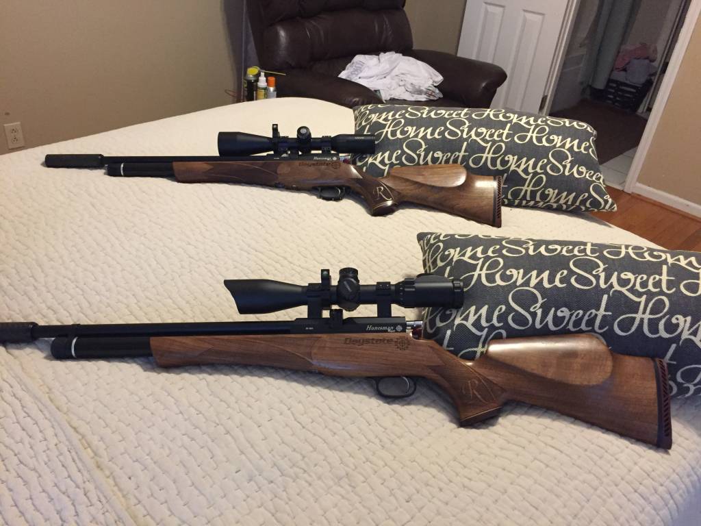

Hello everyone, I’m looking to return to shooting field target and the .177 pcp that I currently have will be replaced.
I’ve been looking at the daystate huntsman revere and the air arms s510. I would appreciate the opinion of those with experience with either rifle.
I currently own another daystate so there is some bias. But a long time ago I owned an air arms shamal.

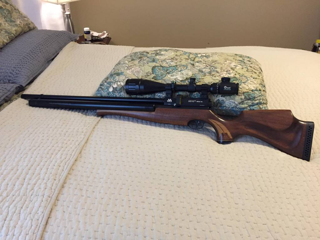

My very first PCP was an Air Arms S510 .25 caliber (unregulated, of course). My next PCP was a Daystate Regal XL.177 caliber. I chose the .177 caliber to get a more backyard friendly air rifle.
Both these rifles are beautiful, very nice styling and boringly accurate. Truth-be-told, I rate the Daystate a tad higher than the AA. My experience with these 2 may not be informative and helpful to you due the caliber difference of the 2 examples I critique.
BTW: I still have the Regal.😉
