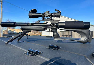

My used TalonP with a Mad Dog Stock and Tatsu Moderator. She is shooting a nice and easy 40 fpe going out ~726+ fps with JSB Exact King heavies. I just bought some Nielsen 38.5gr slugs and plan on pushing them around the same speed, giving me ~45fpe at the muzzle and around 40fpe at 50 yards --- more than enough to do yard work !!
Pic of gun on top and Nielsen 38.5gr slug and JSB 33.95gr Exact King Heavy below that:

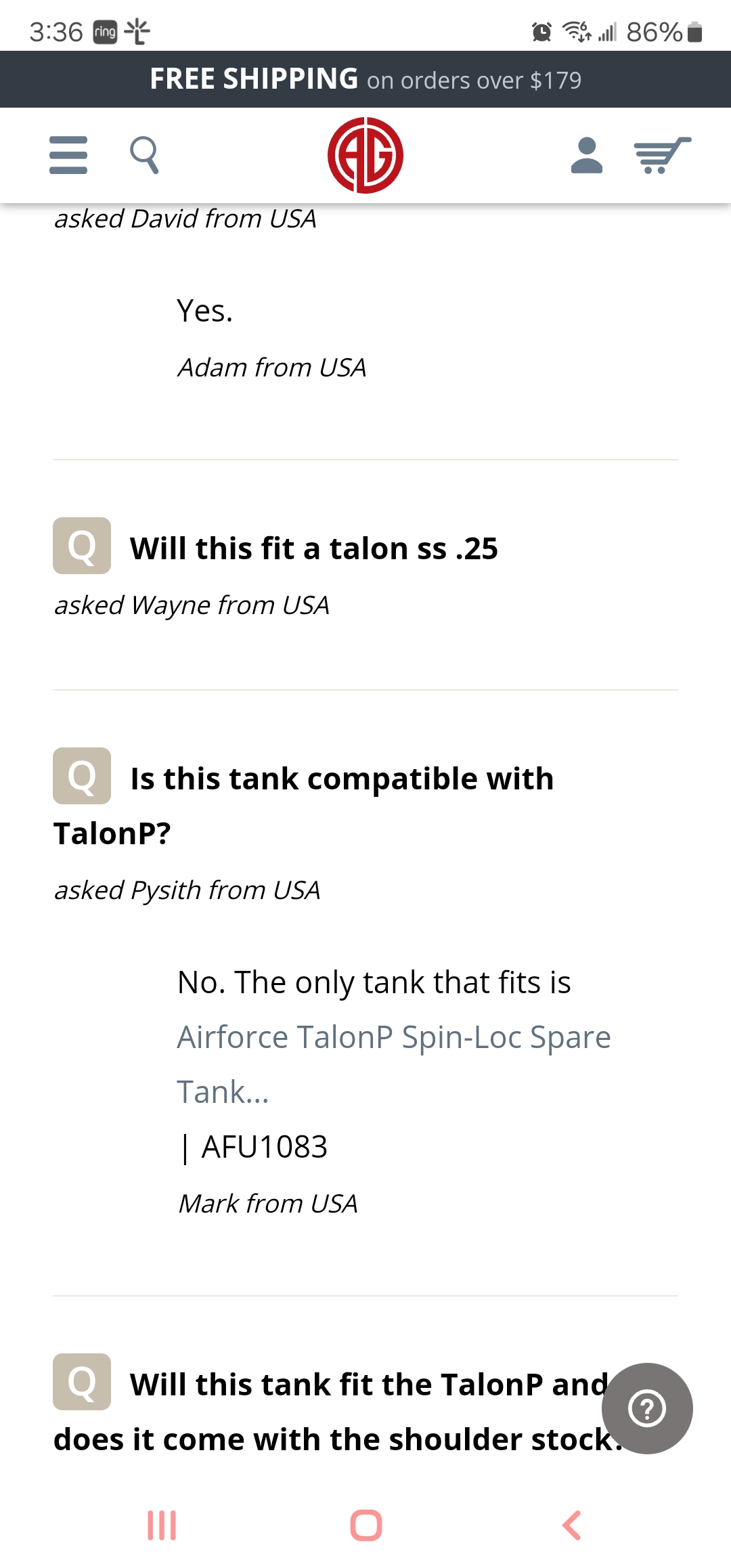

Now this tank fitst in the talonp? I'm reading in other websites even on airgundepot on t thencomment section of this item someoen says it does not fit talonp? So confused
