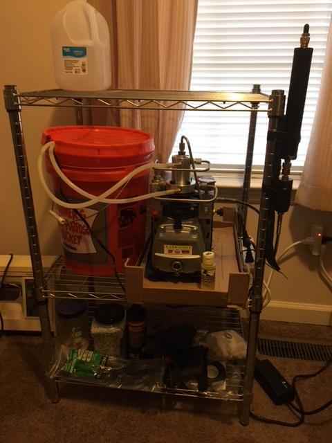

Agree. I top off my Great White (97 cf listed) with a Yong Heng. It does it relatively easily and doesn't take a long time. How long it will last is uncertain but 2 years is a long time.
The black filter above the pump is filled with molecular sieve, the inlet side from the compressor is a check valve, just use a male / male foster fitting to connect to tanks fill hose.
