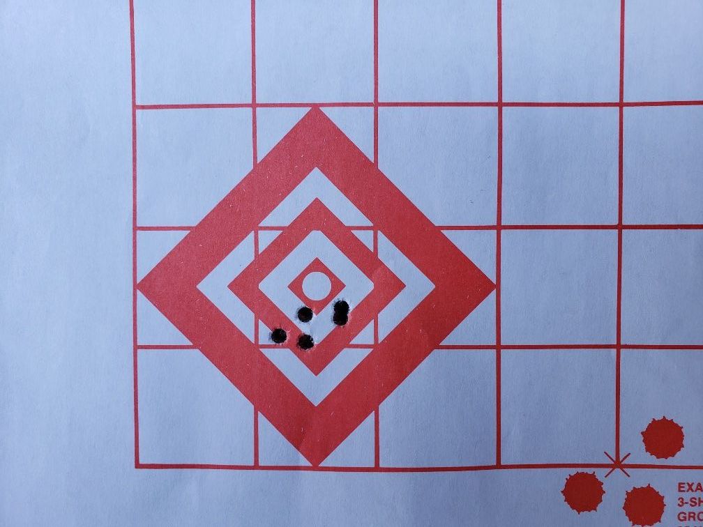

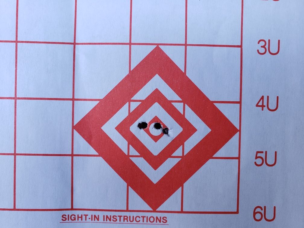

I've dabbled with various slugs out of "springers" for a while now. However, I've never been able to group any slugs better than pellets in these powerplants. Have any of you tried the ZAN 10g slugs out your spring piston or gas springs rifles?
Here are two, five shot groups using a RX-1 with a Beeman 66rl scope at 20 yards. I haven't had anymore time to group the gun further. I'm still a little stunned on accuracy. Of course the gun is zeroed with Kodiaks, so the POI is different for the ZANs.
The last time I cronied this gun was right after a schrader valve replacement shooting kodiaks around 1000 FPS.
If I get these kinds of groups at 30 yards I'm re-zeroing the gun with the ZANs.
I talked to a local merchant who sells airguns, and he said he shoots these 10gr ZANs out of his .177 Beeman R-1. That's what I will try after the RX attempt. Actually, I have a good number of low power PCPs that might shoot them too, so I have a lot of testing ahead of me. I did find out the 10gr JSB knock outs peformed better in my .177 Daystate Huntsman Classic than the original .177 12.5gr NSA I sighted in with.

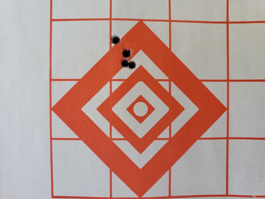

Couldn't help myself to see if I could group the Daystate Huntsman Classic .177 (Yes, I know a PCP, but a 16FPE one) with the ZANs better than JSB Knockouts (10g too) @ 30 yards. Looks like I have a new slug, and no re-sighting in necessary. Went from NSA 12.5gr & JSB KnockOut (Both minute of Squirrel) 10g to ZAN. Wonder how the H&N 10gr. slugs will group when available.
JSB KnockOuts:
ZAN:
