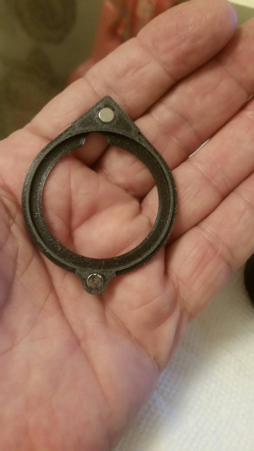

Yea last night I went back to the Zan website and ordered one of the CARM magazine for these 40gr slugs. I put some of these 40gr slugs in one of my magazines and the magazine binds up and won't advance. These slugs are just a silly millimeter too long so it was either order one of these CARM magazines or get out my belt sander and take a little off the slugs... the new mag idea won out thankfully! :)

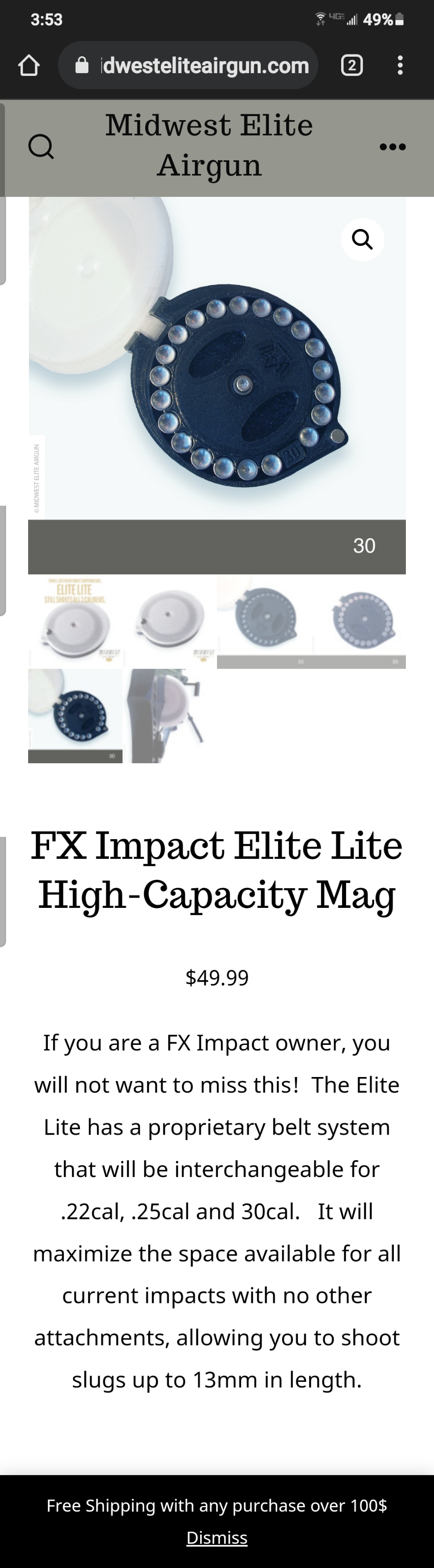

This might be another option for a magazine to shoot those 40 grain slugs.
They say you can shoot a slug up to 13mm long.
I kinda like the hinged lid !
https://midwesteliteairgun.com/product/fx-impact-elite-lite-high-capacity-mag/

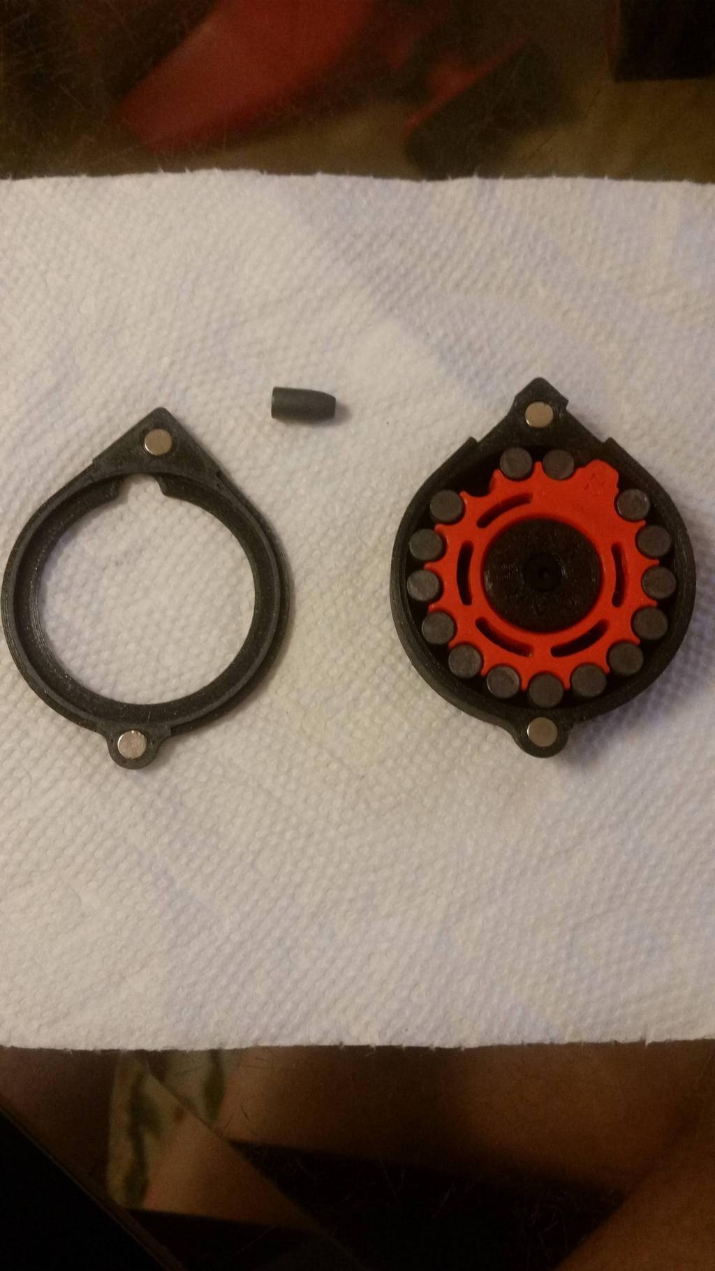

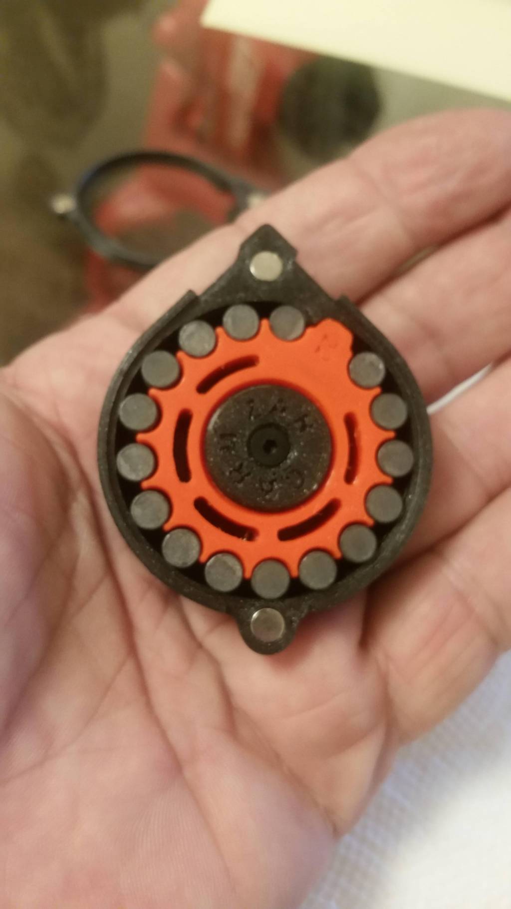

Okay guys, I just loaded my new CARM .22 mag designed for these 40 grainers...it holds 16 shots and it cycles these 40's flawlessly! I highly recommend it!

...ooops I forgot the pictures!
