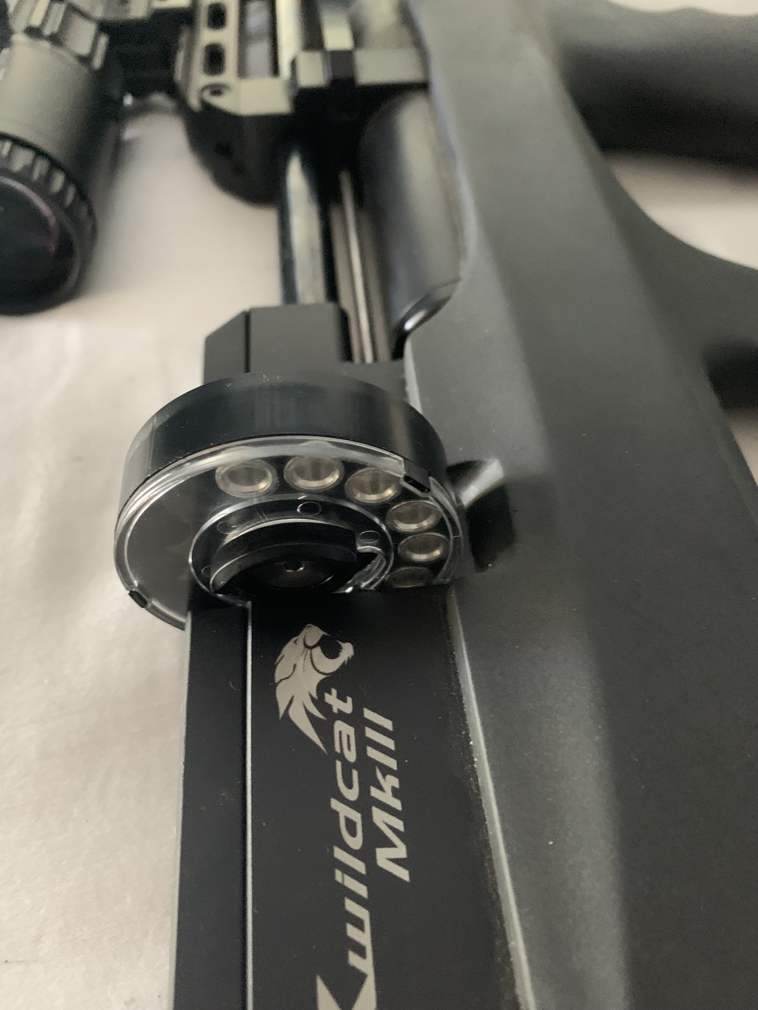

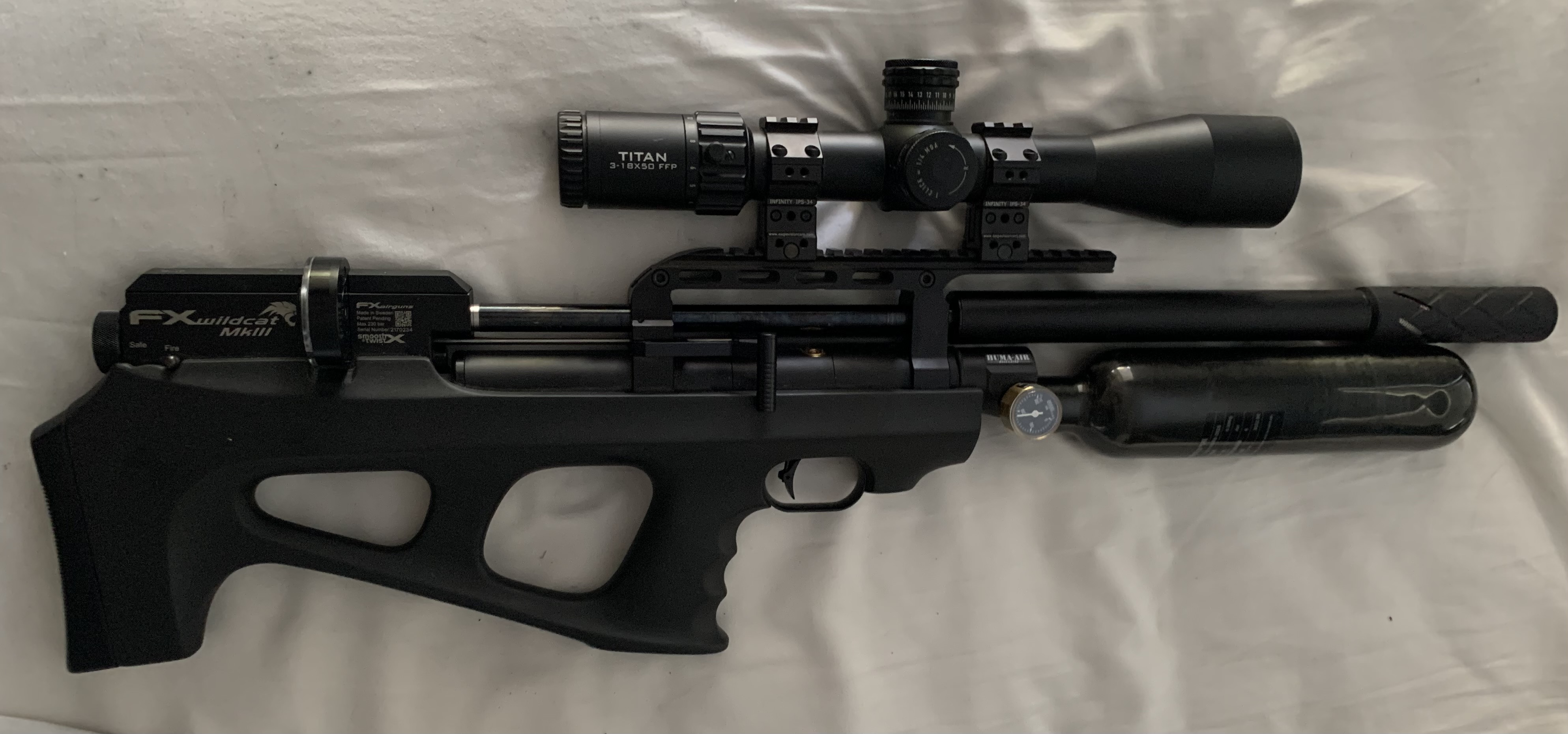

Having paid a princely sum for these Zan .30, I decided to give them a shot in my Wildcat BT, so I popped on the .30 shorty barrel last night (500mm - standard STX liner). At 120bar, they hit the knee at 875fps and were shooting very well. I then dropped the reg to shoot them at 835, because I don’t need that much juice and would appreciate having a compact and quiet .30. Considering that it’s putting out 58fpe, this is indeed a very quiet, stealthy rig, with only a small 0dB mod.

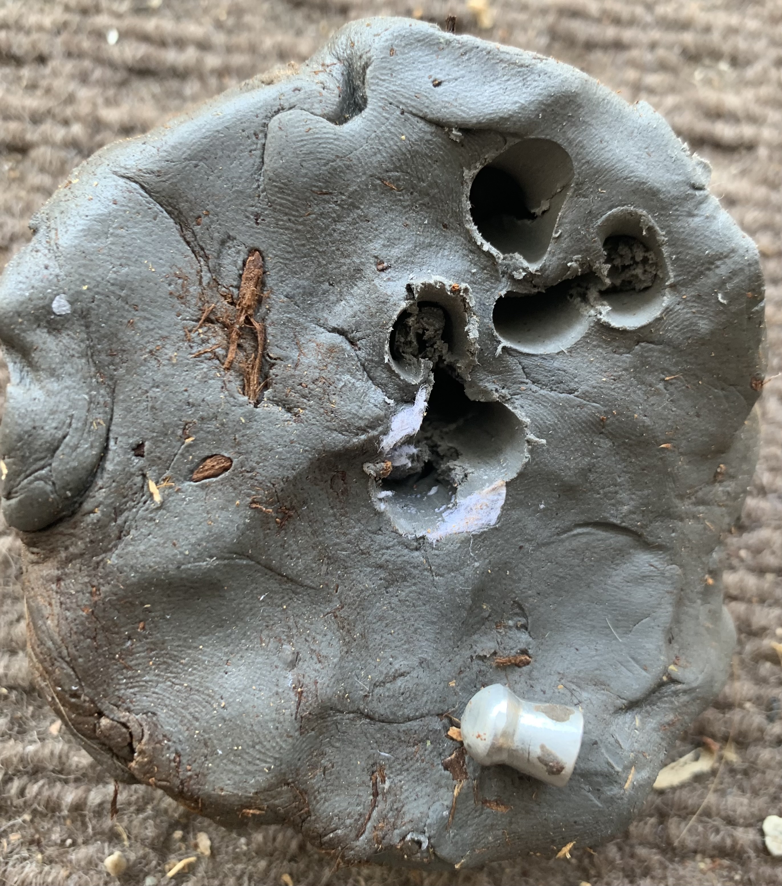

Unlike with the Sidewinder, these lead free Zans are shooting just as well, if not better, than the JSBs out of this wildcat. Here’s 8 shots at 50 yards:
So, if you have the right use case for these, they are certainly worth trying.

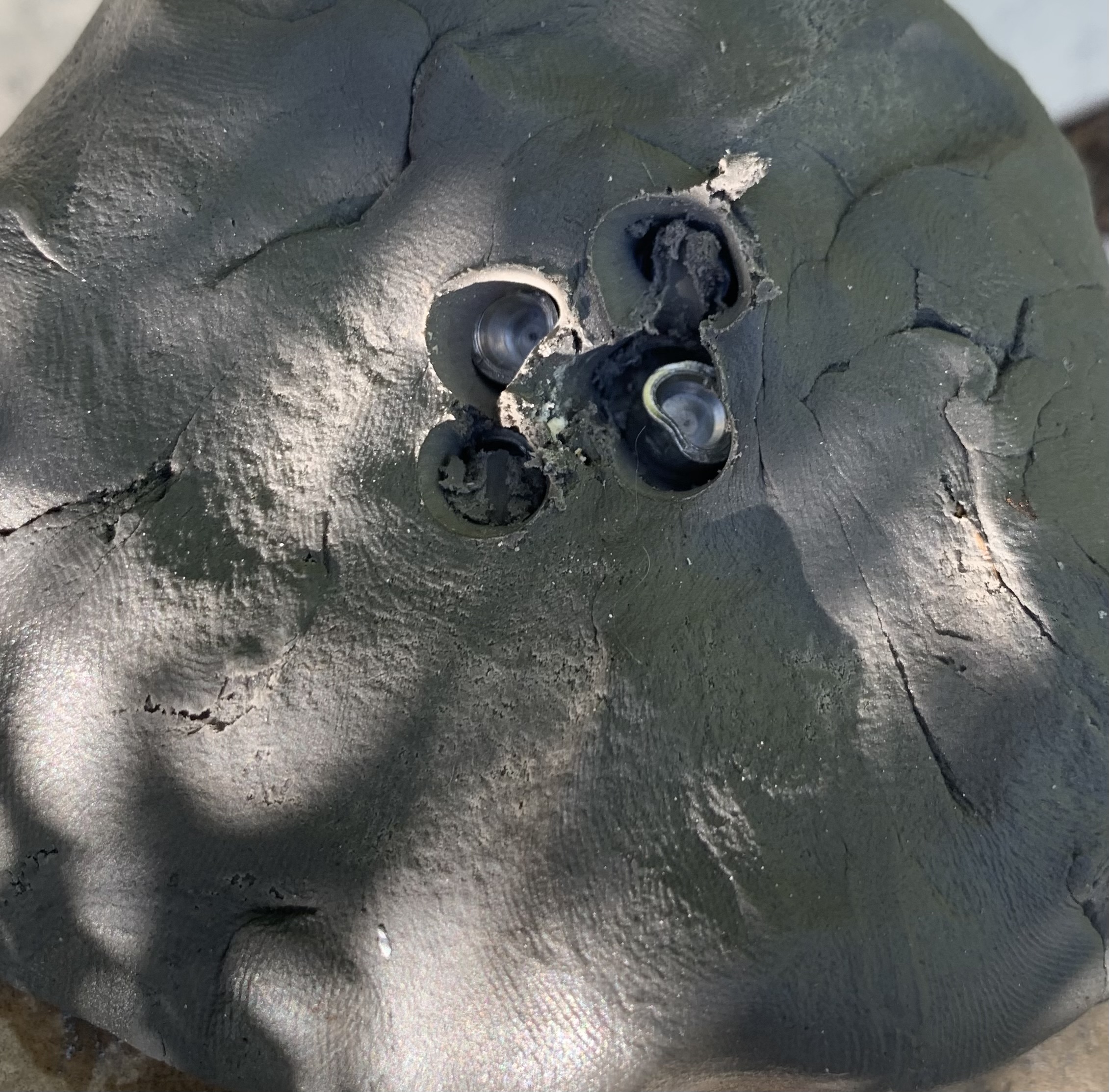

Retuned to shoot at 900fps to test at 80yards. A friend predicted that they would “fall apart” after 50. Not so. 6 shots at 80y at 900fps:
The pellet shown was recovered from the tree that the duct seal was stuck on. It is relatively unscathed. Don’t expect any expansion, but they will blow a neat hole through a 1/2in thick piece of ceramic tile. Perfect for pests with body armor.
Now going back to the 835fps tune. It’s won a place in my “active duty” line up as the nightvision-equipped rig.
