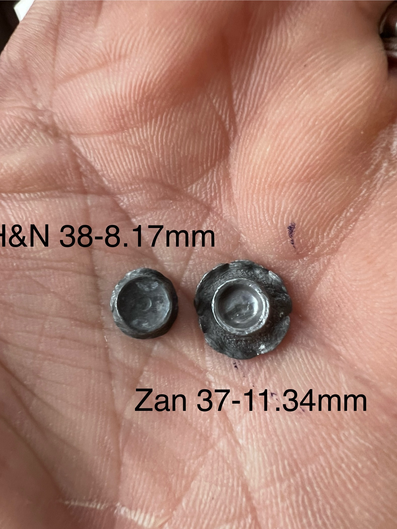

Finally this morning I had the opportunity to confront the Zan and H&N on a 15% calibrated gell block. Sending them from 150/200 m and also from 141 m on steel . Conclusion: The Zans reveal them self after 100 m where the H&N, having harder lead, struggled to expand properly as the Zan did with a complete and proper expansion. The zan also outperformed the H&N also on steel from 141 m.
I am not saying the H&N‘s are bad, at least in my barrel don’t work as good as the Zans in therm of bare accuracy. What can I say the expansion is much better more suited for long range hunting.
This is the first try at 50 m, not risolutive at all to determine which is the winner but interesting anyway

I shot the new ones, recovered these two rounds from a 15% calibrated gell block.
Distance was 200 m, both at 977 fps., I had the same result at 150 m as well
As you can see the H&N barely expanded, touché…in some way: I can not say your lead is harder because I do not make the formula my self, what I can say you have to keep working on the TSLOT HOLLOW POINT DESIGN to make them competitive in therm of expansion with other BRAND like Zan in this case.
