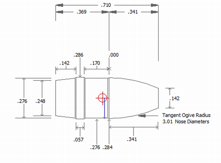

Altaros must be doing something right, since their Altaros ATP Smooth .25 caliber 49.5 grain slugs have a measured BC of 0.21 G1 and 0.110 G7 at 890 fps. This is almost twice the BC of other .25 caliber "standard" slugs.

The two BC values above don't actually give the same Cd value so one of them is not accurate, probably the G1 value, as to use G1 for a bullet of this shape is ridiculous. The two values of Cd are 0.137 from the G1 BC and 0.128 from the G7 value. For comparison, the lightweight .22 14.5 grain slug in my avatar had a measured best Cd of .132, I was never interested in BCs at that time when we fired them in1990, and I know the boat tail on that was not correct.Altaros must be doing something right, since their Altaros ATP Smooth .25 caliber 49.5 grain slugs have a measured BC of 0.21 G1 and 0.110 G7 at 890 fps. This is almost twice the BC of other .25 caliber "standard" slugs.
Thanks. I use the 0.110 G7 BC at 888 fps and my trajectory validation is spot on from 20 to 300 yards. Altaros advertises 0.21 G1 BC on their slug packages but via e-mail recommend using the G7 profile.The two BC values above don't actually give the same Cd value so one of them is not accurate, probably the G1 value, as to use G1 for a bullet of this shape is ridiculous. The two values of Cd are 0.137 from the G1 BC and 0.128 from the G7 value. For comparison, the lightweight .22 14.5 grain slug in my avatar had a measured best Cd of .132, I was never interested in BCs at that time when we fired them in1990, and I know the boat tail on that was not correct.
So yes the Altaros does well, but it could possibly do slightly better with a smaller boat tail.
They fly so well I wouldn’t mess with them. If something works, and works as good or better than anything else on the market, my instinct is to leave it alone.I'd be interested to see how your trajectory works out with the SLG1 profile from Mero. Mero will do a basic BC conversion for you when you switch profiles.
Also curious how the Altaros might fly if you had the equipment to shave off, say, 30% of the boattail, and bring it back to a recommended size. I have not gone into my stock to measure anything, but memory suggests the angle is probably OK.
