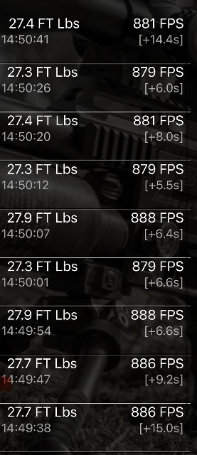

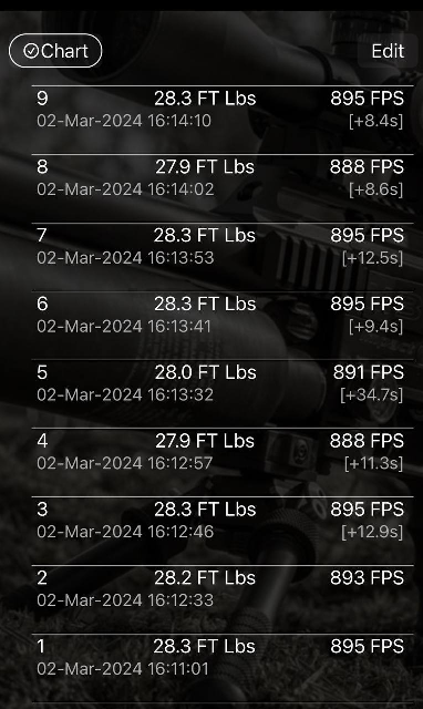

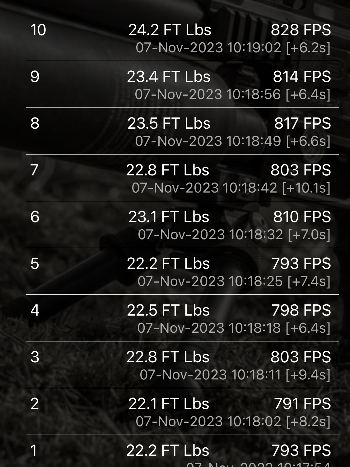

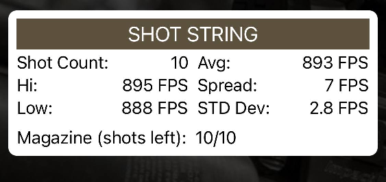

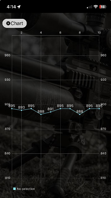

.22 S model 550 if memory serves . Both have creep up as you fire, doesn't really affect accuracy but it's annoying. I had one, did it sent it in to Top Gun to be fixed, a year later they broke it and sent me a new one, did the same thing, creeps up, you stop, to reload, it resents then repeats.
If I knew how to get at the reg and IF I had a tester for the reg, I'd look at it. It's not really a big deal, not actually effecting accuracy. I you look me up way back when, you'll see the mods I've done to make the HSA externally adjustable.

My speed is creeping up
too. I contacted Huma but they don’t have a huma regulator for it.

It's a feature apparently, actually doesn't hurt anything but for the OCD among us it's an annoyance. I too contacted Huma a year ago as well as, I believe Lane but no joy.

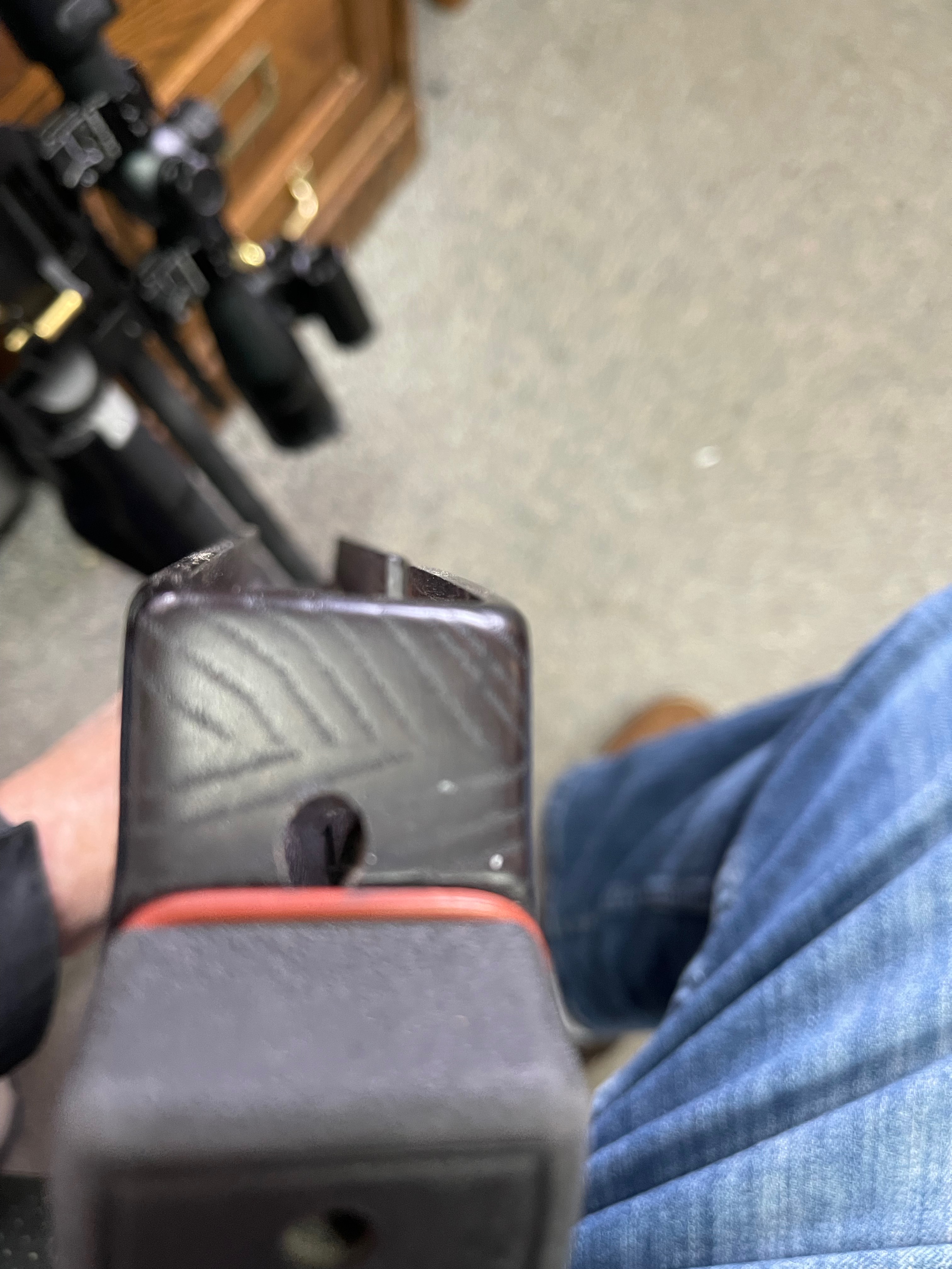

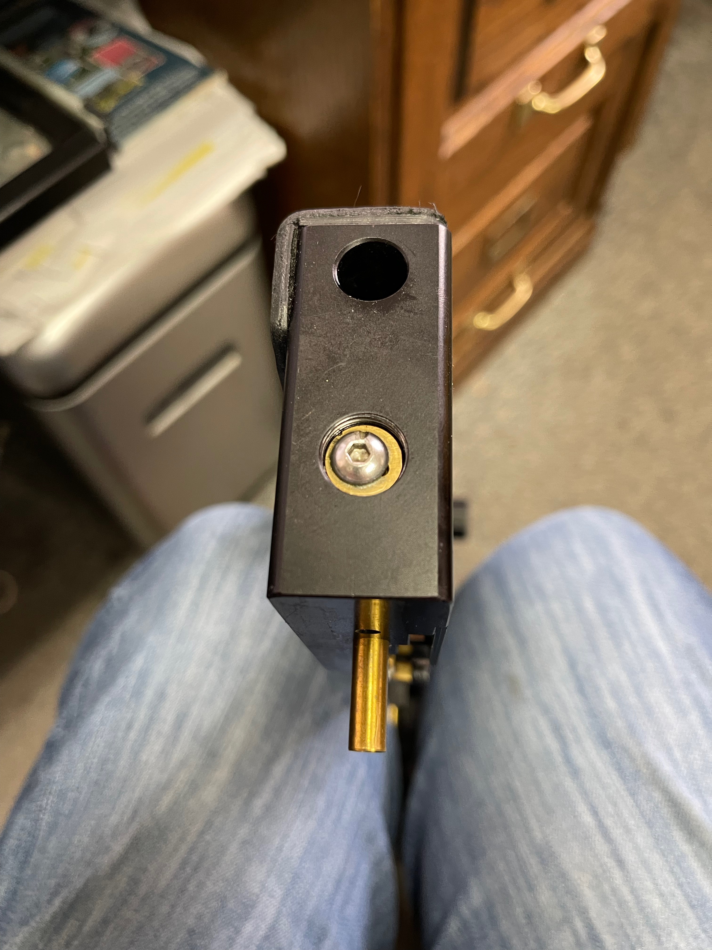

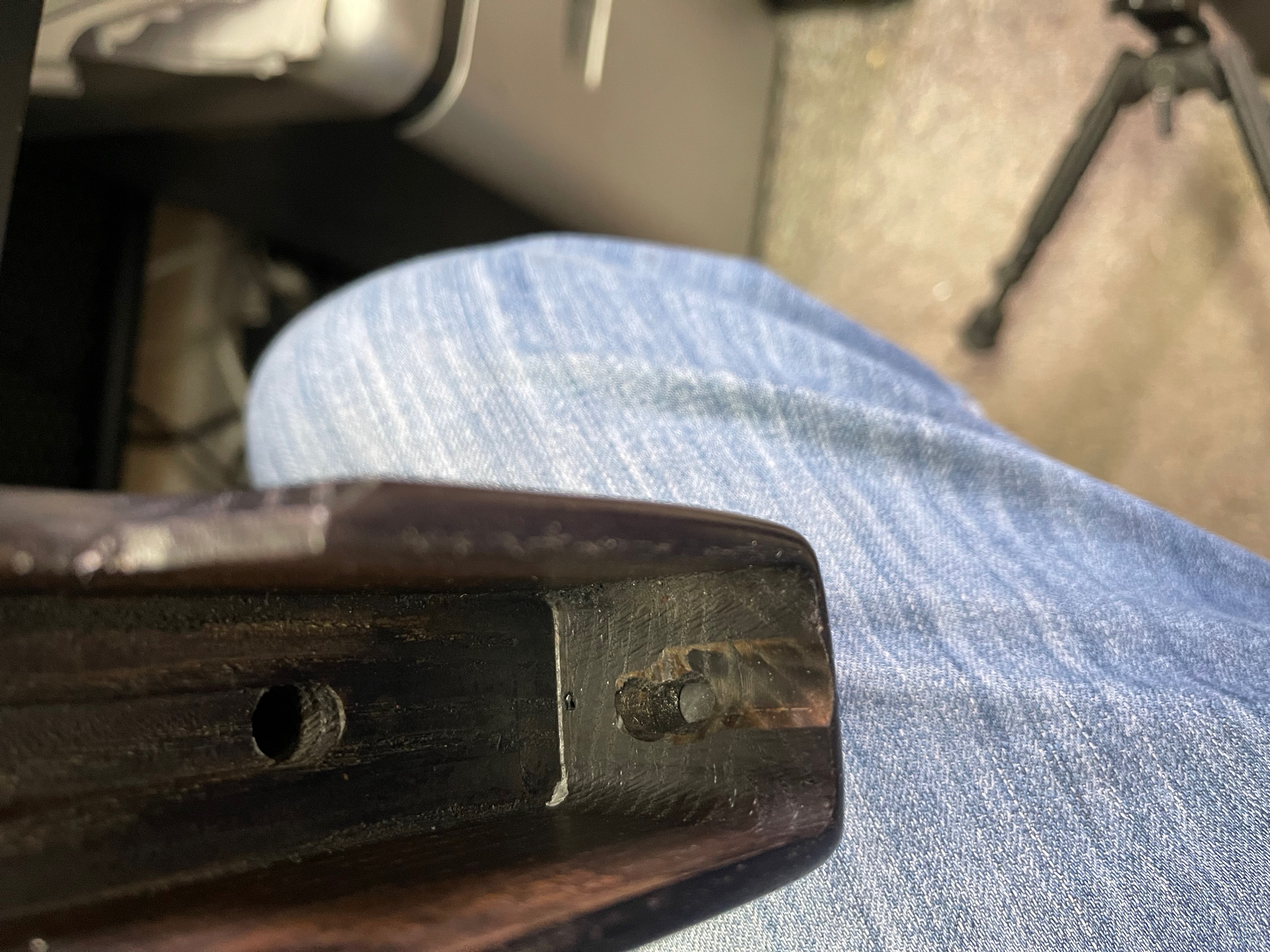

I drilled a hole in my stock to access the HSA, i drilled and tapped the HSA and put in a hex, have to be careful of that, it's thin but it works, I really fine thread, loctite, I'd have silver soldered it on but...don't have the right stuff any more, or machine up a whole new adjuster out of a set screw. I used a nylon tipped screw on the side to help it to move but not slip.
Mine just climbs and resets, nothing loose. Just a flaky gun or operator, who know.
Can you show some pictures what you do to it?
I'm pretty sure there is a thread with the pics.. but I tried to find my pictures and no success, IF I remember I'll pop off the stock and take some pics. if you aren't feeling lucky, I'd be careful. messing with the adjuster like I did. I'll take some pics when I get a chance.
