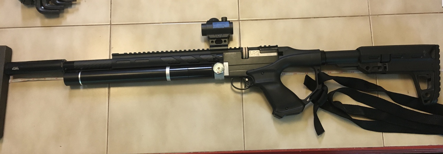

That is an FX slug liner inside the C88machining 380mm barrel kit, plus the plenum and extension as already mentioned. Firewalker cut and crowned a 500mm liner down to 380mm and put my kit together for a reasonable price.Love the pic... that's exactly what I had in mind. I'll look up that c88 kit. I like what you did with the barrel. Is there info on that somewhere I can read up on. Also thanks for the info thus far.![]()
