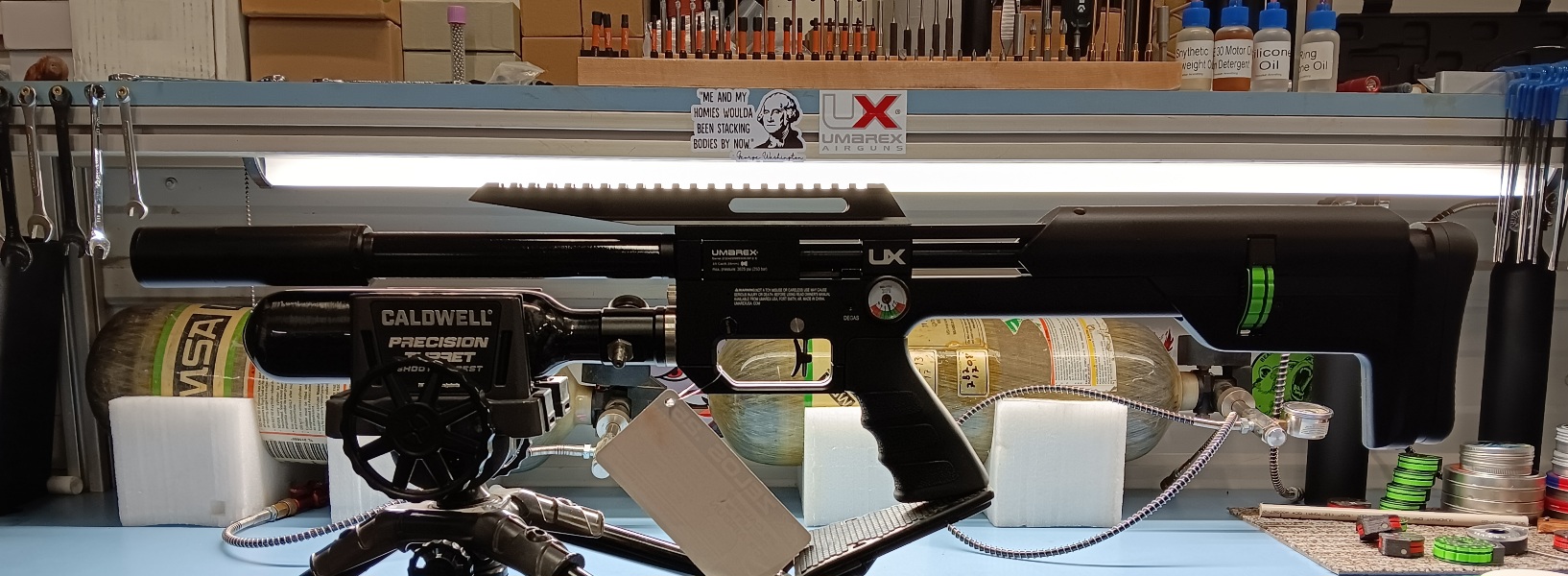

The Umarex Zelos is a an affordable pcp air gun in its own right but it's really long!
How about a Zelos Compact that's only 27-1/2 inches long not counting the moderator.
Better?
A 475mm barrel gives you the best compromise for length vs brush clearing.
I was going to buy a .30 and shorten it when they upgraded how you fill the gun. I’m glad I waited because I got to see the numbers the .30 full size produces. Those numbers aren’t asking for a shorter barrel. What kind of numbers are you getting with the shorter .25? Ascetically, your gun is perfect. Good job.

Thanks man!
I have not done the workup on it yet, it is set at 2100psi on the reg, I'm guessing mid 800's on 25gr pellets. Ill check both ends of the reg to see what it offers and then open it up and try 36gr slugs.

Is it like a lot of bottle guns and has no plenum space? Unless there is one hidden between the grip and the mag, I don’t know about 36gr slugs. No matter how far you turn up the reg and open ports up.
Yes, it has a tube plenum under the barrel from the reg back to the TP.
Um, I have the M60, it has a shorter barrel than the Zelos and it shot the NSA 36gr slugs at 880 fps at 2100 psi. I'm guessing 800 with the compact.

The 357 barely hits 650 fps in stock form, so whatever they did to get almost 200 fps more is a bit curious. Weight difference has a lot to do with it too. Slap a standard 80 grain pellets back in there and you're down into mid 700s again.

I love the George Washington sticker in the background
