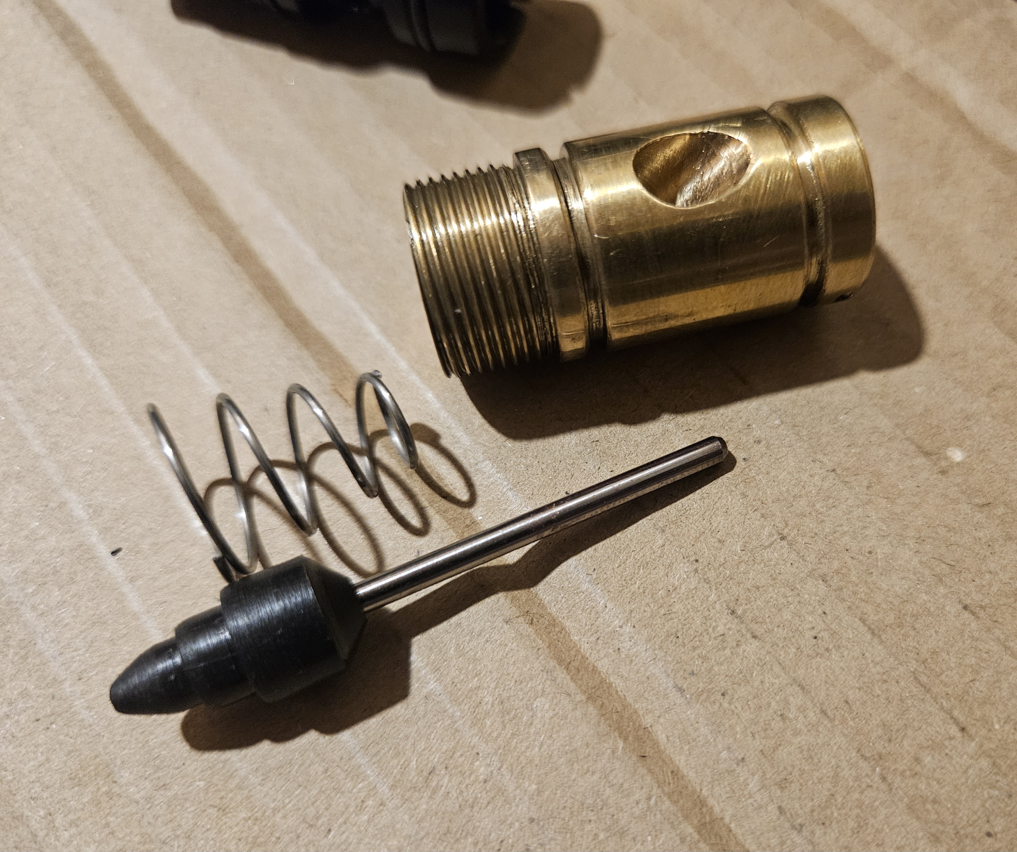

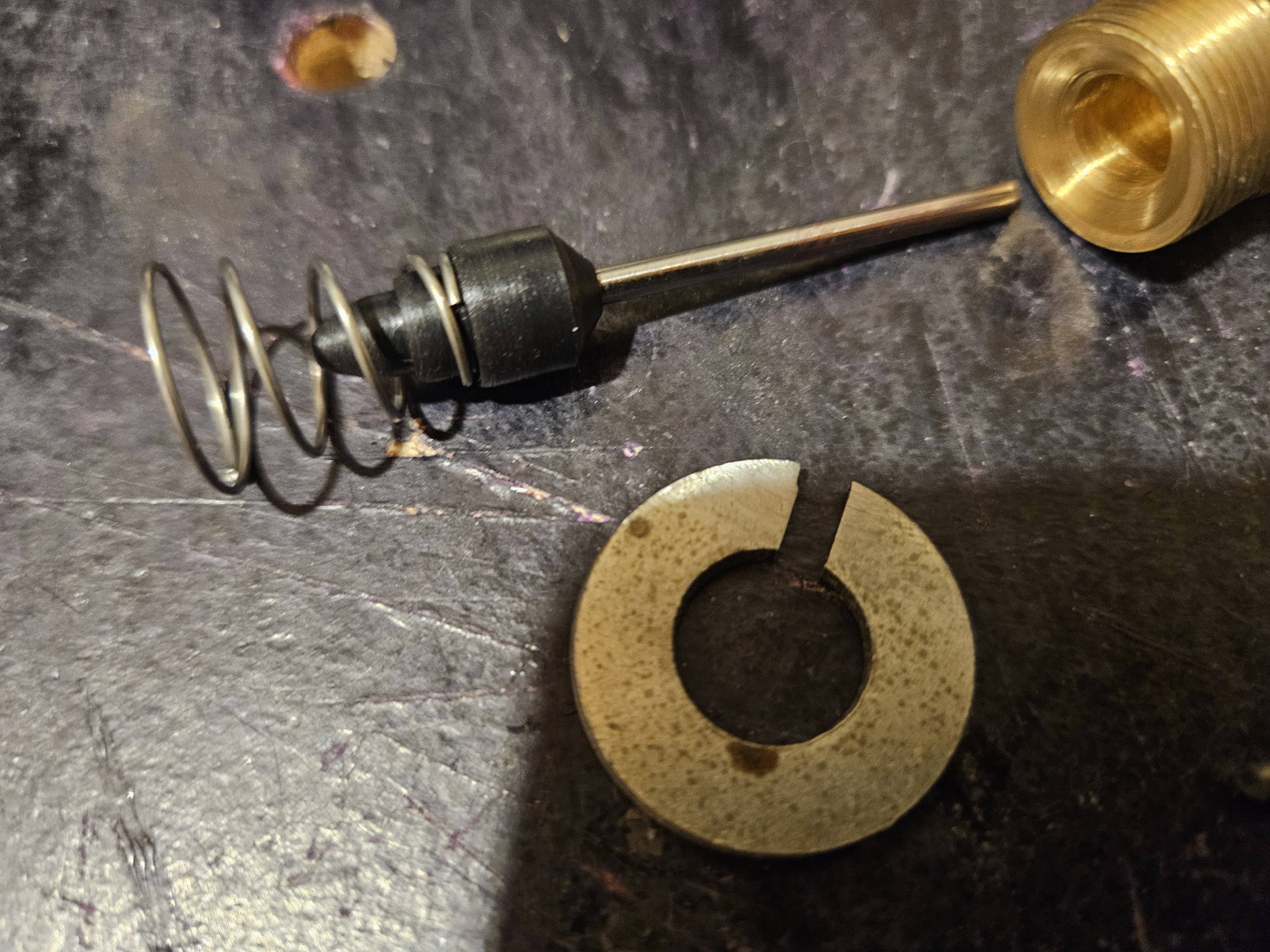

Factory Valve
Has a heavy spring, a a smaller poppet, a big spring seat, and smaller throat. It's also a 4 port design that had a chamber they vent into and up into the transfer shaft.

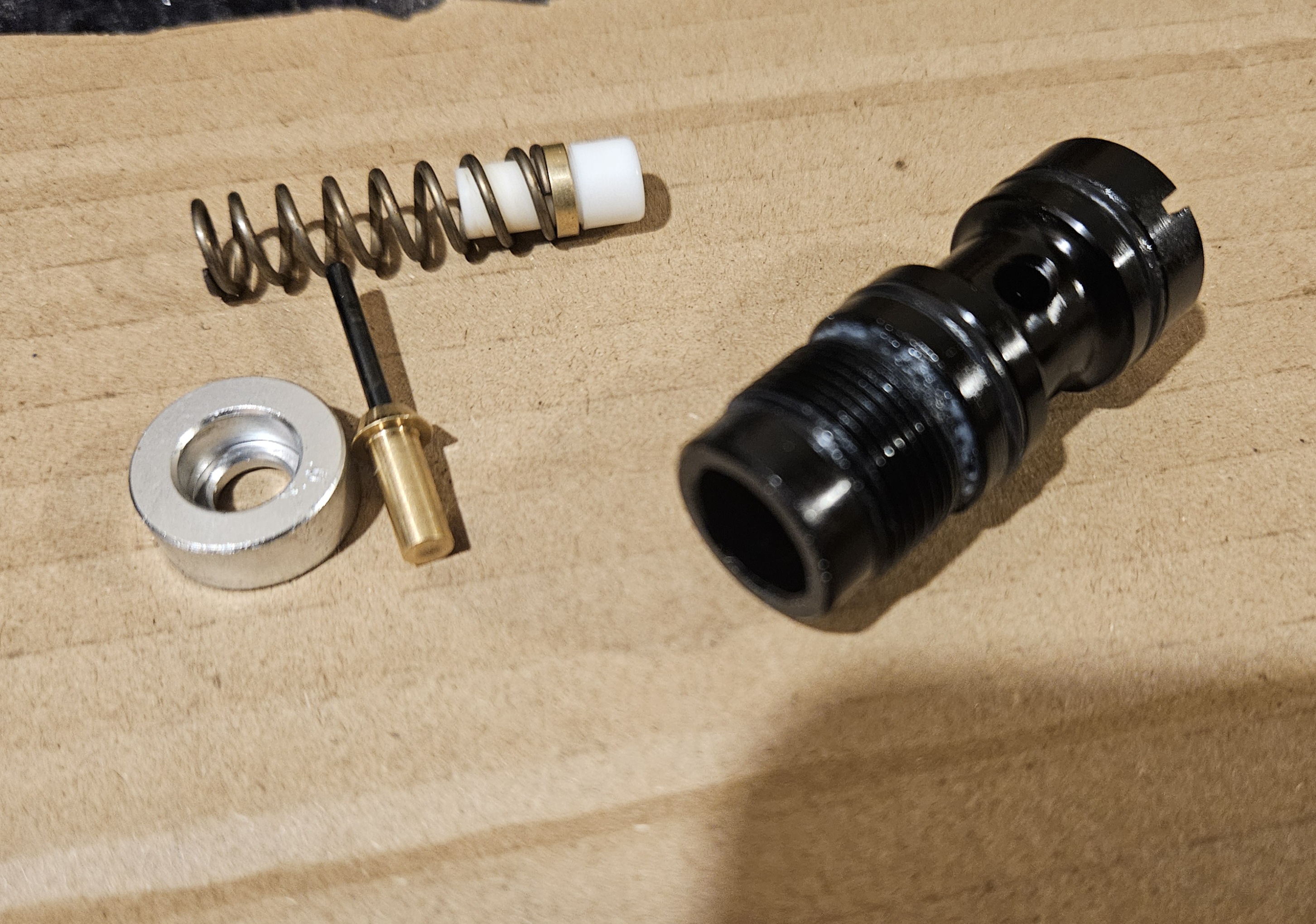

New Valve
Removes the spring seat for more volume, bigger throat and stem, the poppet seats right at the face. That, and the conical spring that rides on the edge of the plenum, it basically makes the plenum the valve body. It's a direct open flow now vs funneling thru the spring, seat, and small poppet. The exhaust port is also angled and enlarged, and lines directly up to the transfer shaft right into the barrel.
TLDR: IT FLOWS MORE AIR!
Factory Valve
New Valve
View attachment 510172View attachment 510173
The stock valve looks exactly like the Notos valve as does the spring.
I cant get a scale for them in different pictures.

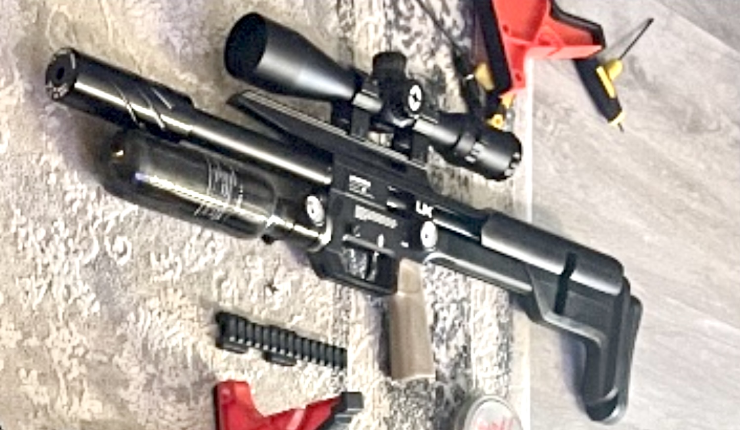

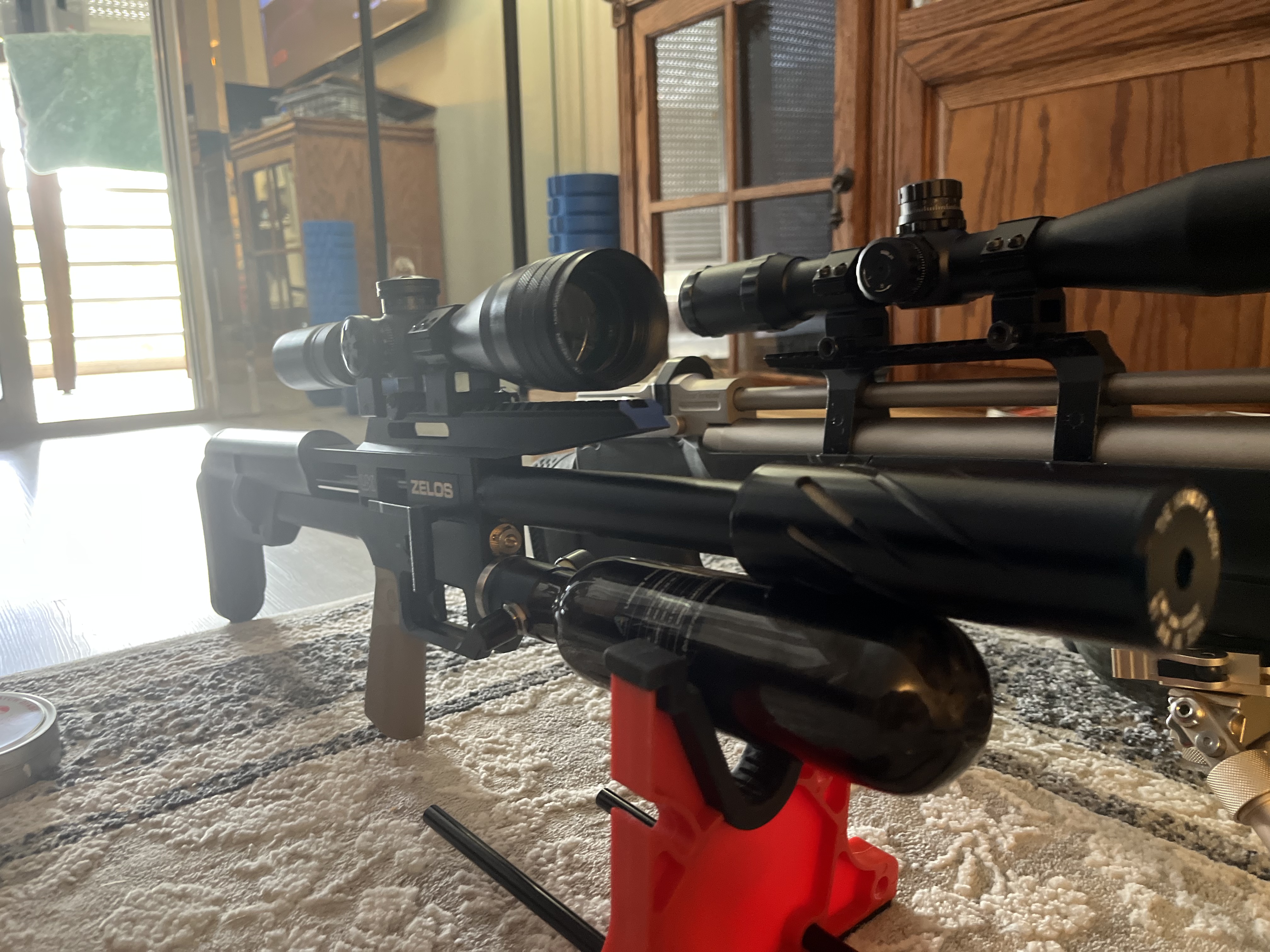

I ordered and recieved one of the Zelos compact in .22
I call it the Zelcom, a (FWA) Firewalker Airsmithing custom airgun.
Just set it up and shoots great. Waiting on its final scope and I’ll take some pics ,groups and comment more on how much I like it

I also received a .22 Zelos compact from Firewalker recently, with the smaller bottle and shortened barrel. His work is professional and I would not hesitate to buy from him again.
That looks great! My issue with the Zelos is the length of pull. I have to use a reversed cantilever scope mount on mine. I wonder if Firewalker can cut down those additional picatinny slots to even further reduce weight especially if you don't use them...

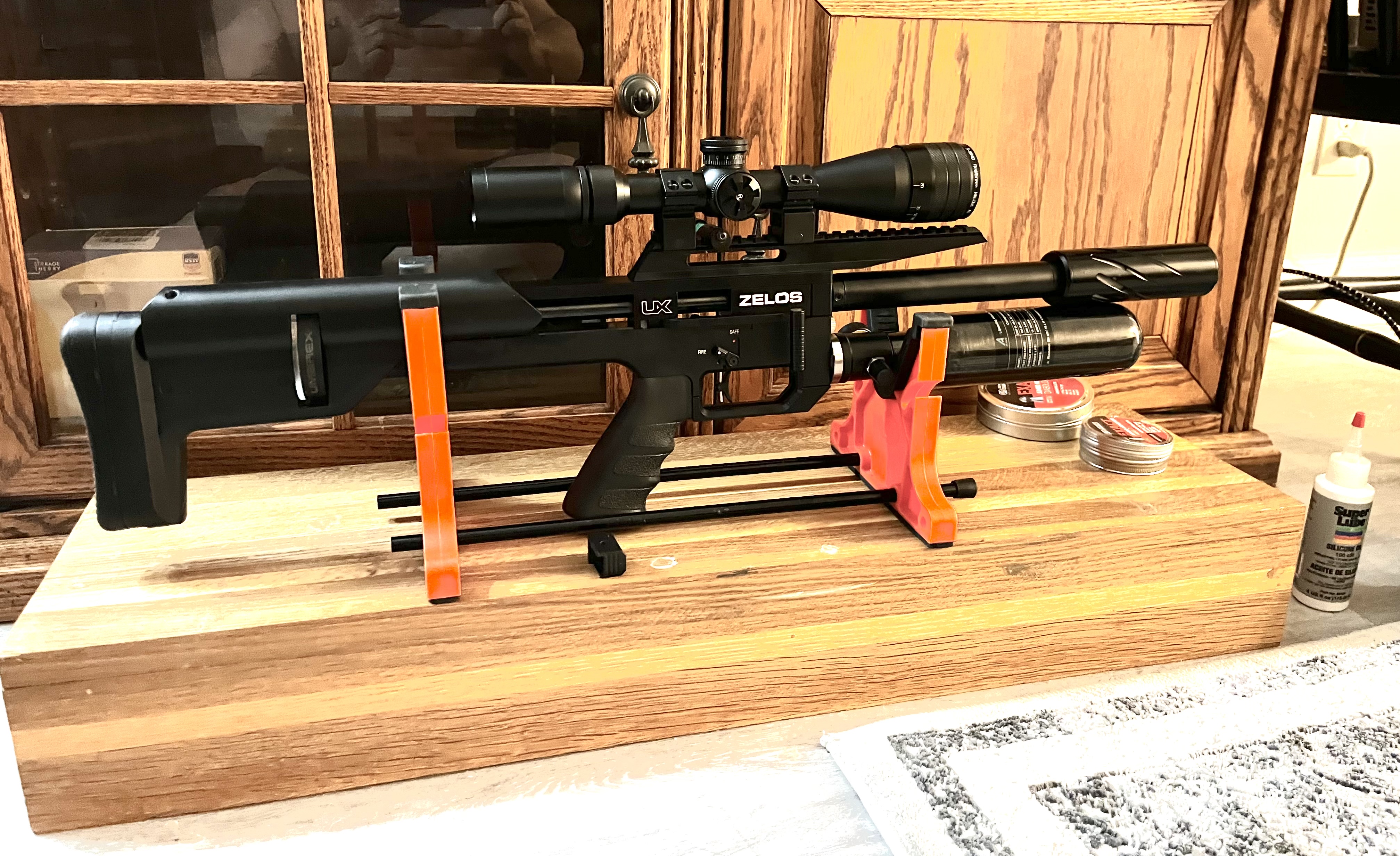

What a pleasure to shoot
I’m getting 930ish fps with 18.13 JSBs.
FWA tuned it and adjusted trigger so there is zero first stage slack.
Excellent groupings Slight Clover leaf at 20y with no bipod or rear rest. Just a front stand
New Grips and a lower pic rail are in route
Looks great! What size barrel is that?
