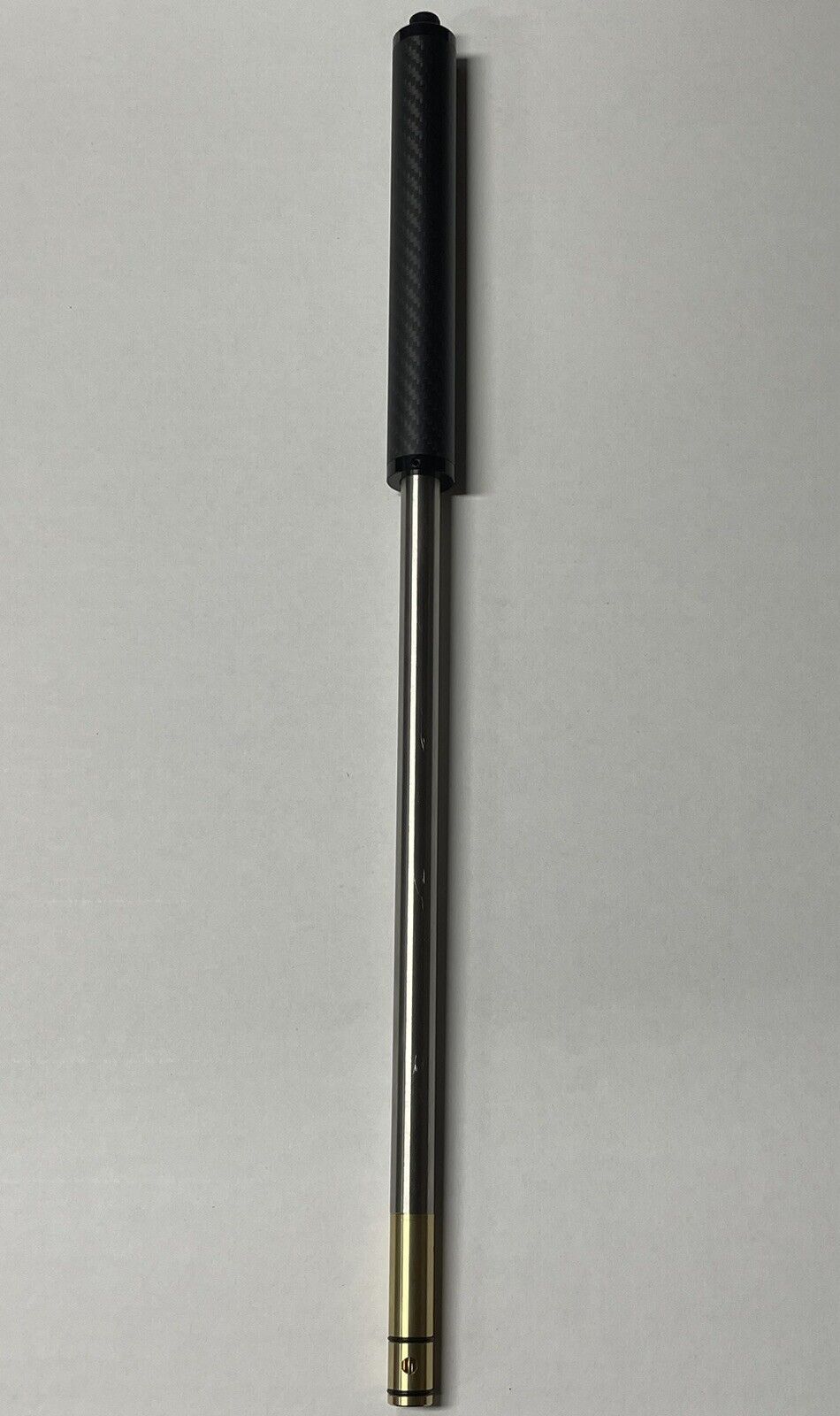

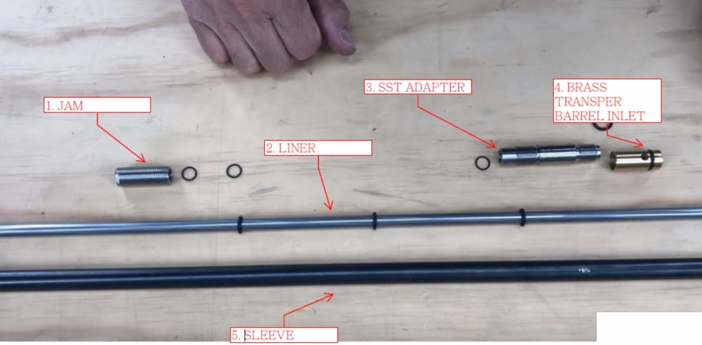

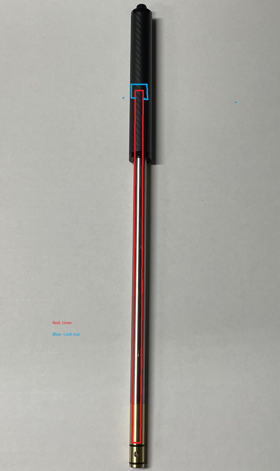

fx barrel liner is a system where interchangeable barrels have a thin "liner" which is the rifled bore which fit inside an exterior housing or "barrel". It offers a system where you can swap out twist rates in a pinch. 1:24-1:18-1:16... @ $109 per liner. You'd buy the liner housing or "barrel" and liner lock/TP-liner receiver, outer housing which would be the Outer diameter of the stock Zelos barrel and fit in its place.. and muzzle plug/liner lock nut which is the housing/receiver of the muzzle end of the liner. I don't know that it would be necessary unless you want a Longer or shorter barrel. the stock zelos barrel is Extremely accurate in my experience, and most who i've spoken with. You're going to spend about $250 on the FX conversion kit and and the liner you want to use. Top pic explains the Liner barrel system, bottom is the Zelos Kit.
As far as how... it's just a barrel swap.

Thanks so much. For me it was to learn , and yes my Zelos barrel is so excellent.
